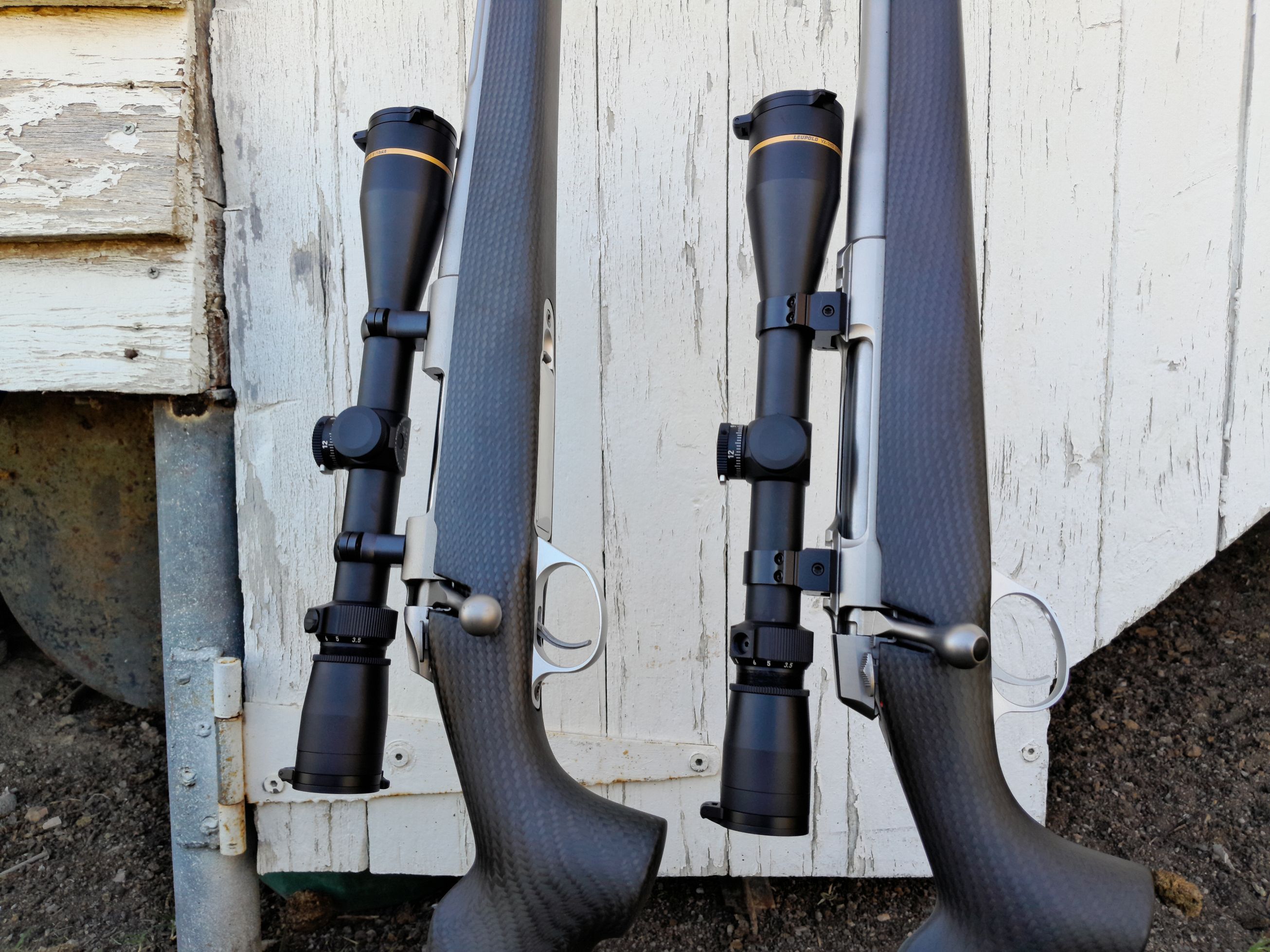

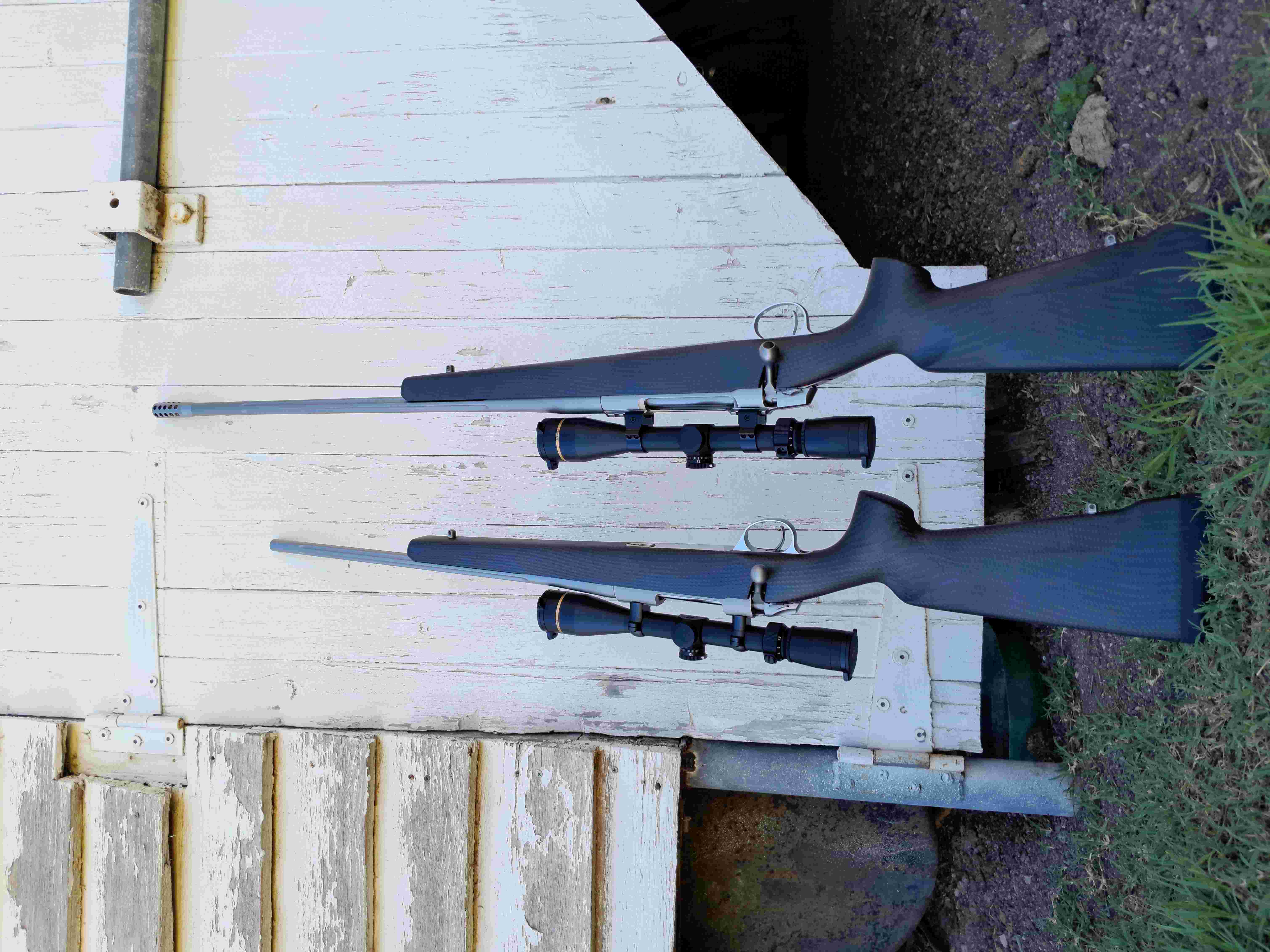

Mate a bit of a pictorial view of the VX3HD scopes on two slim light rifles here. It's easy to talk but harder to get a minds picture.
Honestly, for what these rifles cost and their performance, many would say, but a European scope, say a Swaro Z3i.
But I will gain nothing. And a 30mm tube scope means more weight, strange thing to do IMHO when the rifle is so deliberately lightweight.
AND I deliberately use the type of rings that mount directly to the rifle, no high clubby pic-rail, and one less screwed-on interface to keep secure, and also I can get the scope as low as I can.
The machined-in pic-rail on the .300 here means I can't do anything about that, but again, no easily-knocked off zero aluminium crap. The 308 on the left has the tapered clamp-on reciever, and the excellent Leupold "Ringmounts" are steel.
The difference between steel and aluminium is bigtime on strength, but the difference in weight is undetectable.
The other benefit is being able to use the excellent aluminium Leupold flip-up lense caps. Unlike the European bulky versions, or the cheap plastic clubby Chinese-made things in the gunshops, these covers are not in any way visible when looking through the scope.
I find when hunting or even on buggy rifles that cop a beating or are always in dust, these things mean rain and dust never ever needs cleaning off lenses.
Hope this helps you get a picture in your mind about what these scopes might look like on your build.
