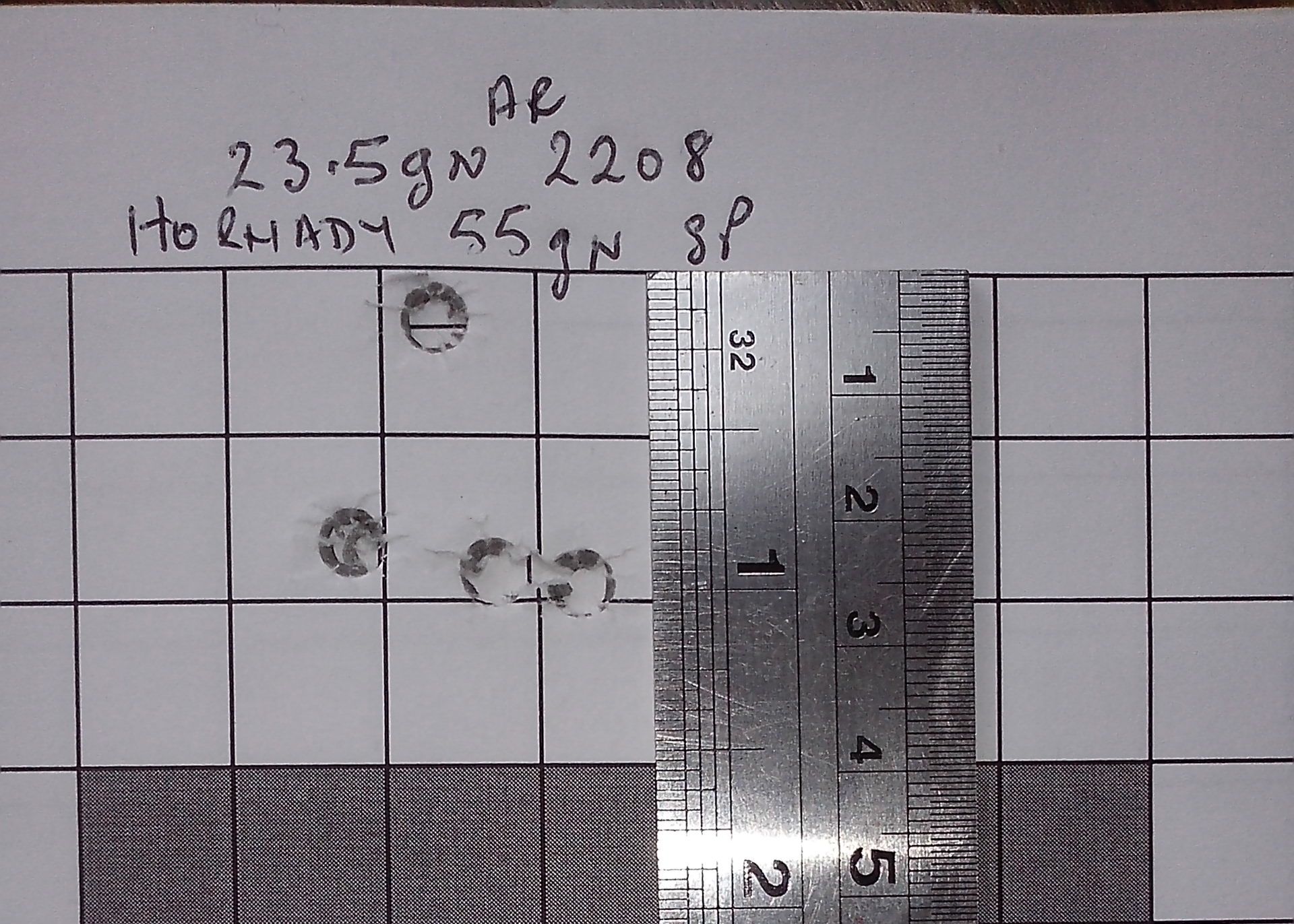

Post by Oldbloke » 04 Nov 2014, 2:48 pm
I Finally got out to try a few test hand loads in my 223 last weekend. Lee dies have been fine. I tried 55g Hornady SP with AR2208 ( worth a try as I also use it for my 3006) from 23 to 26 grains in .5 grain increments to start off.
The best load was 23.5 g achieving just under an inch (see pic) at 100 yards ( read long paces) off a plastic picnic table. Although this should be fine for foxes I will next try .2 of a grain above and below when I get a chance. I have since sized and cleaned the cases and found that there is a lot of variation in weight. Half weigh about 102 grains and the other half weight about 104 grains so I have sorted them, should help. That's what happens when you buy cheap ammo I spose.

Post by Warrigul » 04 Nov 2014, 3:14 pm
Oldbloke wrote:I Finally got out to try a few test hand loads in my 223 last weekend. Lee dies have been fine. I tried 55g Hornady SP with AR2208 ( worth a try as I also use it for my 3006) from 23 to 26 grains in .5 grain increments to start off.
A good result, many use AR2208 for .223, one of the most versatile powders out there INMHO.
