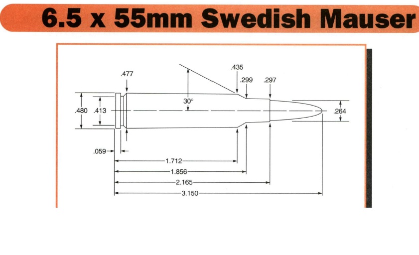

Today I read that American branded brass was actually slightly undersized in the 6.5x55 whereas european brands of brass are a bit larger the same size infact as original issued military rounds. I not sure with part of the cartridge this relates to, I will endeavour to find out, but I believe it might be the rim!

I think you will find the biggest difference is the Case Rim Diameter and the smaller dimension cases could be a problem with excessive clearance and extractor claw.
Don't own one, have not played but from memory the difference is something like 0.473" Remington (USA Cases) and 0.480" Lapua (European Cases).
Not sure on the Case Head dimensions and I think the overall case body is the same but would fireform okay, you can't fireform the case head if it's smaller.

Apollo wrote:I think you will find the biggest difference is the Case Rim Diameter and the smaller dimension cases could be a problem with excessive clearance and extractor claw.
That is the point I was getting at if the case head is undersized, there isn't a thing that can be done about it!

Post by Westy » 24 Jul 2014, 3:37 pm
Yep Apollo is almost on the money ,
The Remington case is 2.153.5" in length and.472" Dia with the rim .473" Dia this was taken on a average of 10 cases. All were the same except 2 which were a little smaller .001''
The Lapua cases were all exactly the same 10 outa 10 perfect size 2.158.5" in length Case and rim .477" in Dia

Westy wrote:Yep Apollo is almost on the money ,
From Lyman. The 'rim' at the head should be .480"
From Lyman
"Shooters loading for the Swede should not under any circumstance attempt to form brass from 30-06 cases. Case diameter of the 30-06 runs .008" to .010" smaller"
Well that isn't much different than Winchester and Remington Brass and a that formed from 30-06 then!
