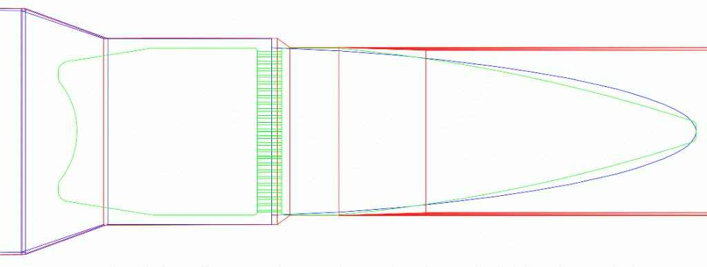

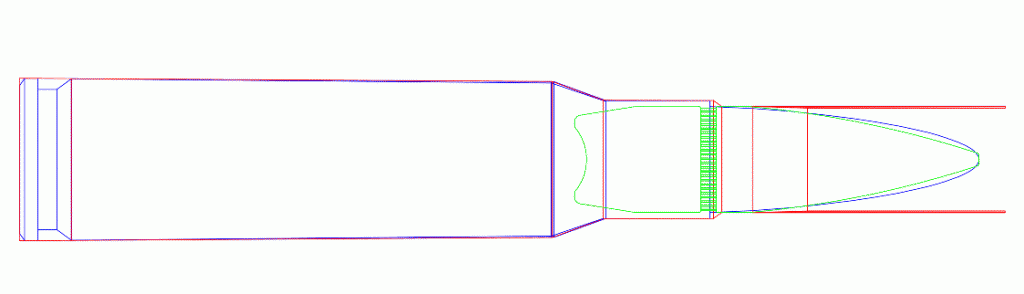

Now, dont say I dont do anything for you noobs....If you look at the ol trusty 308 winchester, based on the CIP chamber and cartridge with the addition of the NATO spec M80 ball round, 147 gr projectile, you get something looking like this;
Theres a lot of detail there, so have patience.... but the red is the chamber spec, the blue is the case spec and the green is the NATO spec..... blue has double lines in areas representing the min / max....while the thick red is the rifling.. more to come ;) .
1290

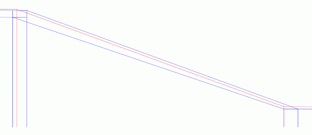

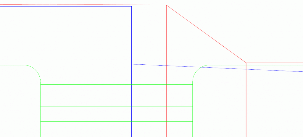

Thisis the cartridge max (blue) and Chamber Min (red). The double blue lines represent the tolerance in the cartridge.
Following, you can start to see the detail in the chamber (red) with the freebore zone and where the rifling starts... that bullet is the m80 fmj to scale while the blue bullet outline being the cip spec 'shape' to compare...
Now you might start to hurt your eyes.. but again red is chamber, blue is cartridge, green is the m80 bullet jammed in there...here you'll notice to the right the smallest diameter part of the chmber is the freebore with the bullet sitting in the 'air'...;
Here.... words added ;) you can start to understand lands, off the lands and what it means, what it doesnt mean too! This bullet (from c. 1960) was, at least according to my interpretation here, designed to sit 26 thou 'off the lands'; and note the bullet is underbore to the freebore.... ;)
1290
