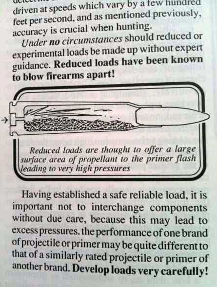

Post by Humir » 10 Sep 2014, 2:40 pm
Found this Googling for other stuff.
Thought it might be interesting for newbie reloaders or peeps working up reduced loads.
Thought I'd share, hope someone finds it useful.

I don't know if you are the same person that posted this on Shooting Australia, however it needs the same reply that users over there suggested - the crucial piece of information that the author has left out there is that this effect, sometimes refered to as the SEE (secondary explosive effect) occurs with slow powders.
The very fast pistol/shotgun powders and medium speed powders lie AR2205, AR2207, AR2206H can be safely reduced, as witnessed by factory data for reduced loads with these powders. This is from the ADI reloading handbook:

You have nailed it, I have loaded thousands of reduced load rounds and never had an issue, I stick to the faster powders.
Information is the key.

newsteadvic,
Nope. That's not me. Just offering the picture as I hadn't seen it before and hope it might be useful, interesting to some rather than just an written explanation.
Happy to have the extra info added here.

Post by Josh Smith » 13 Sep 2014, 12:02 pm
Hello,
Yep. The case should be around 70% full for safety.
If you use filler, add the weight of the filler to the weight of the projectile, also for safety.
Josh

Post by newsteadvic » 13 Sep 2014, 8:12 pm
Welcome Josh, interesting to have some overseas input.
However I again feel that this statement needs some context. yes, for slow powders ( which for Australian purposes I would consider AR2208 (varget for the cousins)) and slower powders to need at least 80% case fill.
However I feel quite confident about reducing fast powders, examples being Hodgdons rule for AR2206h (H4895 for the cousins) which states that you can reduce up to 60% of max jacketed loads without filler, for cast or jacketed projectiles. For cast projectiles and fast powders you could go even lower as per books like the Lyman Cast Handbook 3rd Ed and 4th.
I do not use filler for reduced loads so cannot talk to that point.

Yes, there are are too many 'rule of thumb' for these kinds of thing which without context are wrong if not potentially dangerous.
To OP or anyone developing a load, it always pays to find out the particulars for the powder you're actually using, not just general information.

newsteadvic wrote:Welcome Josh, interesting to have some overseas input.
I agree, needs context. A lot of pistol and other smaller cylindrical cases can be loaded lower than even 50%.
A 3.2 grain load of win231 in 357 mag is about 25% capacity.
I think the article is just outlining the danger of making up your own extremely reduced data, and probably pertains mostly to bottleneck and high powered cartridges. In pistol calibres the biggest danger for reduced loads is just squibs aka bullet stuck in barrel.

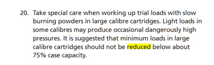

Post by Oldbloke » 25 Jun 2019, 6:49 pm
Ill just leave this here.
reduced loads .jpg (39.15 KiB) Viewed 5784 times
And this;
Reduced loads 60% max 2206H.JPG (72.59 KiB) Viewed 5784 times
Both out of the ADI manual.
If you are certain there was plenty of trail boss in the case Id suggest you should email ADI and give them the details of the load and what happened. They will want to know.
