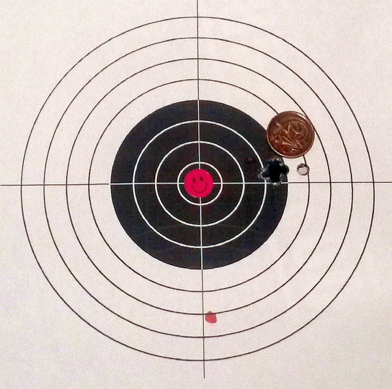

Here's a group I shot on Monday at Belmont using 2208 powder, 75gr H.P. and out of a Tikka T3 Lite .243Win at 100 yds.
i'm happy with it except pulled the 5th shot a bit.
Re: .243 great cal, looking for great loads!
Post by Bennybigbores » 22 Oct 2014, 8:52 pm
That's a nice group I get same out of my howa with load i listed above. Ar2209 44gr pushing and Speer varmint 75gr hollow point, what weight of 2208 and breed of bullet you using

Post by lole » 23 Oct 2014, 10:33 am
Still hanging on to a 2c coin for photos? :D

Hi Bennybigbores - I'm using new Winchester brass, 75gr. H.P.Speer Varmnit projectiles and 2208 powder. I'm a bit reluctant to give out weight just in case it's not safe in other rifles. No big secret stuff but just cautious.
Yep, Lole, it's the best bush screwdriver I've got and can't afford a two dollar coin for photos these days..
