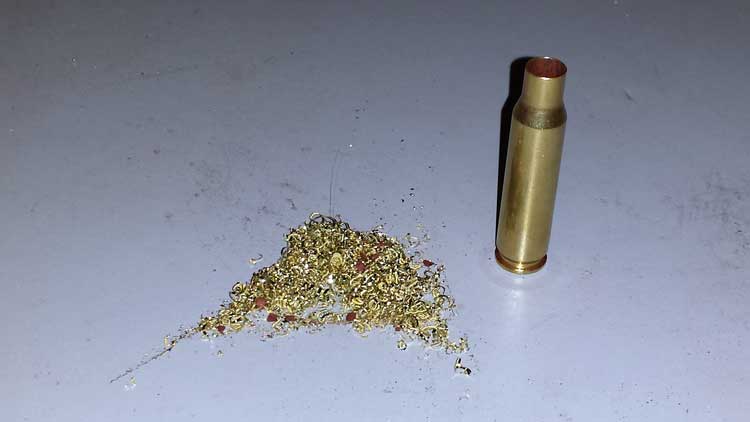

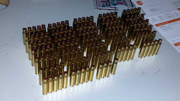

Post by Lorgar » 05 Oct 2014, 2:34 pm
These are old photos now, I thought I might have posted them ages ago but couldn't find so I guess not. If I've missed them anyway mods delete or whatever.
Anyway... With the usual how/what/when/etc questions that get asked about trimming brass.. Sharing this for anyone new to it so they can see.
This is from trimming 139 once-fired .308 brass so you can see get an idea of how much the brass stretched and was removed. (from all of it, not the 1 case in the picture)
Nice and shiny and ready to load :D

Out of interest Logar what trimming gear are you using and to what length did you trim these cases?
I used to use a lyman mini lathe to trim 7-08 cases but since I bought the Wilson trimmer I no longer have nightmares about trimming brass. Lol
I know i should limit my trimming to only .005" under maximum length but what I do is measure a few cases and trim a few thou shorter than the shortest case. That means The cutter trims almost every case in a new batch but only after I have full length sized them for uniformity

Chronos wrote:Out of interest Logar what trimming gear are you using and to what length did you trim these cases?
I'm using the basic Lee trimming system with the shell holder, cutter and case length gauge in the power drill.
What length... TBH I can't remember now. My .308 is now gone and all the brass has since been resized to 7mm-08 which is longer so can't measure for you.
I did a quick google but the marketing stuff I could finder for their trimmer just says "within SAAMI specs". I expect it was trimming to 2.005" as this is their recommendation.
By their specs the 7mm-08 should be trimming to 2.025" with the same system, I'll measure freshly trimmed 7mm case when I get home tonight and see.
If the 7mm case matches the SAAMI recommended trim length it's probably safe to assume the .308 cutter was trimming to it's recommended trim length as well - 2.005".
I'll let you know.

Post by Lorgar » 06 Oct 2014, 9:27 pm
Ok scratch all that... All my 7mm-08 brass is being trimmed to 2.015"
NFI about the .308 Win then sorry. Guestimate of 1.995" then?
