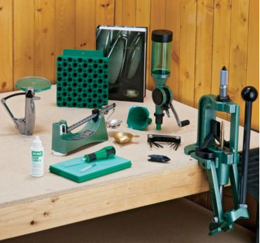

What you need, well the essentials are...
  • Reloading press to resize cases and seat bullets
  • Primer tool to prime cases
  • Power thrower to dispense powder
  • Scales to weigh powder charges
  • Case trimmer to trim brass as it gets to long
  • Sizing and seating dies for each cartridge you're loading
I think that's everything... Then trays to hold your brass, bits and pieces like that. Lube for the cases.
Have a look at some reloading kits like the RCBS Rock Chucker Supreme kit. They usually have everything except the dies. Lee, Hornady and everyone else make a kit as well.

A progressive press lets your reload faster, that's it. Not worth it unless you're shooting a lot. As for comments above, I dunno what singles stage presses being "very old fashion" is supposed to mean... They're perfectly fine. Thousands upon thousands of shooters using them every day and they getting the job done no problems at all.
Something like the RCBS Rock Chucker kit is $600 in any shop and comes with everything you need except dies.
Plus $70 or something for a set of dies.
And there are cheap kits than that too. The Lyman and I think Hornady kits are less. Don't know off the top of my head exactly.
