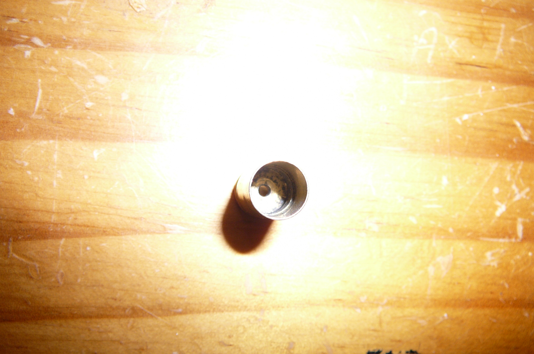

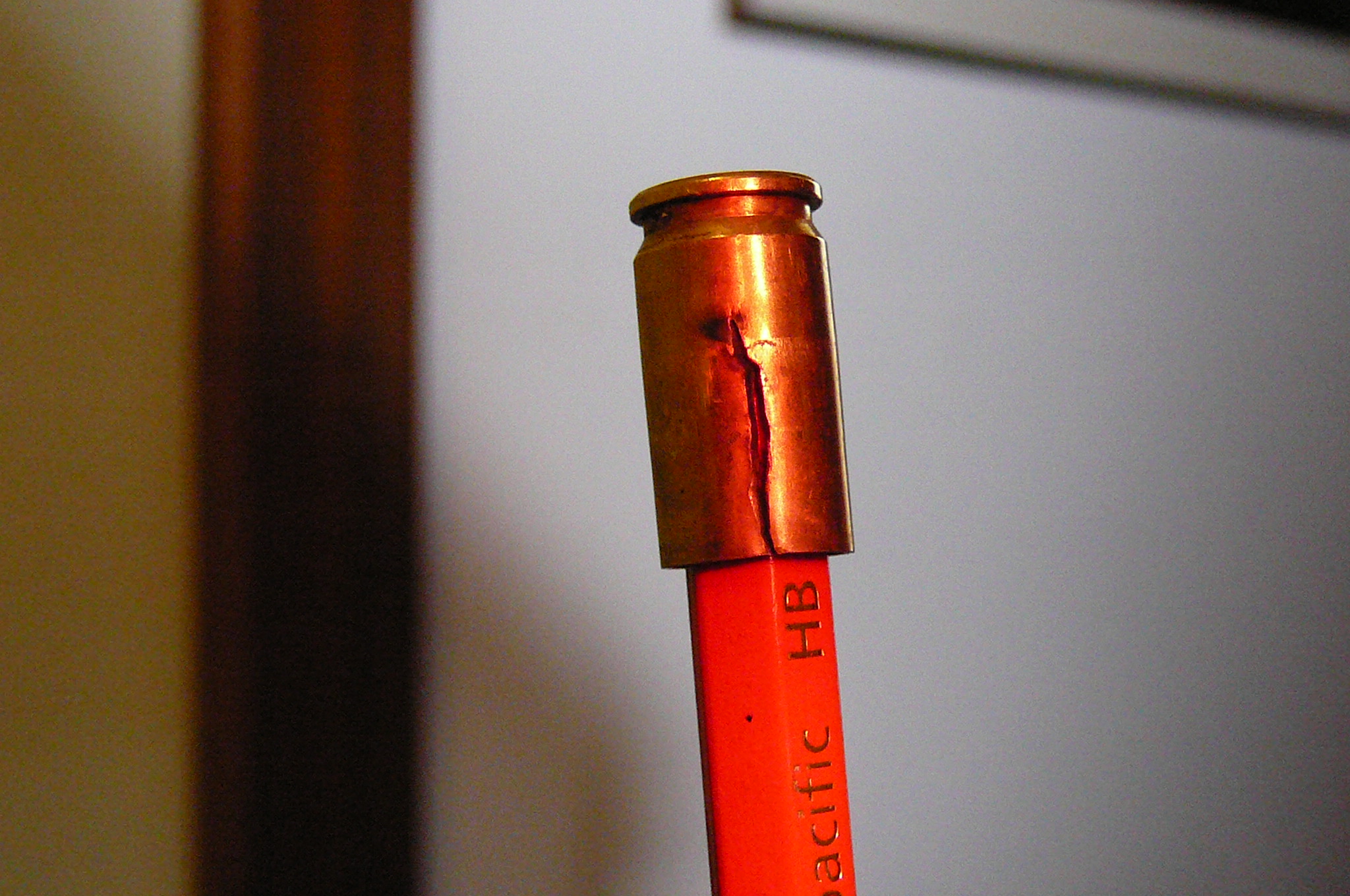

Loaded up some rounds for a weekend shoot and prior to loading I examine the cases to ensure they are safe to reload, no cracks or splits. I have several thousand so I rotate my cases, and sort them into calibres etc. Never know what you are about to find. Being safe in reload is a must, as is the care of cases and sorting. Some of my .45, .40 and 9mm cases get old and have been reloaded, some over 40 times, some heaps more. These 3 I hope are of interest.
Interesting marking. Any thoughts?
Inside at the base there is much more thickness than usual, never heard of the brand before.

Top one looks like it may have been a drill round originally .

No 1 fired in a H&K fluted chamber ? No 3 looks like a practice case for use with a plastic proj [ seats against the shoulder ]

Post by cavok » 10 Nov 2014, 7:37 am
bunnybuster wrote:No 1 fired in a H&K fluted chamber ? No 3 looks like a practice case for use with a plastic proj [ seats against the shoulder ]
Be Safe BB
No 1 is not fired through a H&K, opposite side of the globe.
Still think number 2 is great, get at least 1 more reload out of it. :lol:
No 3, after finding it in my used brass, I then began looking more closely, I have used heaps and never realised it.
To stop head separation or something?

Re: Sorting through used brass
Post by cavok » 10 Nov 2014, 10:28 am
tucked wrote:To stop head separation or something?
As I posted I now went through my brass and found heaps of them as I buy once fired from someone who purchases them from America. When I found the first one as the picture shows I Goggled the brand name and Bingo, yes they are on the market. The brand is Ammoload, yes you can buy them, I found them no different to load and shoot than any other brand, guess they just manufacture them that way.

Post by tucked » 11 Nov 2014, 2:04 pm
cavok wrote:guess they just manufacture them that way.
Fair enough. Probably makes part of the process cheaper or easier I guess.
