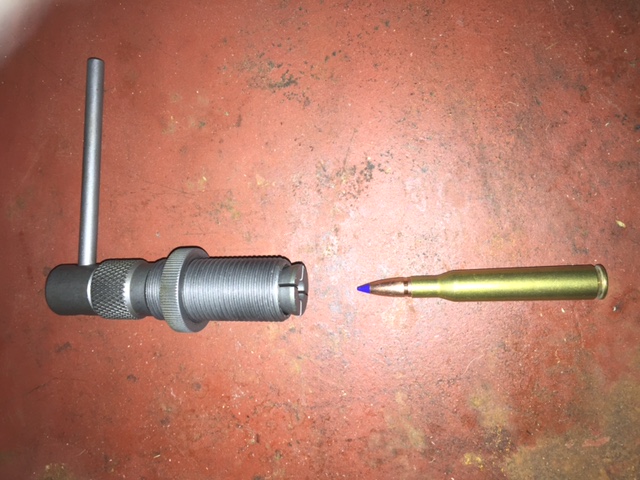

Post by Timb0 » 11 Nov 2014, 5:38 pm
I have to do some pulling tonight, I will take some photos :shock: :D

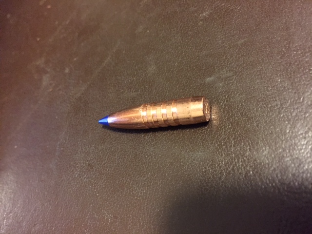

Post by Timb0 » 11 Nov 2014, 11:14 pm
I tried, but photography isn't something I'm good at. Also a barnes style bullet might have not been the best example.
If you look really hard you can see the scratches on the bearing area of the bullet. Its not much anyway and I will reuse it without thinking twice about it.

Post by wayward » 12 Nov 2014, 8:50 am
Timb0 wrote:I tried, but photography isn't something I'm good at. Also a barnes style bullet might have not been the best example.
Any photo is good mate :)
Appreciate the effort.
