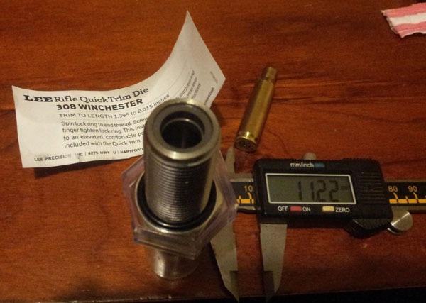

Received my dies today (yet to get a press) and have been fiddling with them, polishing crimp faces etc.
Looking at the QT die, I think there's a fault with it. There is a gray plastic insert in the bottom that has a shoulder machined into it. The inner shoulder is substantially smaller than a casing and wont allow one to be pushed (by finger) into the die.
My guess is its supposed to be a plastic o-ring holder and is unfinished? Theres mention of o-ring on the lee site.
If its supposed to be a nylon bush squeeze fit, seems its excessively undersized for purpose.
Does anyone have one they can take a look at?
First diameter 12.22mm, inner diameter 11.22mm versus base of an unfired factory 308win round, 11.80mm

I'm not farm ilia with the lee quick trim dies however have you allowed for the shell holder in your measurements? The car does't enter the die completely as part of the case remains in the shell holder so the case can be extracted from the die

A fired or even factory unfired wont enter the nylon bush at the mouth of the die past the shoulder of the case. Seems to me that .6mm interference is way excessive, but after posting my problem here it occurred to me that USA wasn't in bed yet.
I queried Lee with the above info and if there was a design change away from o-ring retainers... "The die needs to be installed into the press to get the brass through the nylon bushing. What you have is the current design."
I still have my doubts, I'll check the .6mm interference fit doesn't attempt to resize the cartridge or otherwise damage it, but so far it's confirmed by Lee themselves.
I did suggest that if it was shipping as intended, that they amend their online information or the included pamphlet to reflect the new design, I couldn't find any mention of it anywhere.
Without affirmation from them I wouldn't even be attempting to cycle a cartridge through the new nylon bush system. There's probably a relief behind the inner shoulder allowing it to flex outwards, but it's not detectable without some potentially destructive disassembly.

Howerver, final sorting of the issue depends on brass moving through that nylon bush without being damaged or downsized. 0.6mm interference......

The good news is empty cases go into the nylon bush easily enough, and aren't downsized in the process. Will probably take years before it wears enough to no longer stop them rotating.
