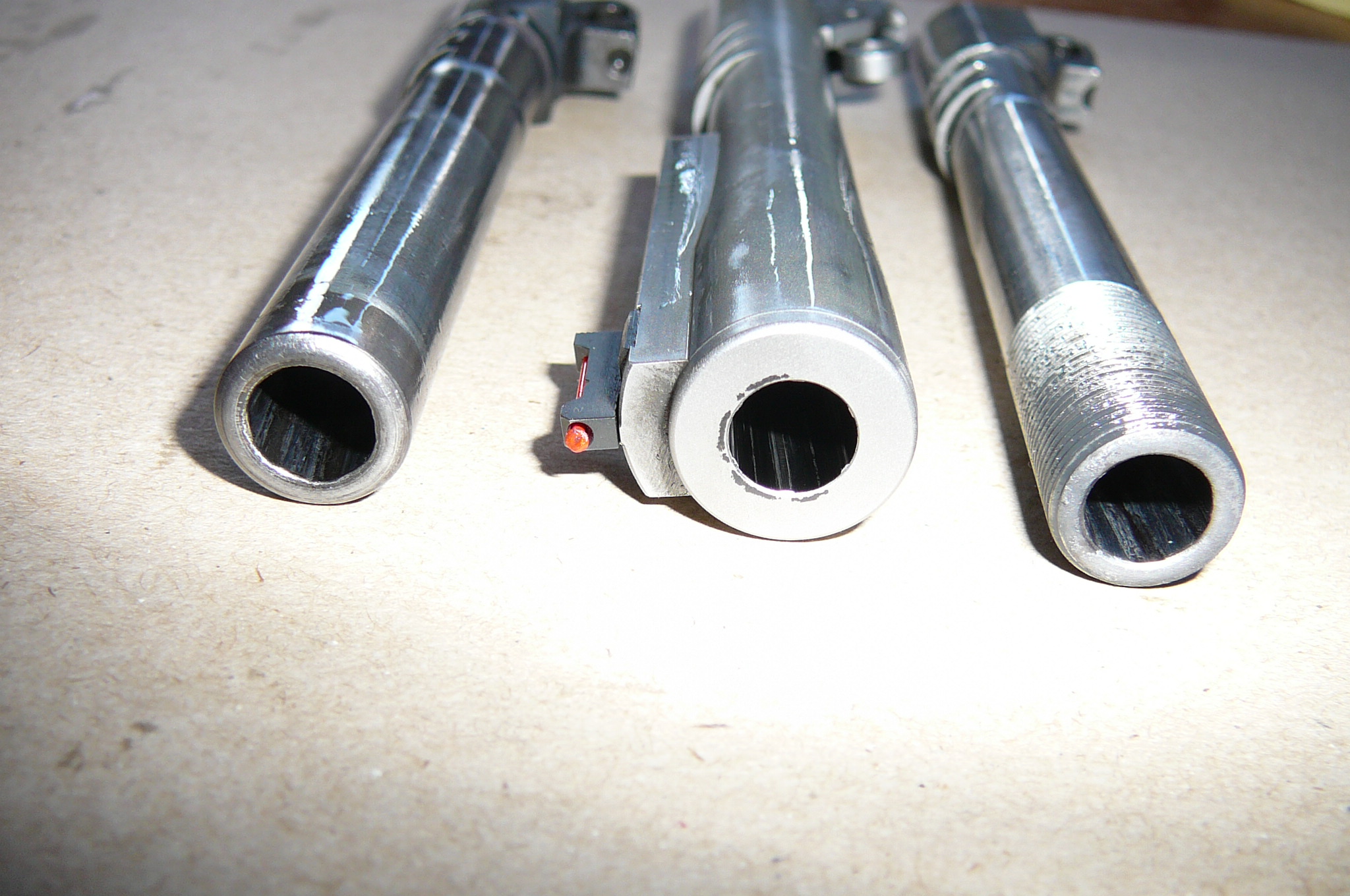

Here are the thickness measurements of the Two barrels, if interested. Also the photo of the chamber end. Please note that the material used in the production of the barrels from various manufacturers varies significantly, this is another factor to consider. A friend of mine using a LLama .38 super some years ago found that the metal used in the construction of his pistol was inferior to many other manufacturers. LLama is still produced in Spain today.
SP01 Shadow:
Front of barrel inner .355 Chamber inner .392
Front of barrel outer .550 Chamber outer .620
STI Apeiro
Front of barrel inner .354 Chamber inner .391
Front of barrel outer .703 Chamber outer .687
