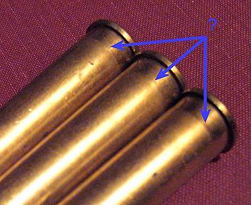

Post by sally-bee » 18 Jan 2015, 6:09 pm
Hi all,
I've been collecting a bit of brass since starting shooting, I notice some has a ring of lighter colour about a cm up from the base of the case.
Like it's worn maybe?
Just wondering what it is.

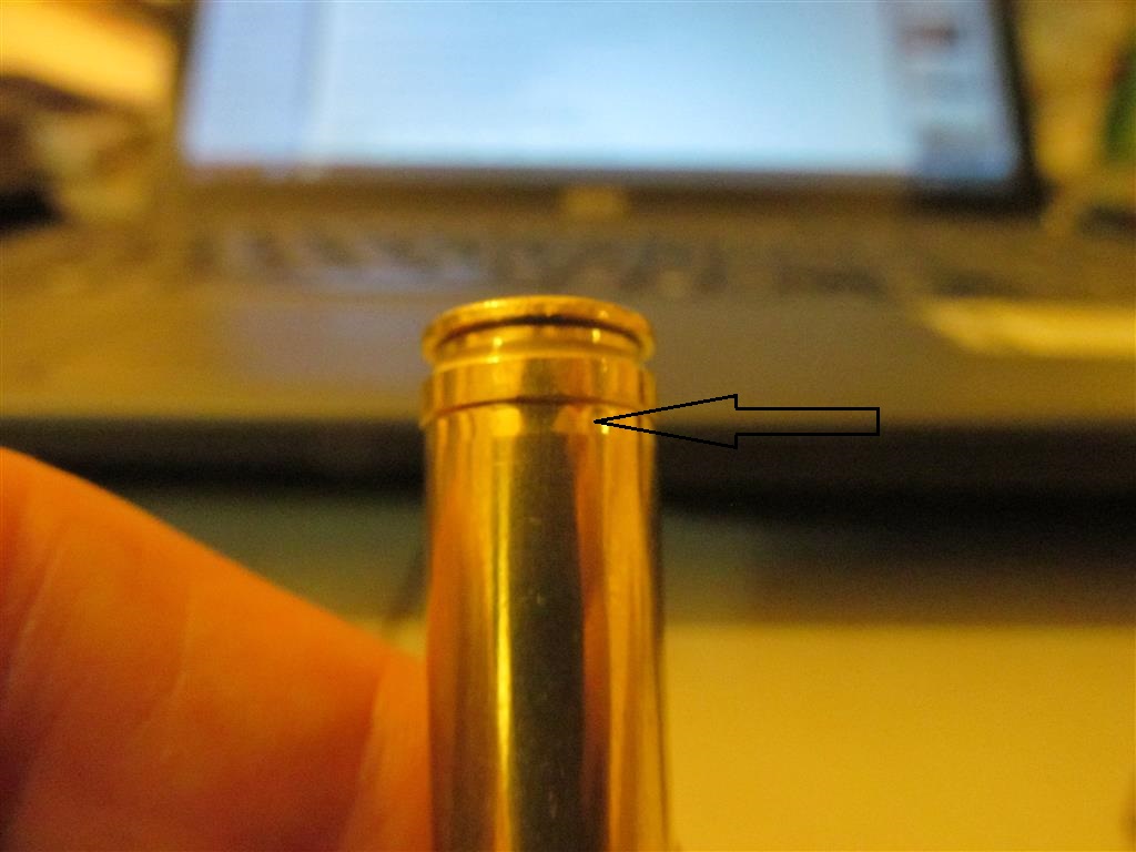

now forget that this is a belted case but if it's like this it is just expansion ahead of the web
IMG_1470 (Medium).JPG (120.08 KiB) Viewed 10031 times

deye243 wrote:now forget that this is a belted case but if it's like this it is just expansion ahead of the web
Hmm, it does't look quite the same.
That looks like it is the tip of an angle like the brass is pushed up? This is more of a coloured line but no obvious ridge in the brass case like that.

bigfellascott wrote:Put some pics up and show us some of your firearms whilst ya at it :D
I'm on my break at work but Googled for this which is the same as far as I can tell from the picture.
This is someone elses brass, not mine, but it's the same to look at.

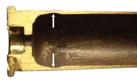

Post by Klem » 19 Jan 2015, 2:02 pm
Some expansion and thinning in that are of the case is normal.
See this (credit to massreloading website)
This will show more as the brass continues to fire.
Initially it's no problem, normal like we said, eventually though you get what's called case/head separation where that thinning finally gives way and the cartridges comes in half at the line in the chamber when fired. That ain't good.
How many times has the brass you're talking about been fired?

Yep, when it is starting to seperate you will see it with a careful look or felt with a 90 degree hook at the end of some thin wire, I am trying to dig out a few photos.
Case seperation so far as I have seen it in SMLE's, mausers and omarks hasn't been as big a deal as you may think, more a pain in the arse if the front half is stuck in the chamber(usually somes out fairly easily).
The potential is definately there for nasty things to happen but I have never even noticed until I see only the case head has been ejected. Usually the rest of the case comes out fairly easily. If you get one seperate don't shoot the rest of the batch until you have had a good look at them. Wearing safety glasses(as we all should) is a sensible precaution against any excess gas though most of it is usually vented away from the shooter.
If you feel sharp thinning as in KLEM's photo or see visible cracks on the outside then don't take the chance, but don't lose too much sleep.
