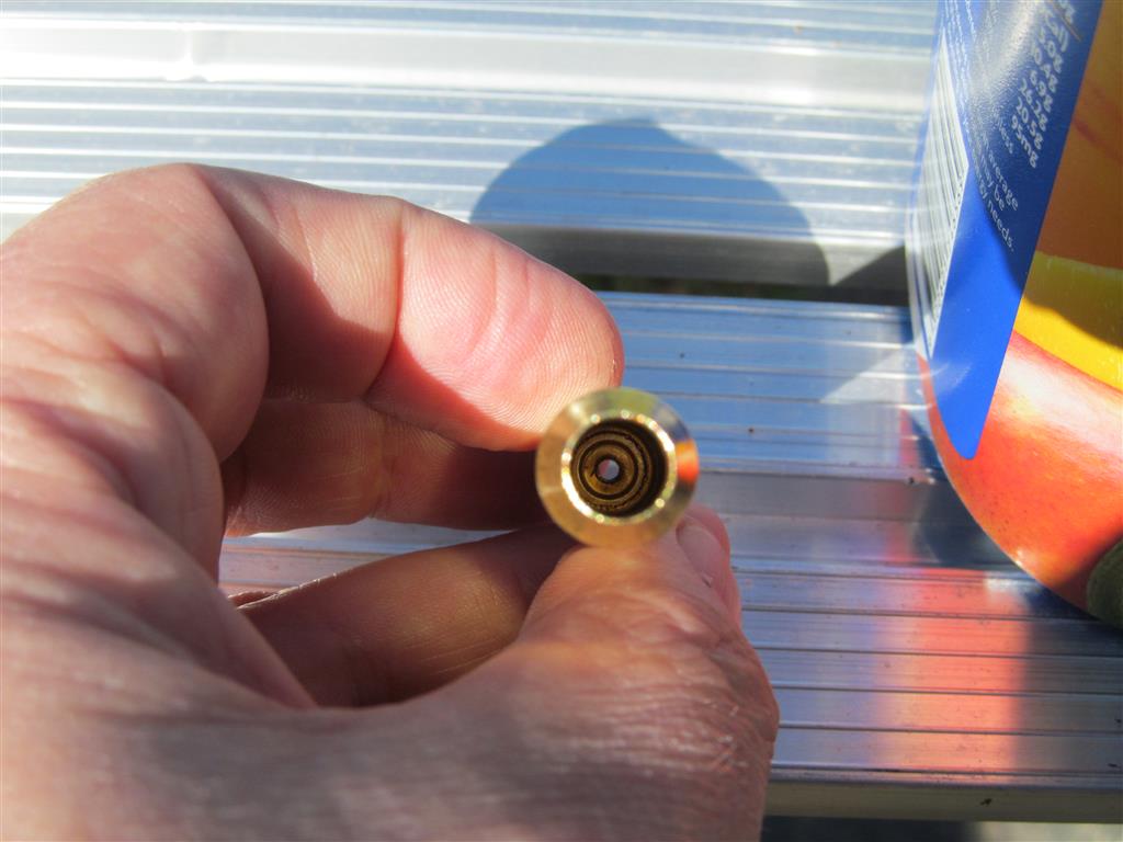

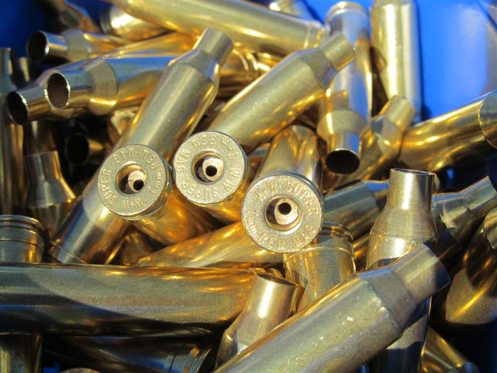

Post by deye243 » 26 Mar 2015, 3:01 pm
direct sunlight don't give the aperence any favors

Post by howtow » 26 Mar 2015, 4:49 pm
Still looks good :)
