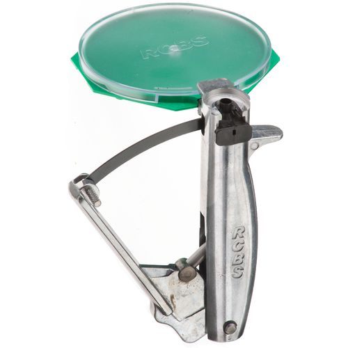

RCBS & .308W so we are using Large Rifle Primers.
I have only .243W & 30-30W and have done some 22-250R. The RCBS Hand Primer Tool I have uses a standard Shell Holder to hold the cartridge case and uses a black plastic primer insert to which the primer tray attaches.
I really can't see how the primers would not go into the primer pocket other than straight unless ...two thoughts, is the primer seater rod the large one that is near the size of the hole in the bottom of the shell holder, if the small one it may possibly allow the primer to tilt due to the much smaller diameter. Next thought is the primer seater rod centred in the middle of the shell holder hole. If you have the rod the correct way around, flat end to the top it should be very hard for the primer to go off line.
Is the shell holder (cartridge holder) the correct one for a .308W and the case head is held very snug. In other words you should not be able to tip the case to any sideways extent. The thought here is that a 30-30W Shell Holder for one is bigger and a .308W case (.243W in my case) is a very sloppy fit and will tilt sideways.
About all I can think of at present other than checking it out in person. Can you post a photo of the RCBS and one of your cases with damaged primer.

Post by pucker » 27 Apr 2015, 3:13 pm
Yep, large rifle primers.
The shell holder is definitely the right one, fits the brass pretty snug with no wiggle room.
I will try and get a clear picture of the indent and the pushrod in my one.
Sounds like we're using the same hand tool too, this one.....

"pucker" , that is basically the same as what I have .... except the section I can't work out where the case is held. That looks different.
RCBS have changed their design a number of times to what I feel is worse than the original. I'll see if I can post a photo of mine in the next day or so when I fix my camera. I would like to see a close up of where the cartridge head is held.
