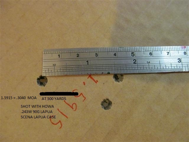

I am a huge 2208/2209 fan and most of my loads are for these two powders, but in the interests of not becoming stagnant I had a play last week with 8208, I have just developed a new load for some cheap 80(5 cents each) grain highland projectiles as I am about to start culling with the .243.
Got it way under 1/2" at 100 then zeroed at 200 and 300 ready for use as it was a perfect zeroing day. This led me to try for group on the 500m target. the center was kept for me and all five were in a 2" group, extremely good even though it is only a standard Tikka hunting rifle and the rounds are secondhand winchester cases with minimal prep(many will be lost so who wants to go overboard) and not seated in relation to the lands but to the cannelure groove and crimped.
I only shot the one group at 500 in favour of saving barrel time so it isn't definitive but only an indication.
8208 definately has potential, but I am probably more surprised at how these cheap projectiles went, but then 500m isn't a proper test of long distance capability.
Edit: corrected projectile weight and I have to stop calling it AR8208.

I am a big fan of 2209 in the .243 normally, I just had a different projectile to try and thought I had better try something different.

It was only one string of five, trust me after a group like that anyone would be foolish to not rest on their laurels. I didn't expect it and it really is a bit out there(lucky, some would say? And could I disagree with them?) but I will still take it. It shot tight groups at two and three hundred and as everyone was still at 500 and my rest and setup was still sitting there from shooting I thought why not?
This particular Tikka has always been a very accurate rifle with whatever is thrown down it. I am not a benchrest shooter but I do regularly shoot at paper at distance and generally make it on target.
Do your best, its not like I was shooting in a paddock somewhere, it was a properly marked target

Post by deye243 » 12 Jan 2015, 9:13 pm
Apollo wrote:Listen to "Warrigul"...he is a true Legend....
2" groups with a .243W at 500m then he deserves to be remembered as the best of the best.....!!!!!
And s**t cheap bullets, I don't know why he doesn't enter the Olympics....
FM.....!!!!! Someone has their hand on the wrong trigger here.....
Oh well Apollo you won't like this then

Kyle2632 wrote:Warrigul,
Can I ask where you got the cheap 243 projectiles from. I've searched but cant find them anywhere.
They were Highland projectiles in the bulk 200 pack, on chuckout and lumped in with a new scope, haven't seen them since.
Fine for fallow and mucking around with, they have proved to be more than acceptable. Wish I had bought thousands.
Warrigul
Apollo has personality issues.

deye243 wrote:
Nice shooting, Tex
Leupold VX-R 4-12x40
BBJ
