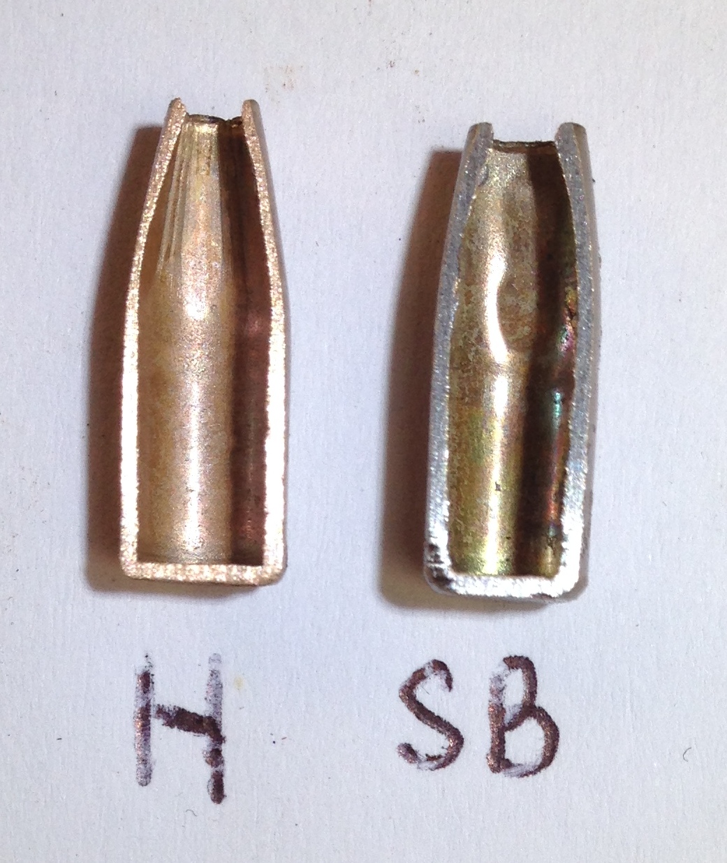

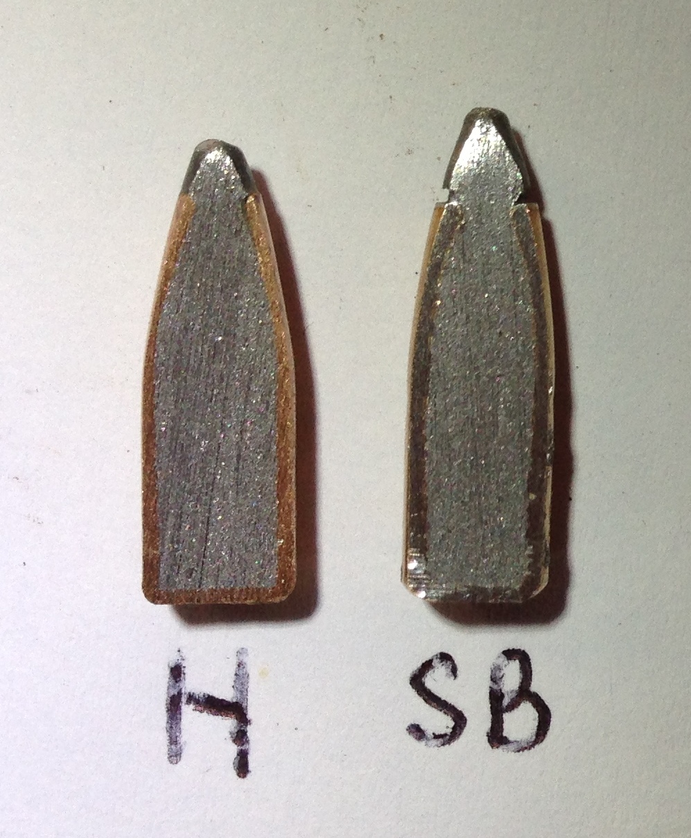

Bored today and have to stay at home. So thought I would go out into the cave and have a play.
I filed 2 55gr 223 projectiles in half today. (obviously these ones are at the cheaper end of the market)
One was a Hornady 55gr. SP (currently used by me for the odd fox) Weighed 4 and all were within 0.2 of a gr of the nominal 55gn
And a pulled 55gn from a S&B round. Weighed 4 and varied from .3 gn under to .6 gr over the nominal 55gn
(Pls note there are some dents in underside of the S&B proj, this damage is due to the way I pulled the projectiles)
Both had lead harder than normal lead,,about the same hardness as my cast projectiles. ( basic scratch test )

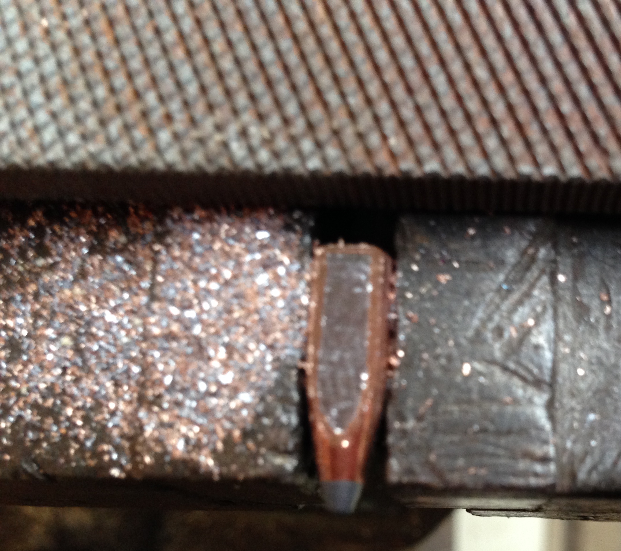

Filing in vice
Both cut in half
Both with lead melted
Initial conclusions:
1. The S&B looks to be a slightly different metal & perhaps a little thicker all round.
2. The Hornady seems to have pure copper & thinner at the nose, & I expect would open up a little quicker.
3. Neither have anything built into the design to help hold the projectile together as in more expensive projectiles.
4. S&B projectiles vary a hell of a lot in weight. This would explain my 4" groups from the Sellier & Bellot ammo in my Marlin. :thumbsdown:

You should get bored more often if you do educational things like this :) Definitely some differences in jackets between the 2 and Hornady are looking the better for quality. I noticed on the Hornady a difference in jacket thickness between the Ogive & Meplat with the left side appearing thinner which would have a slight impact on accuracy. What sort of groups you getting from them?

Mmmm,, I hadnt noticed the variation in the hornady jacket. Without any experimentation to speak of Im getting .7 moa out of the hornadys and I am definately an amature target shooter. Good enough for my use. Will tinker further when Im bored and the weather is kind, but currently too busy trying to find time to use them on foxes. Mainly because the fallow are calling me. ;)
