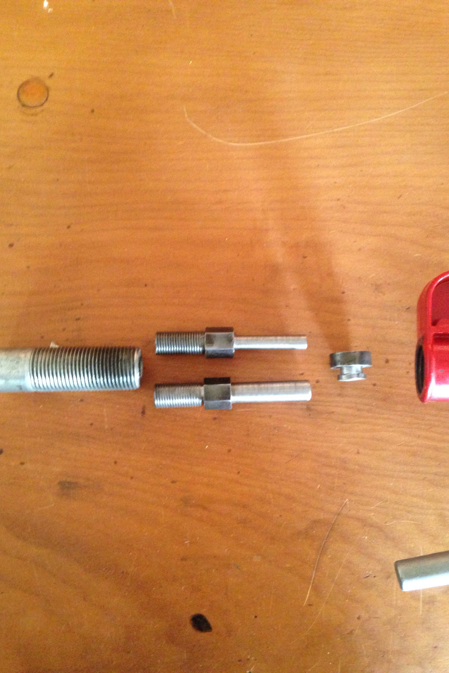

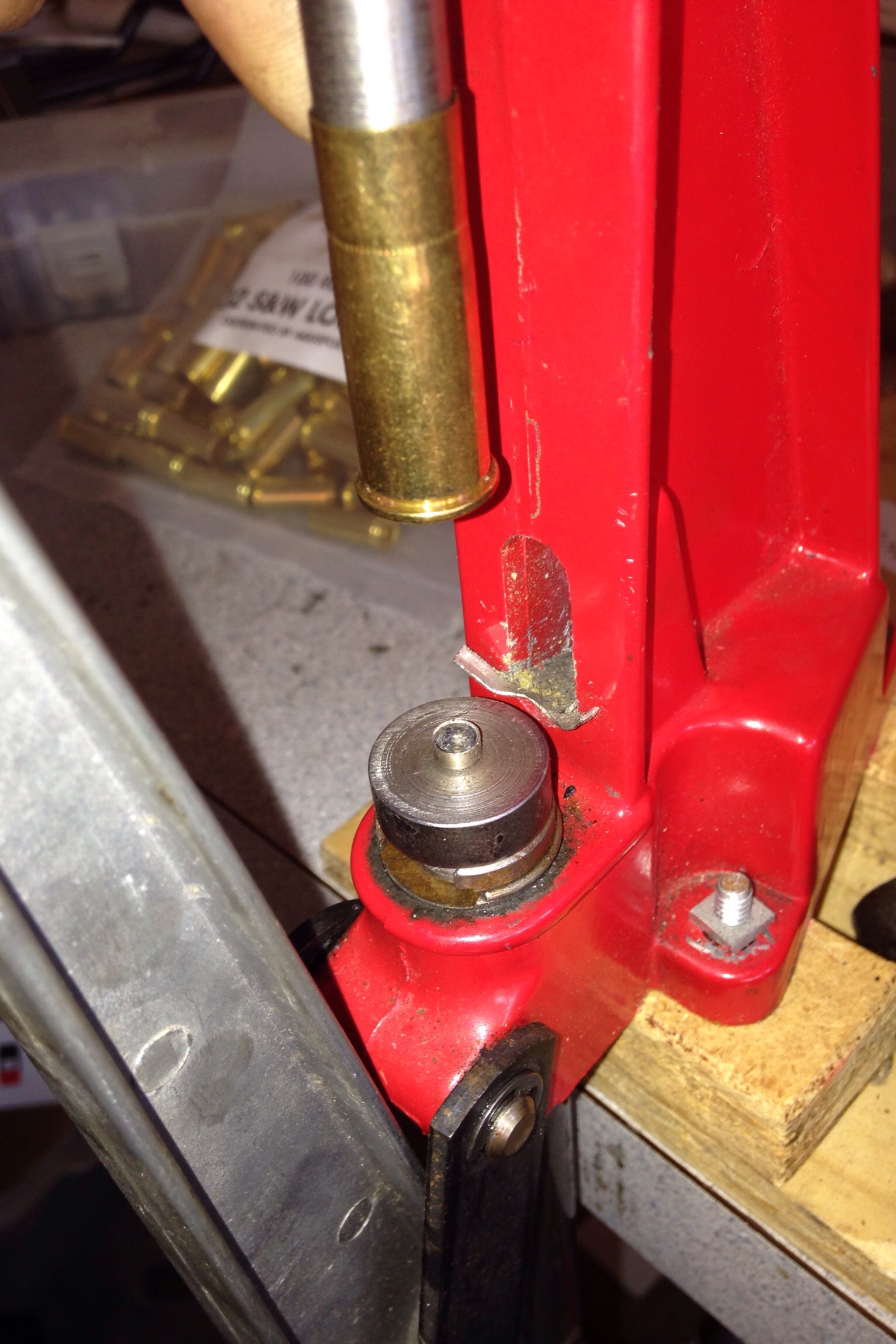

I've been out in the shed making stuff again and here it is.... Most of you who use Lee Autoprimes and like will know how annoying it is when you encounter a slightly tighter primer pocket that leaves the primer sitting a little proud and the case gets stuck in the priming tool. So I made this primer seating tool to screw into any standard press. It consists of a flat topped anvil that is in place of the shell holder and a stem holder that screws into the body of the tool. This allows more force to be applied to seating the. primer than you can get from an Autoprime.

Easy. I just hold the case on the primer and raise it till the stem enters the case. On tweak on the handle and the primer is in. Probably not really any slower than the Autoprime taking into account time used in sticking cases with primers not seated well enough. Stems could be made to suit any case.
