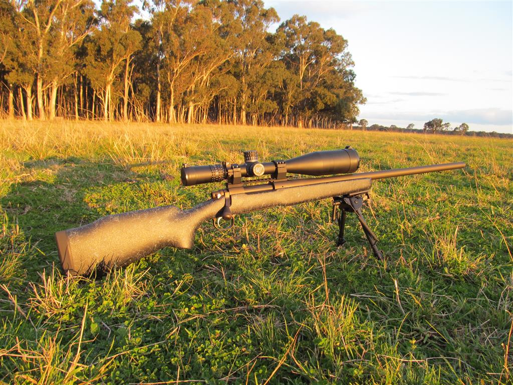

i not long had a 260R built on a long action and over the last couple of days i figured
as i do to take it out and find how far i can push it .
The rifle
IMG_2167 (Medium).JPG (229.72 KiB) Viewed 4748 times

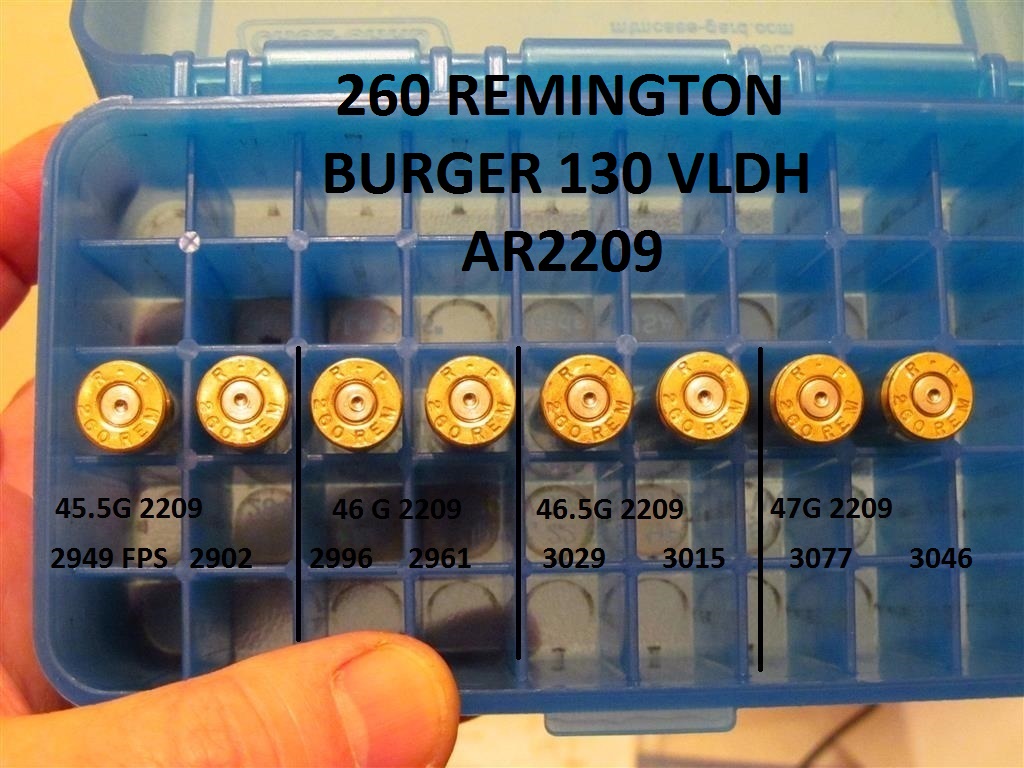

now for a 260 it is treading hot on the heels of a 270W .
this was yesterdays result ---------------------------------------------------------------------------------------------------------------------
this thing is now in 270W territory albeit some what flatter shooting and harder hitting because of
the higher BC of .552 . not much pressure yet all with easy bolt lift but the last 2 did stretch the case
head a bit........ think i might have a go at 46.5g just to see what groups it will give ....

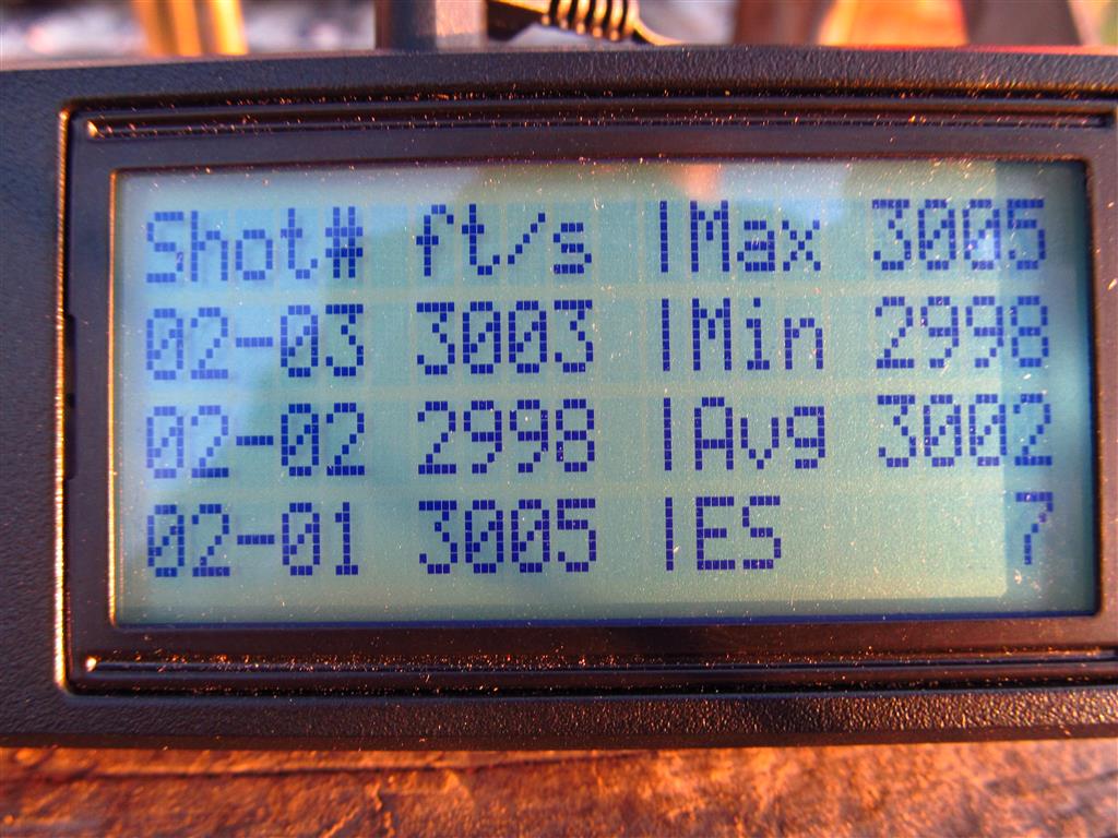

now today-------------------------------------------------------------------------------------------------------------------------------------------
i went back out today to try and find a spot out of the wind and see if the 46.5g load would group
and nope the wind was switching all over the joint so i just put 3 over the mag3 and this load has
potential if it groups .
load is rem case ar2209 46.5 CCI BM@ primer BURGER 130VLDH primer pockets are still tight they will get 2 more loads tomorrow .

I gotta love the IES of 7, very consistent and if it'll group you're on a winner for sure.

Very consistent indeed.
Don't think I've seen any that close before in fact.

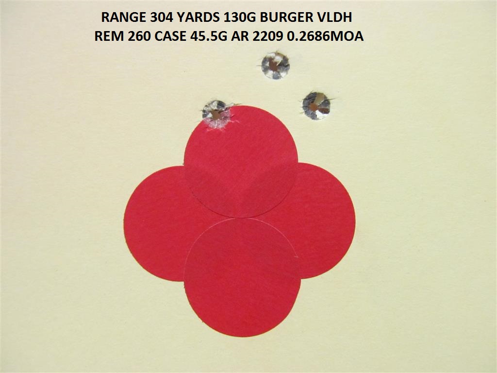

Post by deye243 » 11 Aug 2015, 6:27 pm
well it had good ES but did not group well around .8 to 1MOA ..
been crook as a dog (either i'm getting old or these virus's are growing bloody big boots)
but managed this on Saturday so i'm done for now i have 40 loaded with this and will put
through it's paces , might even shoot my first f class on Saturday if i can make it more than
20' out the door .

Post by lole » 13 Aug 2015, 12:12 pm
Didn't group well?!?!
0.26 MOA at 300 yards looks pretty good to me :lol:

Post by lole » 18 Aug 2015, 1:22 pm
deye243 wrote:well ya lost me on this one :?
Maybe I've missed something.
You said it didn't group very well but on the target you say it's shooting .26 MOA at 304 yards.
You say that's bad?
Or am I misreading something.

Post by tom604 » 18 Aug 2015, 8:10 pm
pretty good for 300, dots look like about an inch wide, the group looks like its just under a dot :thumbsup:

Post by deye243 » 18 Aug 2015, 10:34 pm
You say that's bad?
thats because it's a different load
tom604 wrote:pretty good for 300, dots look like about an inch wide, the group looks like its just under a dot :thumbsup:
yep 1" sticky dots
Bourt wrote:How extensive/precise is you're case prep for the loads to get that consistency?
the only thing i do is deburr the flash hole ..... case prep is for bench rest and you don't start that until you get down around .3 .4
accuracy is in a good barrel not a case .
i have lost count over the years of good rifles that shoot good with no case prep and some even with factory rounds they are out
there you just have to find one or build one just look at the HOWAS and the tikas ........

Post by lole » 19 Aug 2015, 10:44 am
deye243 wrote:thats because it's a different load
Ah my bad.
Too easily distracted by the pretty pictures and not reading :lol:
