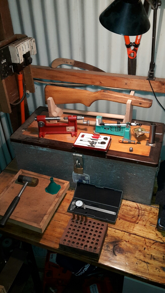

I use a lee loader with fine results.
I've been able to tune my .243 to .5 moa using one.
I also use a beam scale to weigh every charge, a home made powder trickeler, a powder funnel, nylon hammer to bash on the lee tooling, a primer pocket cleaner , a good edge chamfering tool, a quality case length trimmer , and vernier calapers.
I also anneal my brass to give me constant neck tension and increased case life and that costs little more than your time.
With attention to detail you can produce extremely consistent and accurate rounds using the lee hand loader and still be able to keep a straight face when you tell your mates that you reload to save money.

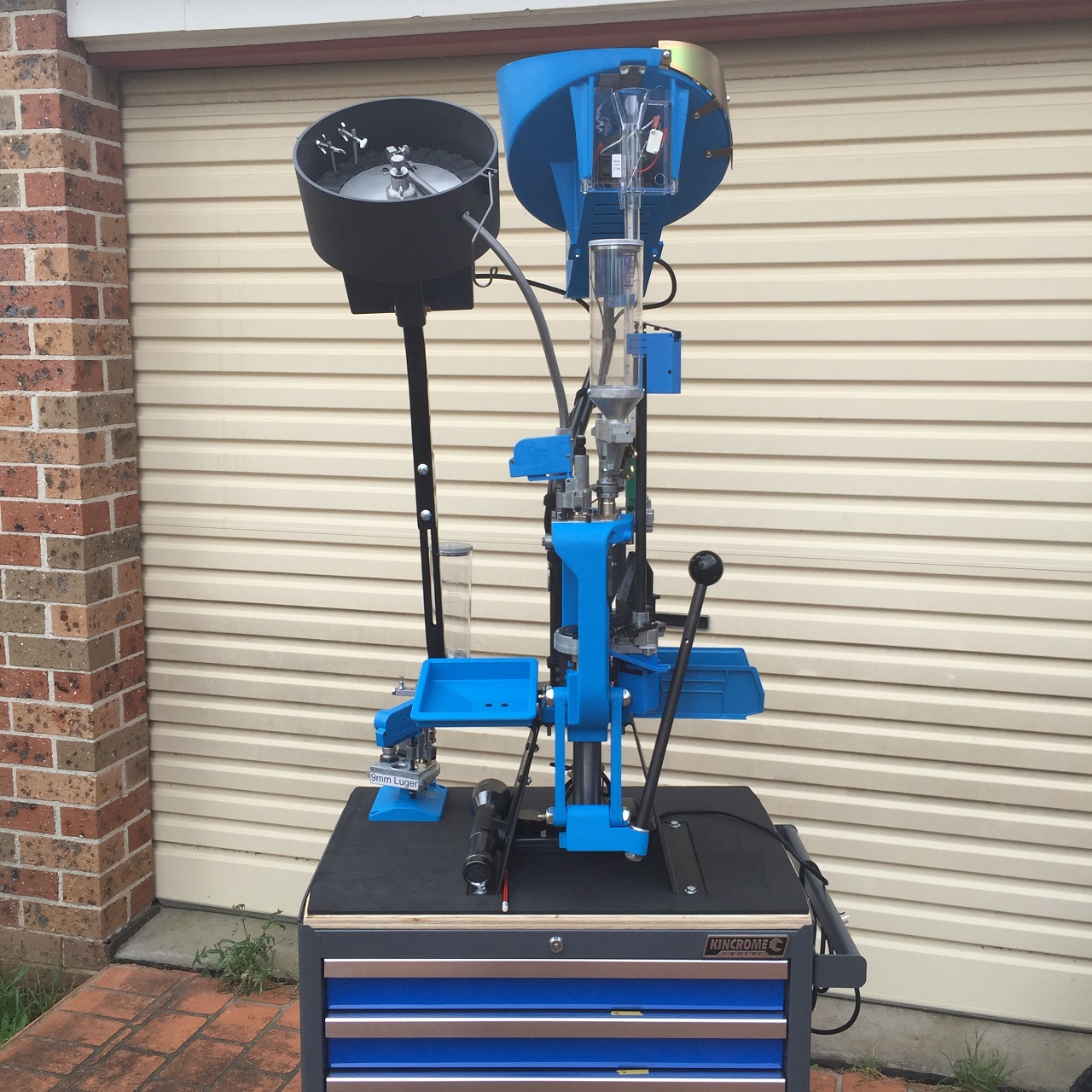

Like anything, without pictures it's all B.S so here's my Dillon XL650 all pimped out with case feeder and Hornady bullet feeder. Should be able to churn out 500-600 rounds and hour which will save me a heap of time. Currently I have toolheads for 9mm & 38Super but will get another 3-4 setup for 38/357, 44mag, 45ACP and .223 I'm heading to the U.S in a couple weeks for some R & R with the family and to do a few training courses so I'll see what parts I can buy there :)

Post by Carter » 22 Oct 2015, 9:41 am
What's the black cylinder bit on the top left there?
Carter
Posts: 213
Re: Lee Loader
Post by brett1868 » 22 Oct 2015, 10:46 am
Carter wrote:What's the black cylinder bit on the top left there?
That's the Hornady Bullet feeder which places the projectiles into the neck of the flared and charged case prior to the next station that seats & crimps. Dillon for all their innovation don't have their own purpose built bullet feeder. I looked at the "Mr Bullet Feeder" but due to its requirements of projectile specific plates rather then calibre specific I decided on the Hornady feeder. A coat of gloss black paint on the support post and some brackets to secure it level to the rear of the press were the only modifications. The Hornady feeder is very easy to set up and works perfectly on the Dillon press.
https://www.youtube.com/watch?v=74X8SvkpK0Y

brett1868 wrote:Like anything, without pictures it's all B.S so here's my Dillon XL650 all pimped out with case feeder and Hornady bullet feeder. Should be able to churn out 500-600 rounds and hour which will save me a heap of time. Currently I have toolheads for 9mm & 38Super but will get another 3-4 setup for 38/357, 44mag, 45ACP and .223 I'm heading to the U.S in a couple weeks for some R & R with the family and to do a few training courses so I'll see what parts I can buy there :)
What a great set up!
You sure don't do things by half's Brett.
