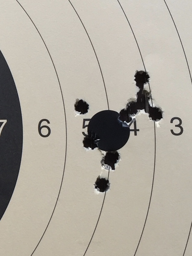

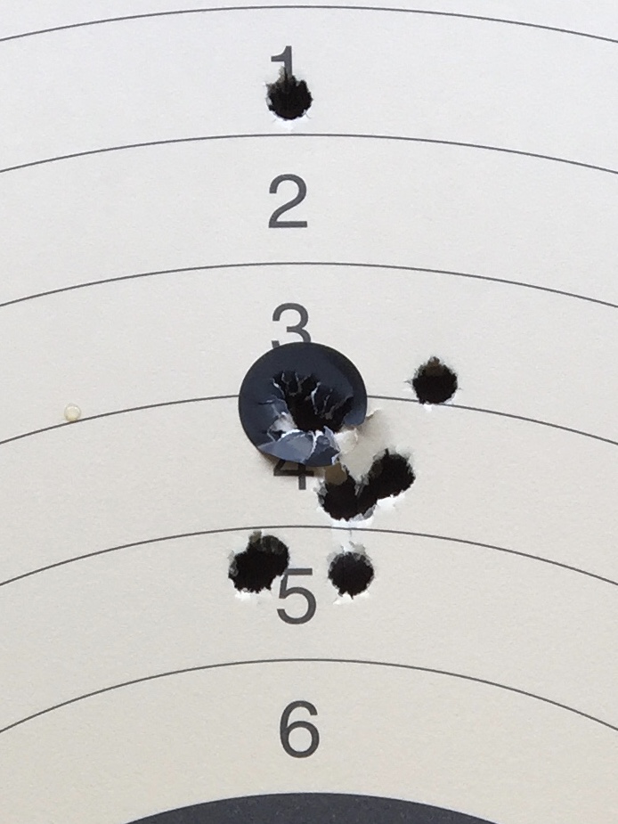

BTW, here's my best efforts with my S2 on the weekend, both from 10m with my reloads of 4.1gr of AP70N with 124gr Frontier copper plated projectiles. Each line is 20mm apart, aiming at the 18mm patches.

Post by brett1868 » 12 Dec 2016, 11:14 pm
@ItsMe, nice tight groups mate :)

Post by riggee » 13 Dec 2016, 1:10 pm
I know it's not actually the shot you want but there is something satisfying about seeing the hit dead straight through the number 1 on the target :D
