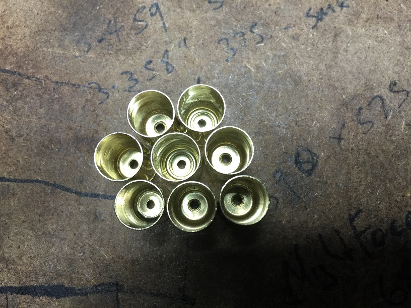

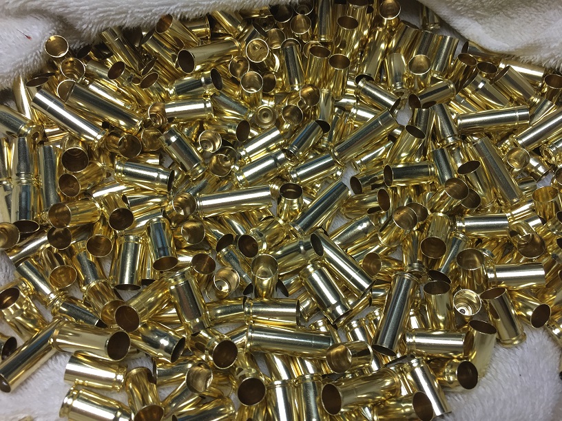

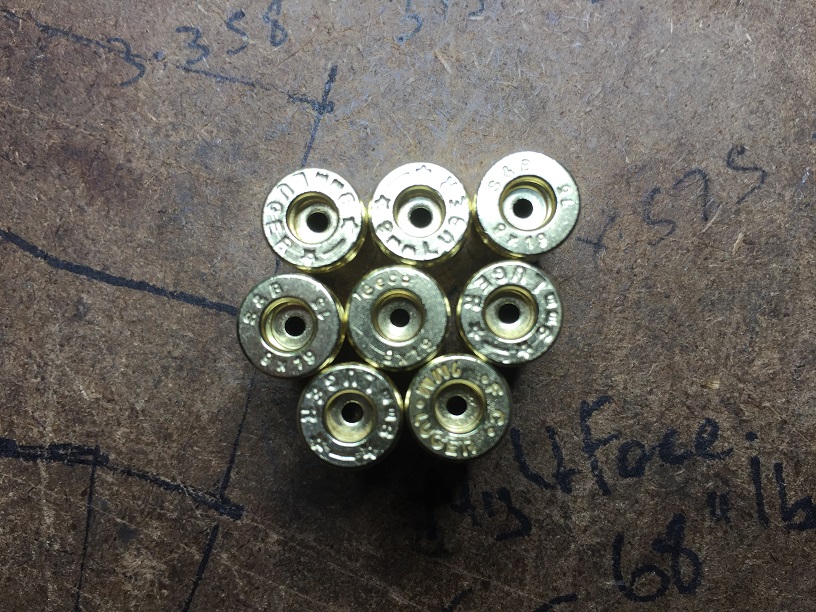

Post by brett1868 » 16 May 2016, 9:02 pm
Yes, a bit of a diversion from the OP's original question but without a little diversion he may otherwise not have known the pros & cons of other case cleaning methods. I've got a pair of vibratory tumblers that are not used anymore and a big ultrasonic I use on occasions to clean muzzle brakes, money essentially wasted and I wish I'd heard / seen the pin tumblers first.
Pictures below are self explanatory.
Before
Oh So Shiny
Inside same as outside
Pockets clean as new.
