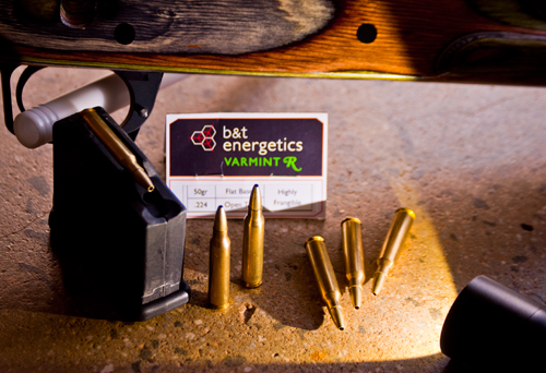

B&T Energetics varmint R
Re: B&T Energetics varmint R
Post by AusTac » 14 Jan 2016, 7:54 pm
Looks fancy

B&T Energetics were over on " God's " forum, a few of the members there had used these projectiles and only had good things to say about the results they were achieving, give 'em a go, ;)

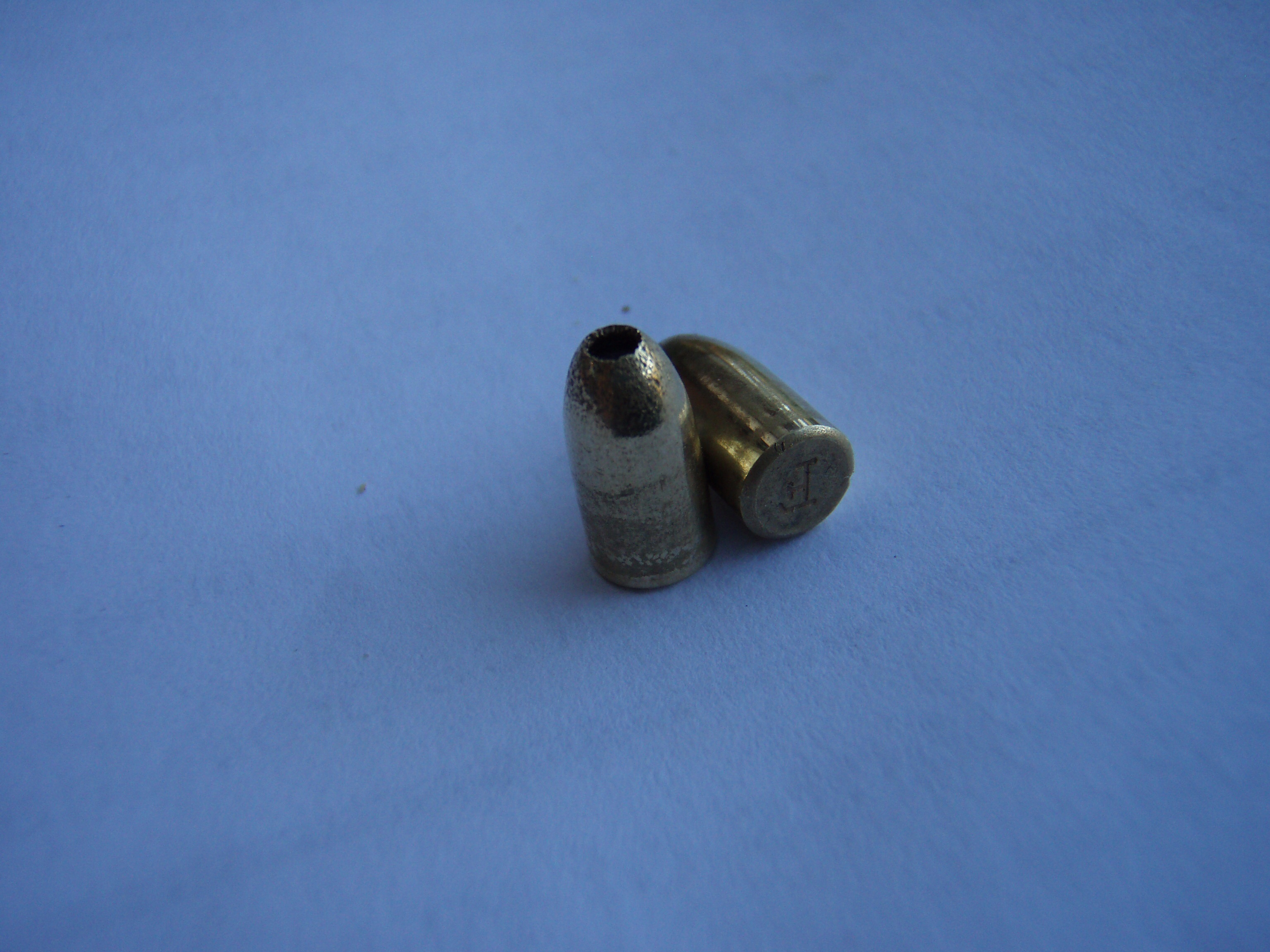

It is good to se that people are supporting the local projectile manufacturers. I also swage .224 projectiles from .22LR cases and I can say that the jacket is not hard from work hardening. In fact it is so soft that you can squash the case mouth between your fingers with little effort. Most of the time the annealing process takes place after the derimming process. After that it is just core seating and point forming. Point forming does work the brass but it is still quite soft.
The cost reflects the work and effort that goes into making the projectile if you count labour costs. As I build them for myself I do not consider the labour cost but as there is about eight steps in the manufacture of each projectile( depending on weight), that adds up to man hours over a thousand projectiles. Projectiles are not getting any cheaper and so I have just finished a set of ring dies to swage .172 jackets out of the .22LR cases.. That is another two steps.
The finishing dies I will get from Corbin. That is a wait of about 6 months or more.
These projectiles are very ...destructive... under 100 M. After that they mushroom very well. I run 40 grain projectiles through my K hornet but with a 1E nose radius(1calibre) and the 55 grain has a 5S, the same as the OP picture. Having a 5S radius on 40 grain or less leaves very little bearing surface, hence the 1E. The beauty of swaging your own projectile is that you can build any weight you want, change centre of gravity, hollow point, lead tip, etc, etc.

40 grain 1E projectile. These were from a first trial and as you can see the jacket is over annealed ( speckled) and are not cleaned after the point forming. It is easy to make junk. Quality control is a must and you need to experiment to get it right. As you can see the bearing surface is far more than a forty grain with 5S point ( above).

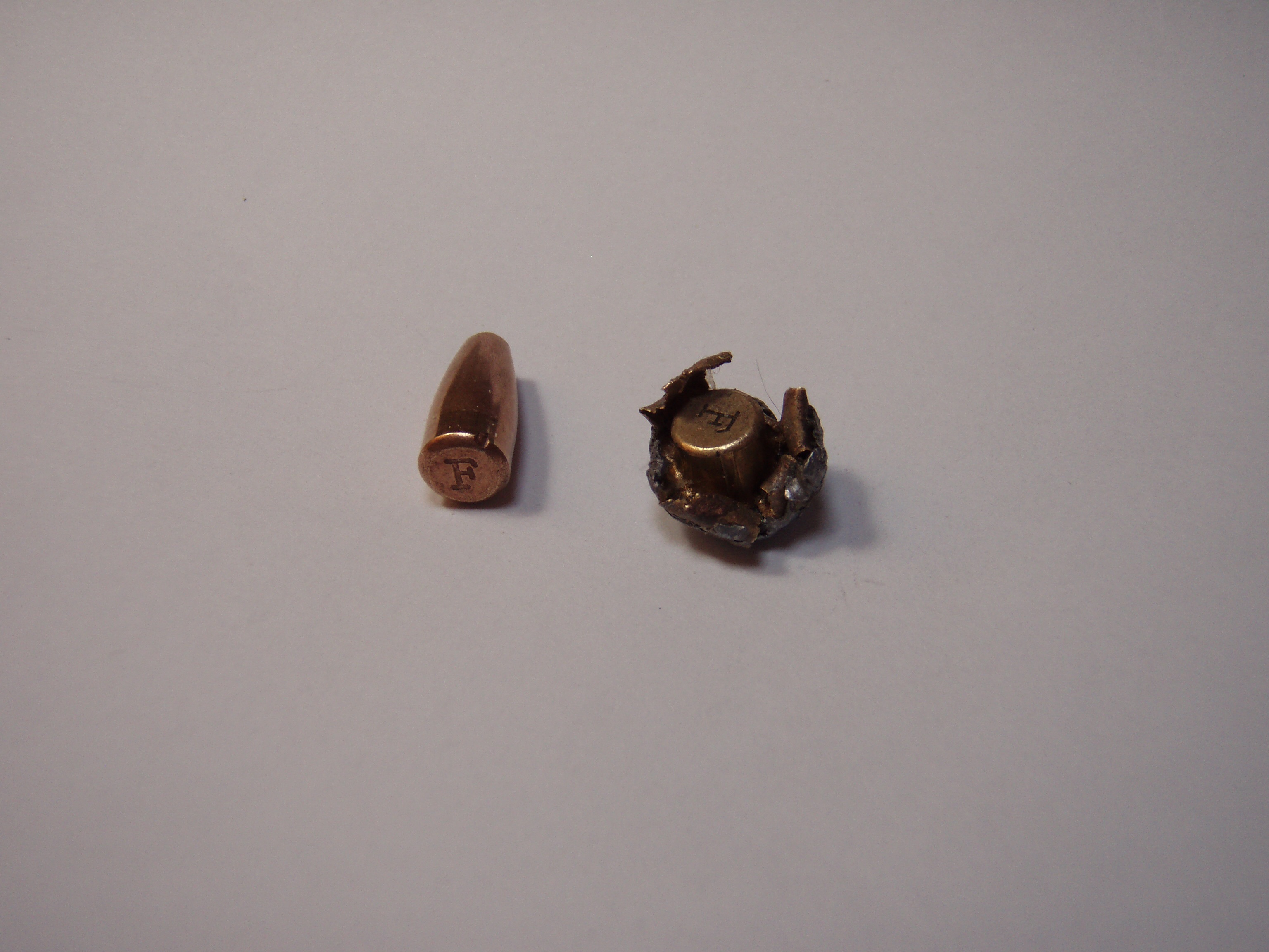

Hi Bentaz,
Out of the hornet they are great, I would even go so far as to say the 40 grain, thin jacket projectile is made for the hornet. The pic of the mushroomed projectile is out of a wallaby ( under permit) at about 150m. MV is about 2800 f/s. Anything under 100m and you only find fragments. If you are going to use trail boss I gather you want to go real slow and I think they will perform very well. They are ideal for thin skinned animals and they used thousands of this type of projectile around NSW for years on kangaroo culls (as there was a local bloke who made them).
The hornet has a slow twist rate and so the RPM is not a drama. There is a lot of discussion about what makes these projectiles fail in flight. There are some shooters firing these thin jacketed 55 grain projectiles out of a 22-250 and they hold together very well. It has been noted that these projectiles do not handle the high twist rate barrels very well, (1 in 10 or faster). I have not trailed this yet. If you want to get into the guts of the how and why, have a look at "Corbin bullets" in your search engine.
