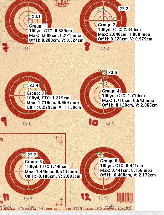

My Savage model 12 FCV .223 likes what is a slight overload (according to ADI) - so don't use the load yourself.
Bottom right pic is a 0.166 MOA group which is good enough for me. (Just looking at the date reminds me that I've been doing too much shotgunning and haven't used the rifle for ages.)
Sierra 9377 .224 77gn HPBT match projectile, CCI primers, Winchester brass, ADI 2208 powder.
I worked up the load using OCW technique (look it up)
See attached pic.
Image taken from 'On Target' software which calculates group sizes.
Cheers, Ross.
