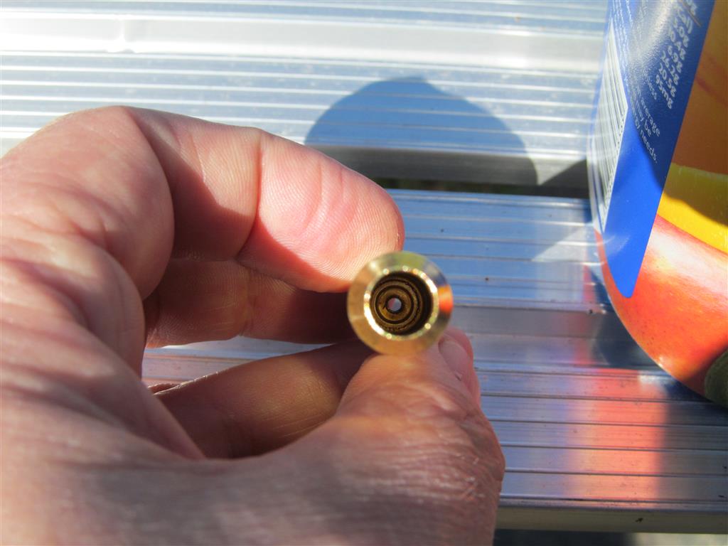

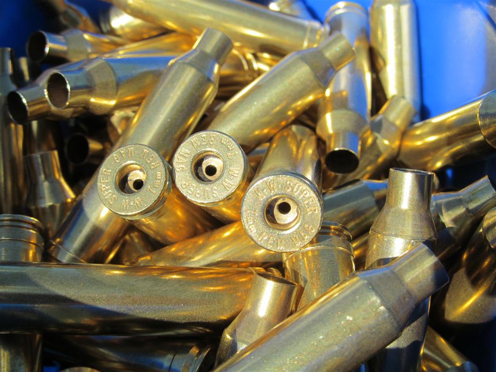

go stainless it cleans all the best bits , primer pockets and in side as well

deye243 wrote:go stainless it cleans all the best bits , primer pockets and in side as well

Don't buy into the gimmick here, it is Citric Acid, in case you're after science to my response lol http://www.chemistry-blog.com/2012/05/18/whats-in-lemi-shine/
...and remember, don't listen to the nay sayers, they know nothing. Shiny shoots better!
Posts: 2727
Re: Tumbling cases doesn't fully clean them, why?
Post by Mulder030 » 01 May 2017, 1:45 pm
juststarting wrote:Liquid they put in is just strong detergent, Australian brand equivalent is 'Fairy Platinum' dishwashing liquid (Woolies). You need a minuscule amount, maybe a tea spoon.
Powder they put in (Lemi Shine), is Citric Acid (baking section of any supermarket ($3 I believe) - maybe half to one of a .22 case worth by volume. Less is more.
Thank you Juststarting, Will tick up the Mrs shopping list now. hahahaha
Makes me smile more when i have a shinny finish product. :D :thumbsup:
