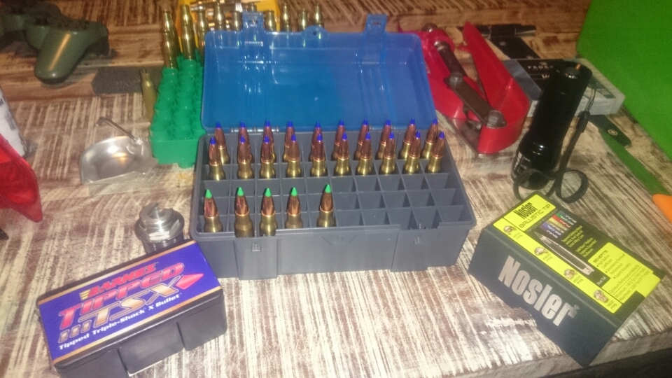

Well I have put some rounds together.
49.7 of 748w @ 2.810" barnes ttsx 130gr
And for s**ts and giggles
47.9 of 748w @2.760 nosler ballistic tips 125gr
Not sure why they suggested such a difference between the rounds, there's only 5gr difference between them.
I'll try to get to the range during the week.

Post by Goshawk » 18 Aug 2016, 12:36 pm
Ummm, pretty happy with reloads... 100m
Goshawk
Posts: 117

Post by Goshawk » 18 Aug 2016, 4:25 pm
Just above minimum load.
Damn happy considering I'm only using a 2-7x33 Leupold Ultimate. The circle/ring reticle is excellent, equals a 4" circle at 100m. Perfect for deer.

Post by bobnob » 21 Aug 2016, 6:55 am
Goshawk wrote:Ummm, pretty happy with reloads... 100m
Assume the pic is the Barnes?
Had any opportunity to chrono the loads?
Looks like a nice combo if you can produce that accuracy reliably.
