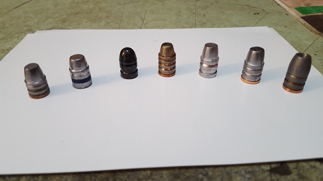

Here's a selection of bullets that I've used in the .44 mag lever-gun.
44 bullets.jpg (62.43 KiB) Viewed 14213 times
They are left to right: 220gr Lyman G.C, 240gr HRBC bevel base, 240gr MAG bullet bevel base (coated), 260gr H.P G.C (unknown mold) 240gr plain base N.O.E mold, 260gr Lyman G.C and a mates 265gr "crater" point G.C.
Best results have been with the Lyman molds with 18 grains of 2205 and the N.O.E plain base with 7 grains of trail-boss.
The HRBC and MAG are commercial bullets. I don't think Hawkesbury do that one anymore.
I had a Lee 200gr mold but gave it to a mate as my rifle ( Model '94 with 12 groove rifling) didn't like it. It shot fine out of his 24" barreled Rossi '92 clone.
