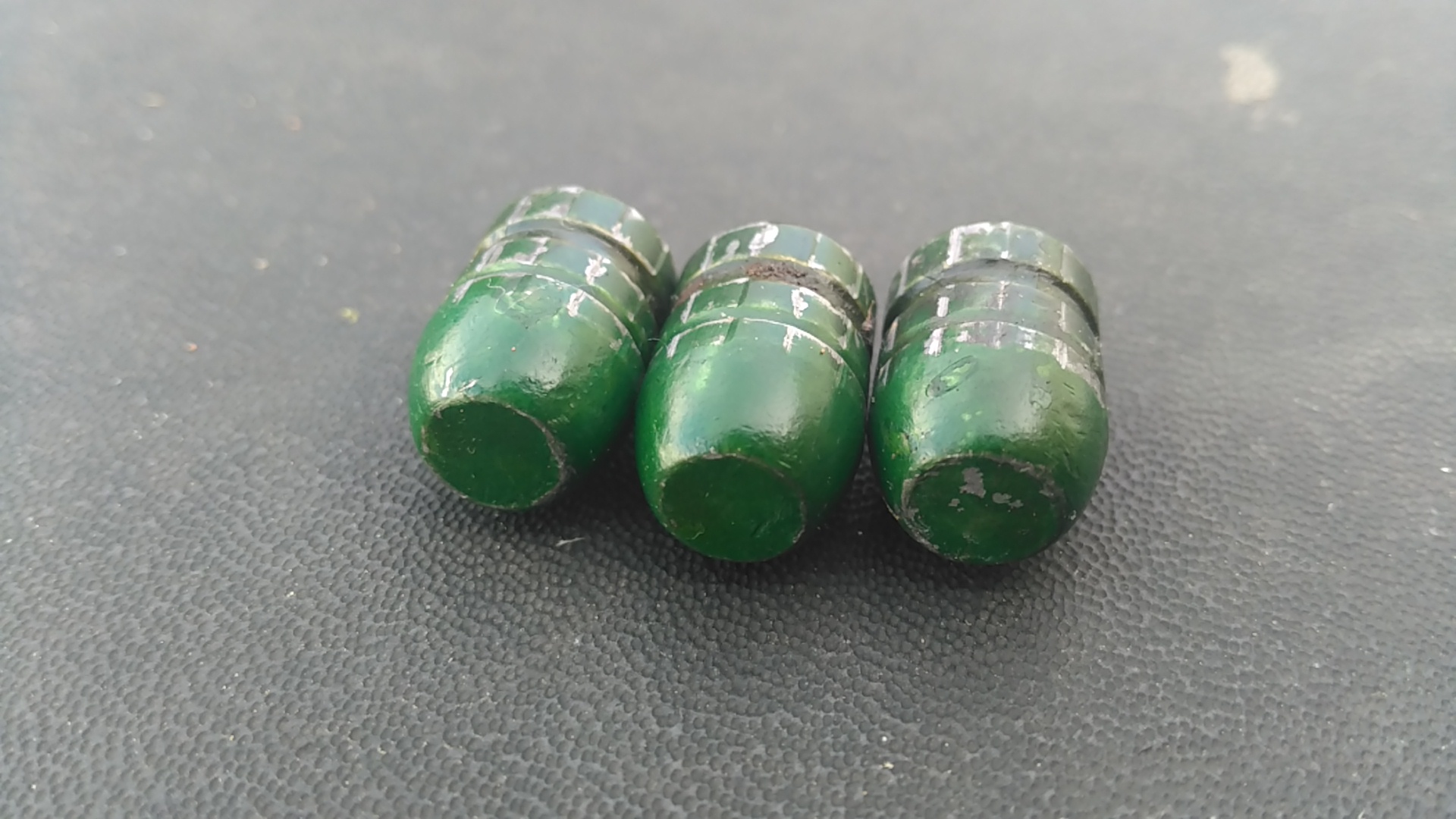

I've just had a bit of a bad experience using 210gn rnfp bullets thru my 44 mag so I'm thinking of trying to drill a hollow in the tip of the others using a drill press to see if that improves their performance. Has anyone tried that or have any advice ?

I used to drill holes in 6.5x55mm FMJ's with no measurable loss of accuracy.
Haven't tried with cast bullets, although I often think about it.
But soft lead disrupts so well that I just don't see a hollow point offering any improvement.
Maybe your bullets are too hard? What velocity are you shooting them at?
Have you recovered any from dirt to see how deformed they are?
Stand one on a vice and hit it with a hammer, should give you some idea of how soft it is.

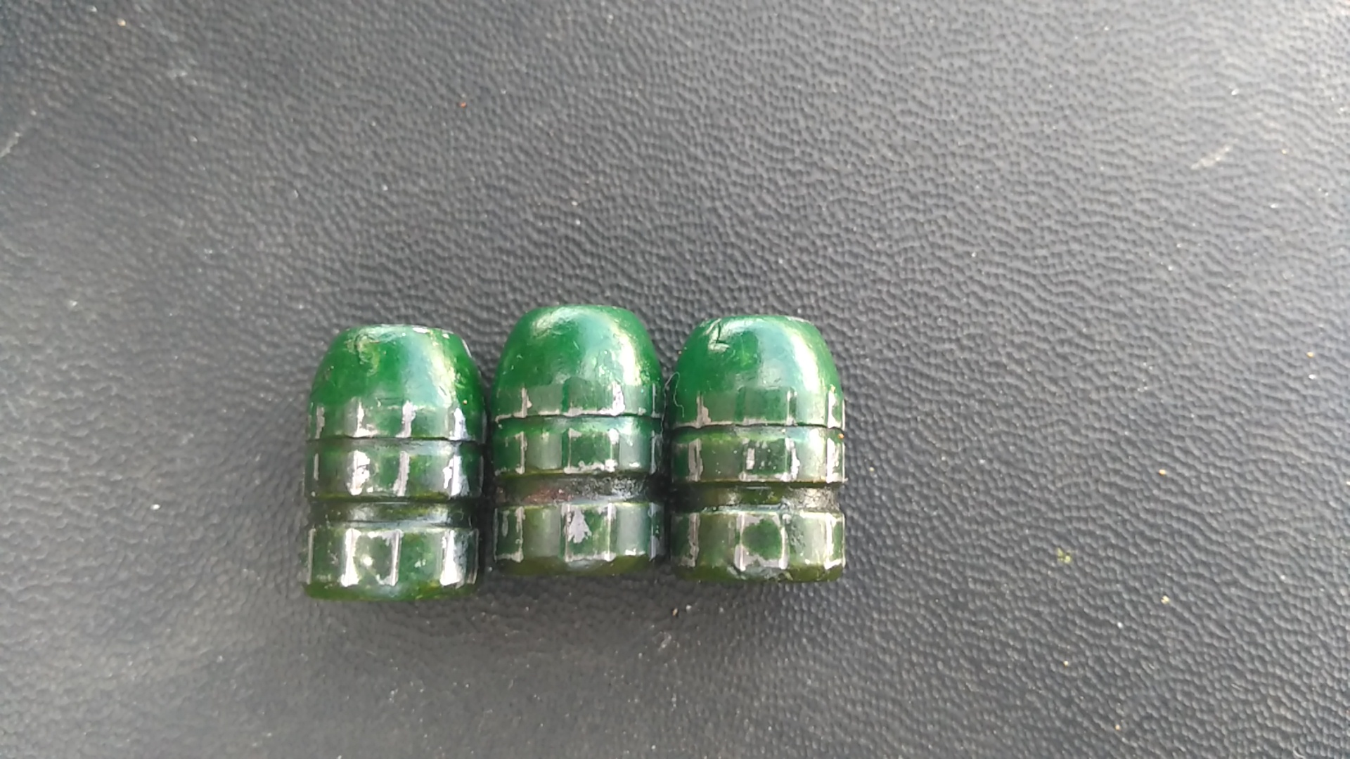

So I fired 4 rounds into 20litre drums full of water today. The projectile passed thru 3 thicknesses of plastic and about 2 feet of water with enough force to dent the last wall of plastic,actually penetrating in one case. All with zero deformation. The rounds are 210gn coated rnfp lead on top of 7.5gn of Trailboss for ~900fps.

I would expect them to deform in water though.
Shooting into water is how you recover an undeformed bullet for analysis.
EDIT: I mean't I would NOT expect deformation in water - sorry.

bigpete wrote:So I fired 4 rounds into 20litre drums full of water today. The projectile passed thru 3 thicknesses of plastic and about 2 feet of water with enough force to dent the last wall of plastic,actually penetrating in one case. All with zero deformation. The rounds are 210gn coated rnfp lead on top of 7.5gn of Trailboss for ~900fps.
If you're only shooting at 900fps I would definitely be using pure lead, not hardened.

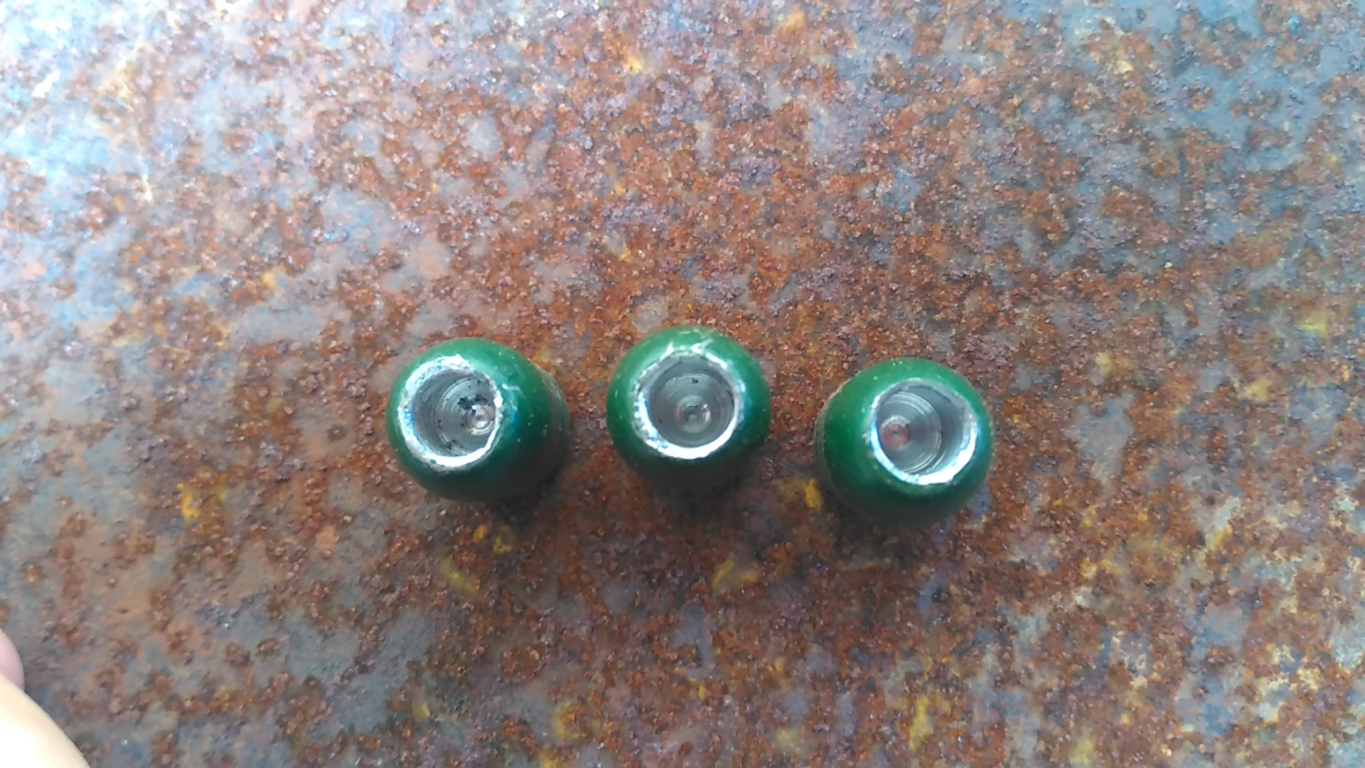

Post by bigpete » 25 Aug 2016, 3:45 pm
My first rough attempts using a drill press as you can see one is very slightly off centre the other 2 are fine hollow is roughly halfway into the bullet and about 6mm in diameter. Bullets weight between 192 and 195gn. Starting weight was meant to be 225gn so they lost around 30gn. That ought to bring bullet speed up a little too. Just need to load a few and test them again, then check their accuracy. I think they'll work just fine for what I want.

Post by Oldbloke » 25 Aug 2016, 5:44 pm
Will be interesting to see the result. I suspect a smaller drill would do the job, say 4mm. But look forward to pics
Re: Diy hollow points
Post by bigpete » 25 Aug 2016, 5:48 pm
Yeah probably but its kinda what I had at the time. I've ordered a centre drill bit which I'll use in future endeavours. I kinda like the idea of a massive hollow point,it should open up pretty well plus have a fairly thick base and walls to maintain a bit of structural integrity. But time,and tests, will tell

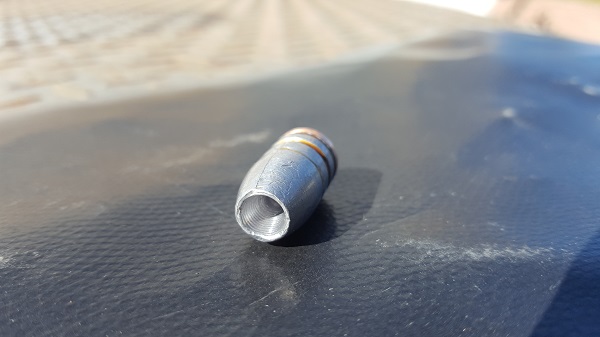

Post by Gamerancher » 26 Aug 2016, 10:22 am
Here's a hollow point .44 bullet for you. Mate in Tassie has the mold and made some for me. Work real well on "critters" at low velocities. :thumbsup:

Post by Gwion » 26 Aug 2016, 11:05 am
Holy crap... they should call that a Cavern Point... you could park a truck in that cavity!

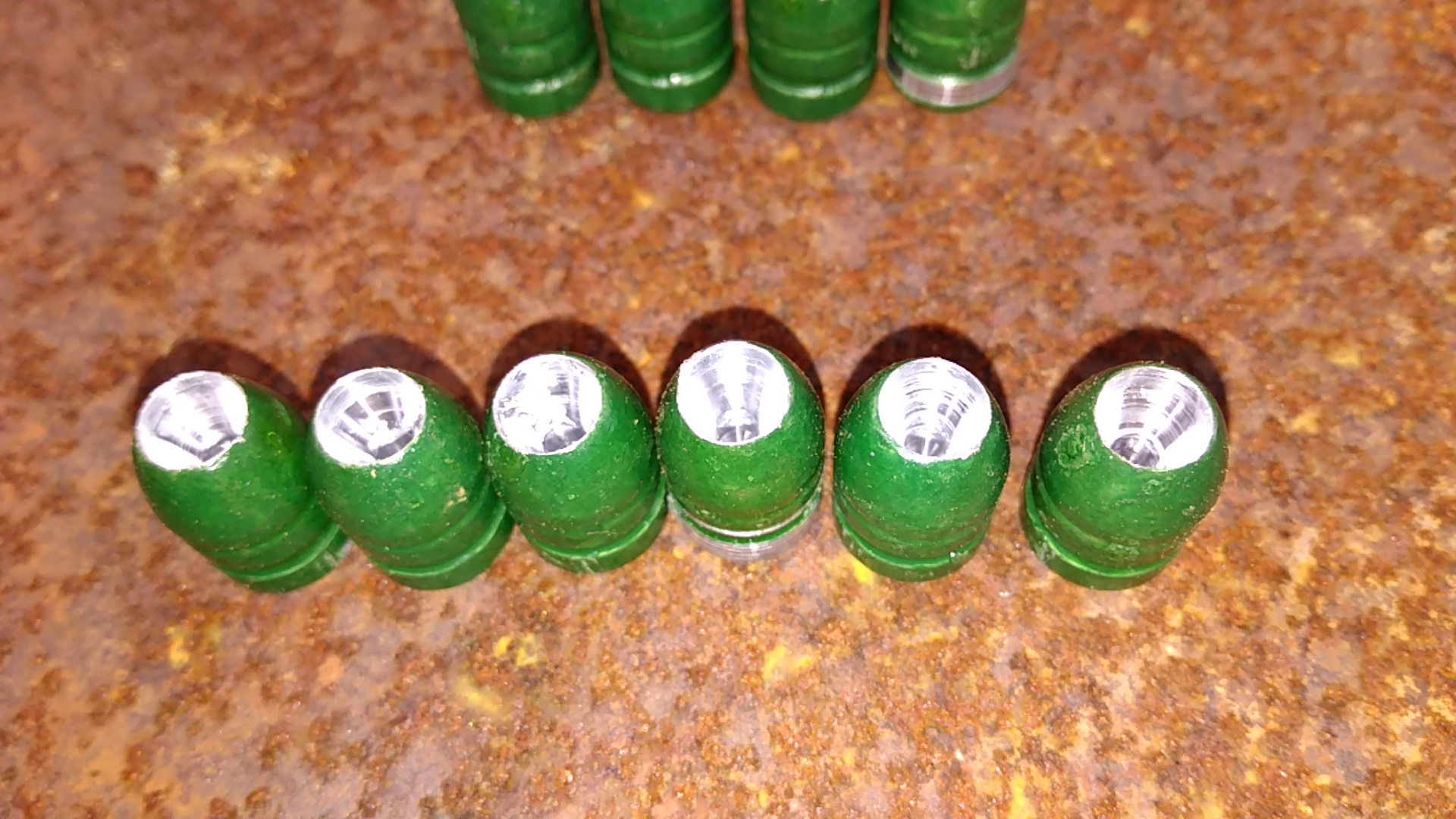

Post by bigpete » 26 Aug 2016, 12:05 pm
here's some I just did using a ¼" centre drill bit. I really need a jig to hold them straight as a couple got off centre and I'm sure won't shoot straight. Finished weight is 200gn. How heavy are your mates bullets gamerancher and does he take orders :-)

Post by Gamerancher » 26 Aug 2016, 12:32 pm
They're pretty fat, come in at 260grains. Don't know about orders but I could find out what mold he used if that will help.
Those ones you've drilled look alright. At 200 grains, they should work well. Try 'em and see!
