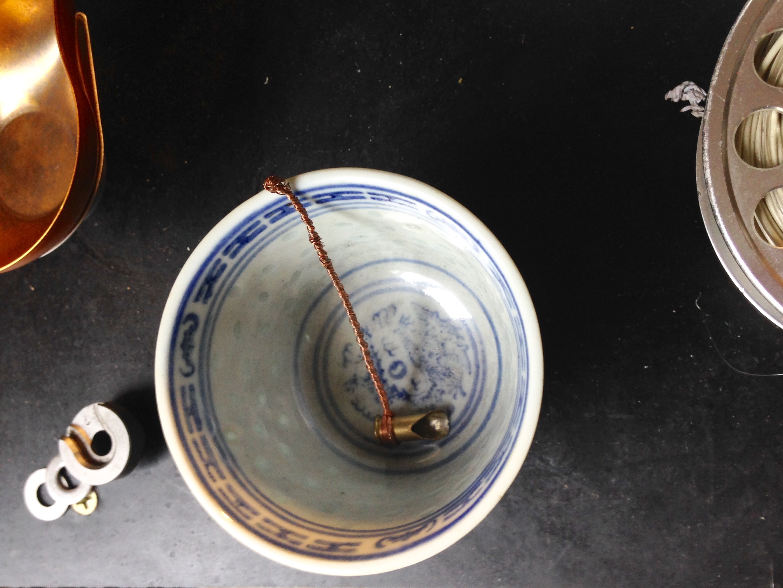

Maybe i should post a pick of my little scoop, then you'll know what i'm talking about! :LOL:

Pic, do it.

I put some powder in the little tea cup and scoop it up with an old 22 case held I copper wire. Works ok. I can generally correct my charge pretty quick as I can eye out how much I need.

Post by juststarting » 20 Sep 2016, 1:48 pm
Nice!

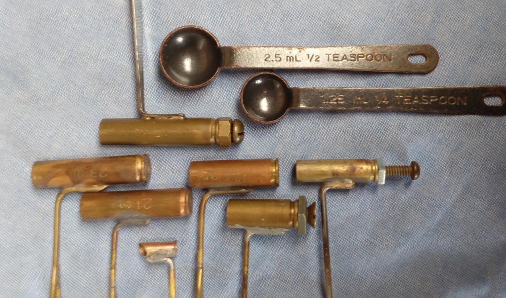

Post by Oldbloke » 20 Sep 2016, 8:07 pm
I weigh every charge. I use a home made dipper/scoop. A copy of the lee. I have a few now, just make them as I need them out of empty cases. One is adjustable with a screw in the primer pocket. :)

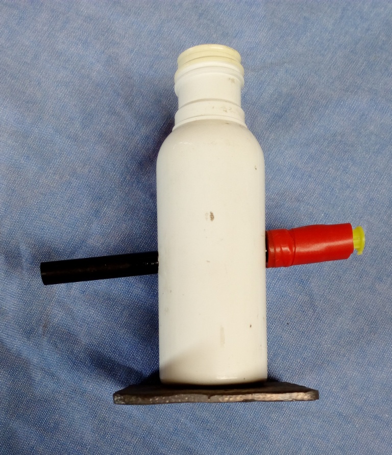

Then I use my home made trickler to weigh on an old set of redding powder scales. Its slow but works for me. A trickler is very easy to make. I made mine out of a plaastic pill bottle.
The trick with the scoops is to level them with a small piece of paper.
Re: Your process - powder measures/throwers/auto chargers, e
Post by Oldbloke » 22 Sep 2016, 3:03 pm
Just thought I would post some pics of my dippers. Some are adjustable for volume by having a screw in the primer pocket. One is 3/16" whitworth and a couple 1/4" whitworth" I think. System seems to work.
Also home made trickler. Just a pill bottle with 2 holes drilled at the appropriate height. One slightly higher than the other. A piece of lead sheeting fixed to the base to give it some stability. The tube is a piece of hollow fiber glass from an old fishing rod but any tube about 1/4" in dia would do.(perhaps an old biro?) Insulation tape to act as a stop and a small hole drilled/ground into the tube to pick up the powder grains.
The best recommendation is to copy. So I copied Gwions tiny 22 dipper idea. :}
Various DIY dippers
Dippers sml.jpg (321.1 KiB) Viewed 9337 times
DIY Trickler
Trickler sml.jpg (353.14 KiB) Viewed 9337 times
DIY Trickler disasembled
Trickler 2 sml.jpg (228.8 KiB) Viewed 9337 times

That's fantastic, oldbloke! I like the measuring spoons, think I'll have to see how much ar2208 they hold and some may go missing from the kitchen. The variable scoop is very neat too.

Post by Gwion » 22 Sep 2016, 3:44 pm
Might use that trickler idea! :thumbsup:
