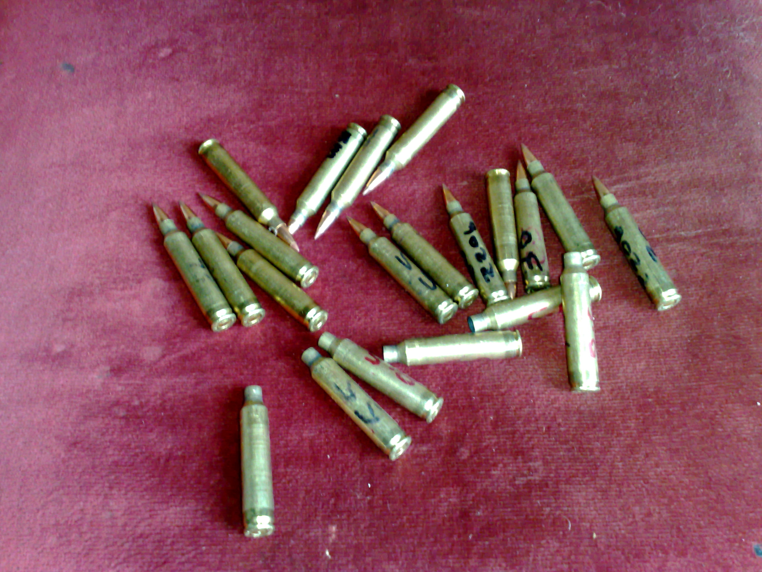

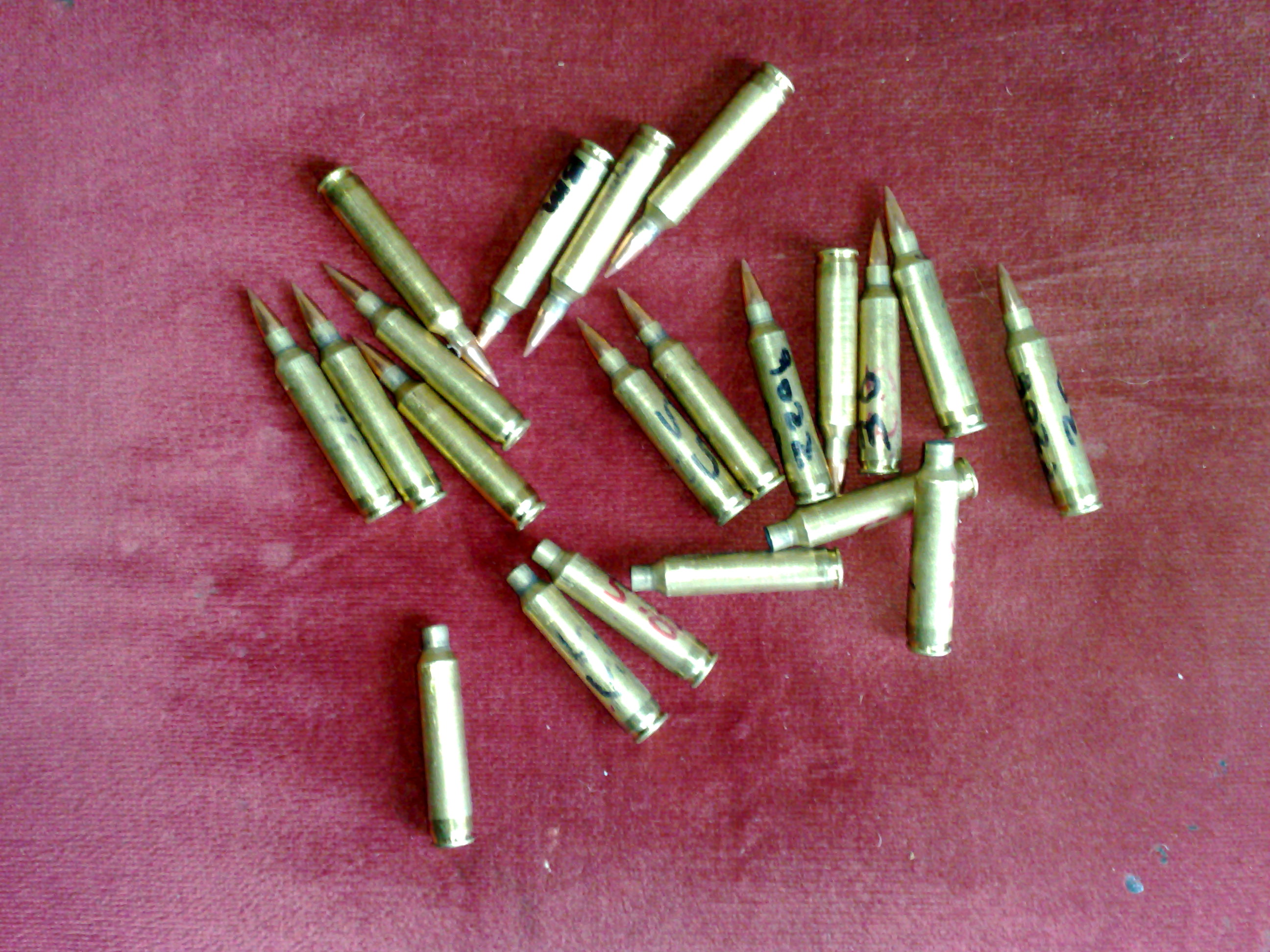

I would guess I inspect them the same way you do. Maybe your brass gets a hell of a lot flithier than mine does but I have no problem watching the pressure ring and measuring the case heads.
Some of mine are into the dozens.
This is probably my most used brass for the .204, some are well over two dozens loads. Never cleaned and never full-length sized.
I don't throw my brass around though, I endeavour to catch them at ejection, not always successfully, but they rarely get near dirt.
My 9mm IPSC brass was almost black after dozens of loads, I still have some of it.

It looks like you might have "clean skin" meaning there isn't a great deal of tarnish on those cases. Some I have seen from people who are not the same, the cases are extremely dull and tarnished just from handling with their hands.
Some just don't care.
BTW There isn't much sign of carbon around the necks so you must have a good load, with a good seal in the chamber. Or, you wipe the carbon off before it hardens.
Some of my cases well over 12 reloads....

Post by bladeracer » 22 Oct 2016, 5:58 pm
Apollo wrote:It looks like you might have "clean skin" meaning there isn't a great deal of tarnish on those cases. Some I have seen from people who are not the same, the cases are extremely dull and tarnished just from handling with their hands.
I don't spend a lot of time fondling my brass :-)
But my handling is usually enough to almost remove any texta I might have marked them with by the time I have them reloaded and ready for new markings. Maybe every tenth round I might have to have a bit of rub with a thumb to remove the last bit.
Light 2400fps loads are sootier but still not too bad, those are 4400fps 24gn loads. Remington .22 Cyclone is the filthiest ammo I've seen in a long while. that stuff comes out coated in soot.

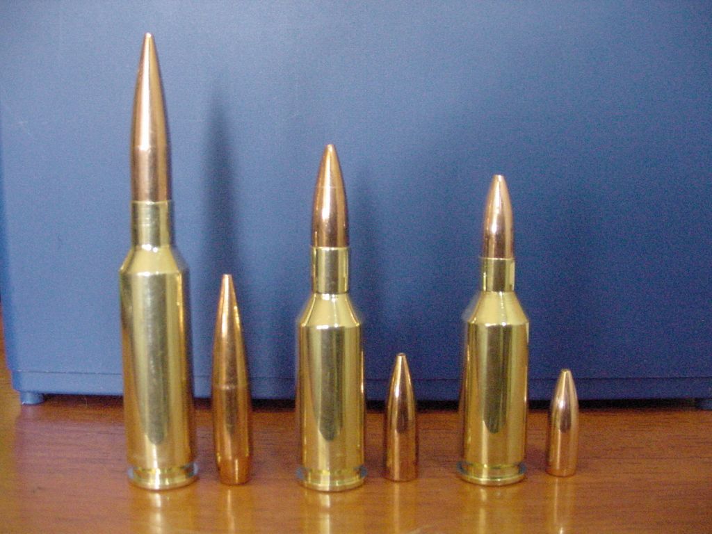

Sorry to go off topic but you have inspired me to dig out my Sako 85 .204R that hasn't been shot for years and remembered I have a couple of hundred Nosler CC Cases that haven't even been opened yet.
I mainly did use a Sako S491 .22BR, the right hand case pictured above.

Left to right, from memory. 6.5x47 Lapua 130gr Berger VLD, 6mm BR 68gr Berger FB and 22 BR 52gr Berger Varmint... I think.
Nosler Custom Competition, if you didn't know are fully prepped, weight sorted Norma Cases. Expensive but great as it takes out the idea of a whole lot of cases that are quite different to the norm. My .204Ruger I haven't used much, have Federal & Hornady cases as well but they just aren't in the class for consistant accuracy.

Firstly, on topic. I clean all my cases and polish to a virtual mirror finish and keep them that way. I will not run dirty cases through my dies. If I had field cases that are not clean I would deprime with a universal deprimer then clean before they go anywhere near my normal dies. I don't clean every reload, it depends on what condition the cases are in but if and when I clean they go in the ultrasonic first, then dried, then in corncob tumbler for hours. Finally they are wiped to remove any dust etc whilst I study each case to look for faults.
