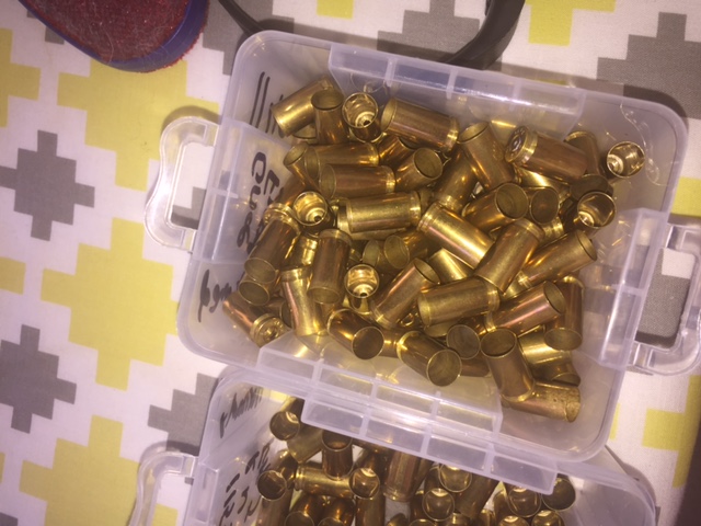

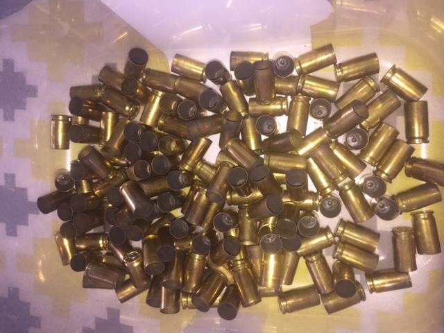

Before
After
Ok so its not a tumbled, shiny new brass look but i think they will do for reloading and i can see if there is any issues with the cases. I tossed two that were cracked.
