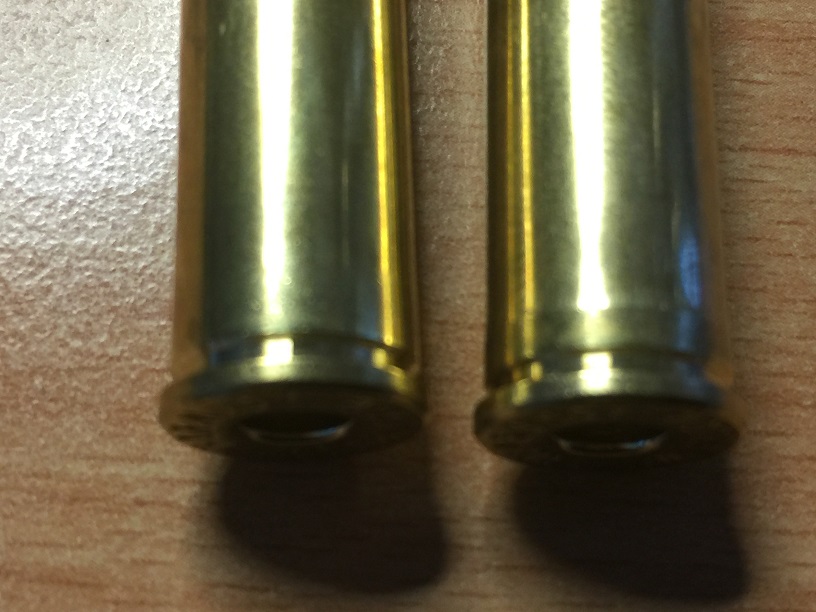

I purchased a Redding Titanium 460 S&W Mag die set from Sinclair International in March this year and only recently used it to reload some cartridges. I noticed when full length resizing that there’s a distinct bulge in the base of the case approximately 0.190” from the base. I use a Dillon XL650 and managed to resize just over 200 cases before noticing the problem. I bought a Lee die se today (Thanks Zhen) and using 2 brand new Hornady cases I put 1 through each die taking measurements before and after. Measurements are listed below and both cases started with identical measurements. Attached picture shows the case resized on the Lee die on the left and the Redding die to the right, notice the distinct rim.

I suspect something isn’t right with the Redding die set and returning it to the U.S is a pain in the ass but i'll see what answers come back to the email I sent Redding. The cases still chamber but a 200gr projectile with 45.5gr of AR2205 up its backside I don't want to chance a separation,“especially” in a revolver.

Have you got a clearer pic?

That picture was the best of a bad bunch, difficult to capture the bulge on the right angle to make it standout. I think the die is a few thou tight and over squeezing the case which explains the bulge and growth in length. I've emailed Redding and I'm curious as to what they come back with, I've got a few of their die sets and they've always been good.
Re: Redding 460XVR FLRS Die Issue
Post by darwindingo » 03 Nov 2016, 10:14 pm
That don't look good at all :wtf:

Yep, the numbers say it's a bit tight.

Is it "bulging" or is it taking the case walls down to a smaller diameter than the thicker web at the base. I have RCBS .44mag dies that do this. P.I.T.A and looks sus' but have reloaded the cases dozens of times with no worries. When I seat the bullet the round has an "hourglass" look.

I have some similar, but less pronounced marks on my cases. Eager to know more..
The second description by the look of it, case smaller then webbing + case length growing. After firing a few that were on the warm side, I'm concerned enough about the thickness that I'll write these cases off as "Educational" expenses. The Lee die works perfectly fine and cases look perfect after a FLRS so I'll put the Redding's back on the shelf or maybe I'll give the neck sizing only a try.
