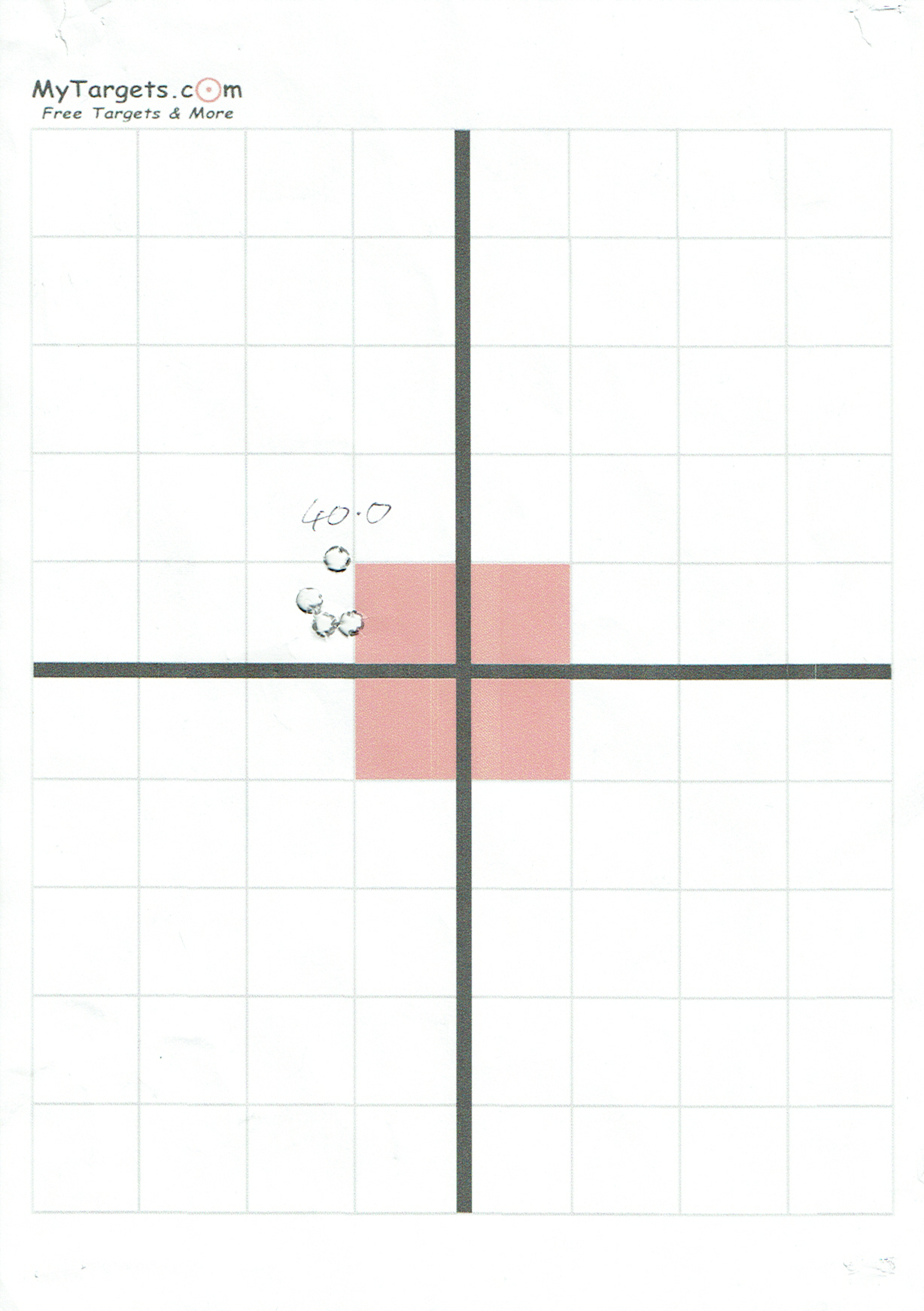

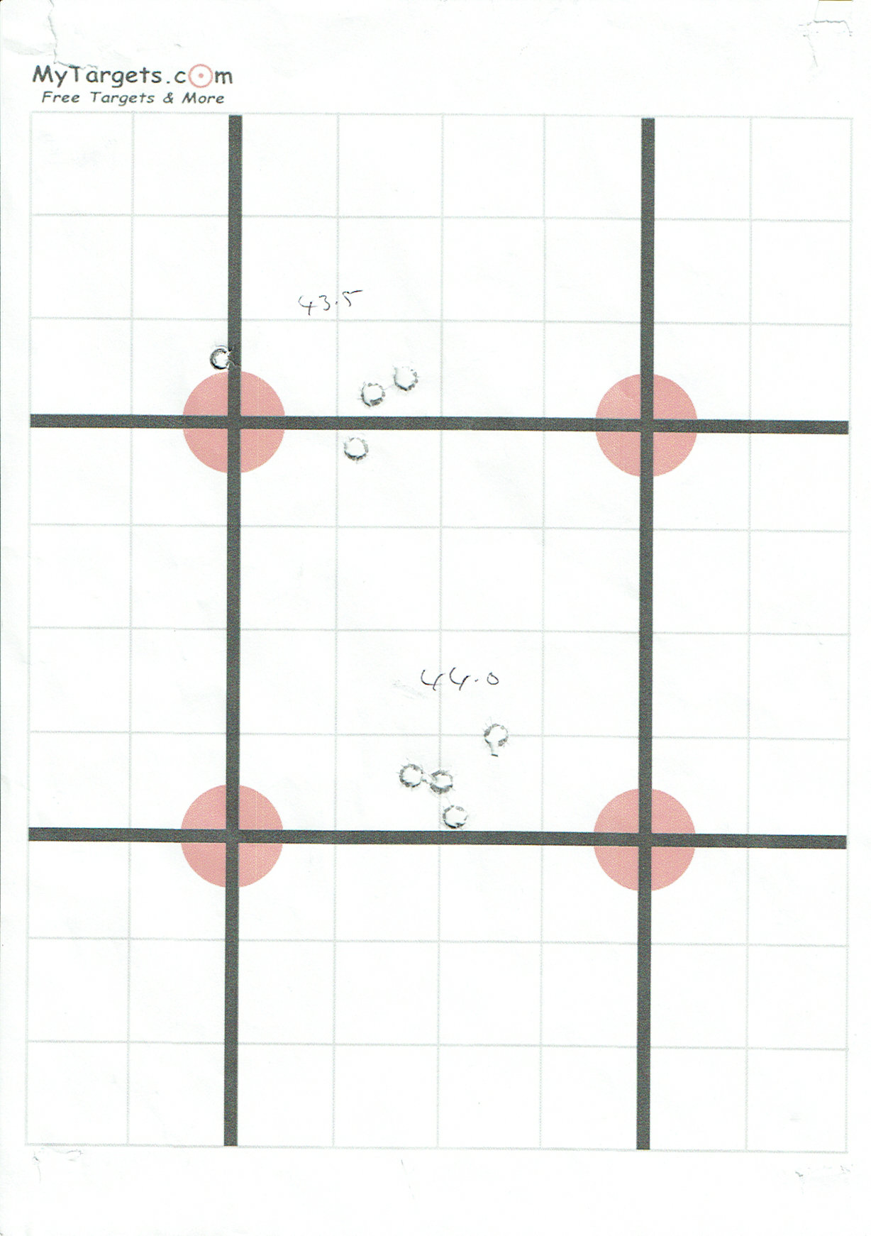

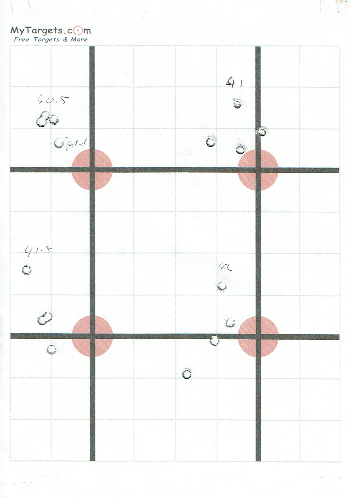

Here are my four-shot groups @ 100m. The first group is my first-ever handload!
It was a gusty day with a 15mph left-right crosswind at times:
So the most accurate load appears to be between 40 and 40.5gr and I have made some further test loads @ 40.3, 40.5 and 40.7 to find the sweet spot.
The 42.5 load is not bad, either, and I now have some 42.3, 42.5 and 42.7 loads to try, as this might be the best compromise between velocity and accuracy.
However, I was surprised to see my hot loads from 43.5-44.0 were also in the ballpark. This is 2gr over ADI's max load and there were no signs of pressure. Do you think I should continue to work this load, say 43.8, 44.0, 44.2?

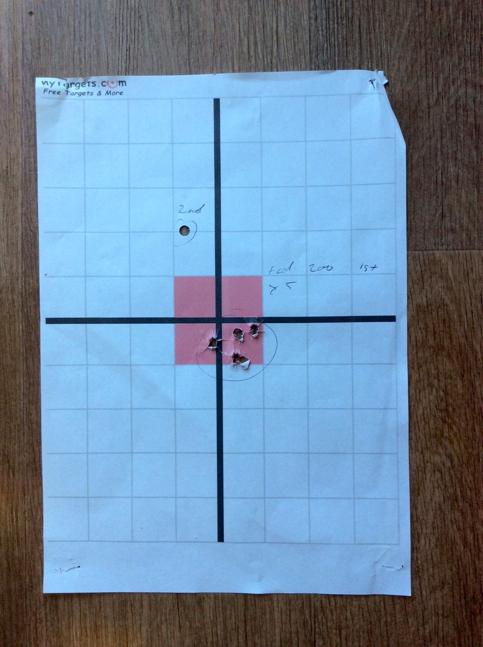

Been having a few issues with the Sako wandering in its stock.
Here's what it did when I first got it shooting factory Federal Power Shok 80gr soft point. This was a five-shot group at 200m. Note the flier top left. I thought "nice -group - shame about the flier" and put it down to user error.
But then the same flier started showing up again and again in my groups - in exactly the same spot. Sometimes it was the first shot. Sometimes the second or third or fourth shot. There seemed to be no rhyme or reason.

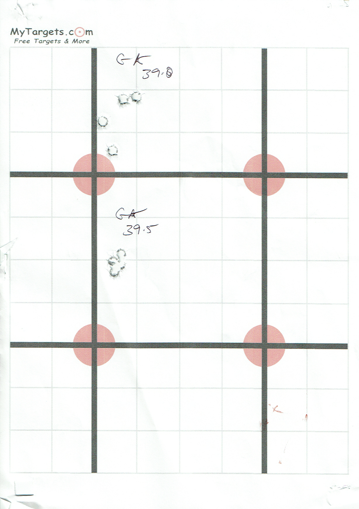

Here are two 5-shot groups I shot yesterday at 100m with the 100gr Sierra Game Kings using proven loads: 39.5gr of 2209 and 40.5gr of 2209. Same flier, same spot in both.
It was a gusty day, but you can usually tell when shots are in the ball park.
Also, I have many other groups that look the same - 3 or 4 shots in a ragged hole, with a random flier, top left.
I've had a look at my rifle and the Sako 85 bedding system - with two recoil lugs - seems overly complicated and prone to lateral movement. I've tried different torque settings on the action screws to no avail. I even emailed the factory and they responded with the correct settings: 35 in/lb front, 25-30 in/lb rear - though I have tried 30-45 in/lb on the front. Sometimes I notice the barrel sitting further left or right in the stock after shooting, even with the action screws done up fairly tight.
I've ordered some pillars and am just trying to figure out how to bed it. It's a nice rifle and shoots straight when it wants to, but the propoensity to wander is doing my head in!
