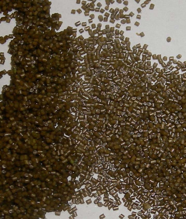

Hi guys,
I was wondering if anyone has had a similar experience as me (read - "has stuffed up like i did") regarding contamination of powder.
I was cleaning up some dirty 44 mag brass and used a petroleum based degreaser from Bunnings as a final cleaning step as this is what I had on hand. - i left the brass ~1/2 day to dry before reloading and they looked and felt dry at the time.
For the reloads, I lubed the projectiles with a squirt of Liquid Alox and left them to dry for 24 hrs (still a little tacky at time of reloading).
Proceeded with reloading which was a combination of new brass and old brass with AR 2205 (the old brass being the degreased stuff and kept separate from the new when loaded).
When firing, the new brass went fine. The old brass provided erratic results and no where near the loads in the new brass.
I kept a couple of each type (new brass / old brass) and pulled them apart when I got home.
The powder from the new brass looked light in color and dry like powder straight from the tin. The old brass powder looked decidedly darker and clumped together additionally there was a yellow residue inside the case. Photo of powder is attached - the darker is from the old cases.
I ignited the collected powders from the cases and there appeared to be no difference in the way they burnt.
My thoughts are that there was residual degreaser (and maybe Alox) in contact with the powder and this somehow - Harry Potter Magic - contaminated the powder and interfered with its burning.
Has anyone come across this before?

DaleH wrote:I ignited the collected powders from the cases and there appeared to be no difference in the way they burnt.
Burning it maybe not, under pressure though I expect it's a different story.
The powder on the left almost looks like it's wet... Way more than I'd expect from some residual lube.
That's definitely the only source? Couldn't have been a bad tub of powder that got left open/somewhere it shouldn't have been?

Norton wrote:The powder on the left almost looks like it's wet... Way more than I'd expect from some residual lube.
That was my first thought too.
It looks like it's soaked through, not just picked up a little around the outside of the brass.

DaleH wrote:My thoughts are that there was residual degreaser (and maybe Alox) in contact with the powder and this somehow - Harry Potter Magic - contaminated the powder and interfered with its burning.
That would have been my thought too but like the guys have said, that seems like a lot more than just 'residue' ?

Post by DaleH » 27 Nov 2013, 10:23 am
Thanks for the input guys.
Just to confirm, the powder was from the same tin and the clean cases were loaded first and then I did the degreased cases all out of the same load in the powder thrower.
This weekend i am going to re-wash the cases and and rinse in hot soapy water, dry them in the sun (this means "oven) when the Mrs isnt around) and then reload and try again.
I will also do a bit of "CSI" work to see if I can replicate the effect out of the case. Will let you know how I get on.

Post by DaleH » 01 Dec 2013, 11:58 pm
Just a follow up guys.
contamination was due to degreaser residue. Whatever it was, there was enough to also effect the operation of the primers. I emptied the cases, cleaned off the projectiles in boiling soapy water, dried them and reloaded with fresh powder - erratic results - looks like the byproducts of the degreaser and powder either got into the primer hole and partially blocked it or interfered with the primer operation. Go a missfire on one of the reloads. Disassembled and tried to set off the primer in the rifle and by igniting powder in the case to no avail - looks like it well and truly stuffed the primer.
Note to everyone - do not use the red degreaser that you can get from Bunnings - if you do, wash everything in hot soapy water before use.

Post by DaleH » 03 Dec 2013, 9:59 am
Was definitely the degreaser I used.
I pulled apart more of the reloaded cartridges and they were all the same - some of them so bad that the flash hole was blocked up with yellow gunk (one of the primers would not go off at all).
Cleaned the projectiles and cases (hot soapy water this time) and reloaded with fresh primers and powder (same batched as I used previously) and all fired fine with good velocities and not erratic like the last batch. So the only thing changed between this run and the last was the degreaser.
