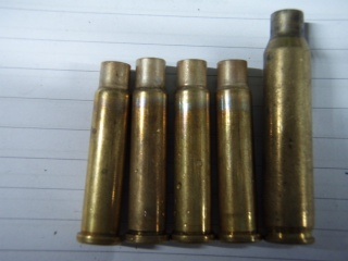

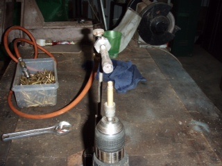

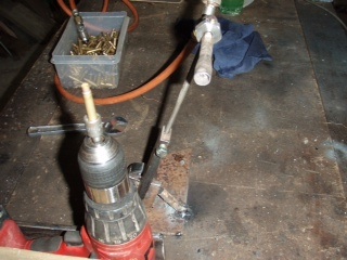

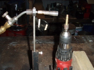

This is my annealing jig that I made awhile back. I tried the "cases in a pan of water" method but found it inconsistent and slow. I tested the jig with a couple of dead cases to get the timing right and then away I went. It is adjustable for height, speed, burner temp and distance away from burner.
Once going I did over 200 cases in less than 30 min. Now that I have made it, I will not need it for a couple of years, hopefully. I just screw it to the bench and it is rock solid stable and so I get repeatable results.
Please remember that the neck needs to be only a very faint red and not cherry red. Cherry red will make the necks like butter, effect the metalurgy and the heat may go to far toward the head of the case,making the head soft. I used Tempilaq paintball to monitor the heat transfer to the head of the case. For the timing I used My wife's metronome that keeps time when she plays the piano.
The cases were flicked into a tub of water just to keep it safe in the darkened shed. I wired down the trigger on the drill so that the chuck was doing about 100 RPM. The case holder is a tech screw driver. I just selected one that best centred the case. As the driver is shallow you can put a new case in without stopping the drill. The burner holding Assy has a physical stop so that I can index the burner away from the drill chuck area while flicking the annealed case into the water and fitting a new case. I then index the burner Assy back to the heating position for the correct count.
The heating position has a spring loaded ball bearing that locates into a detent to hold the Assy in the heating position. I think I may re-engineer that bit as the physical stop appears to far more solid. Maybe an adjustable physical stop would be better!
I could not be happier with the end results. That's a 223 case for size comparison.
What I really like is that it was made out of junk and equipment that I had in the shed. It cost me a bit of power, my time and one electrode. I over engineered the pivot for the arm and would keep it basic if I was to re do it.
Finished product
Indexed away from heating position
Indexed to heating position

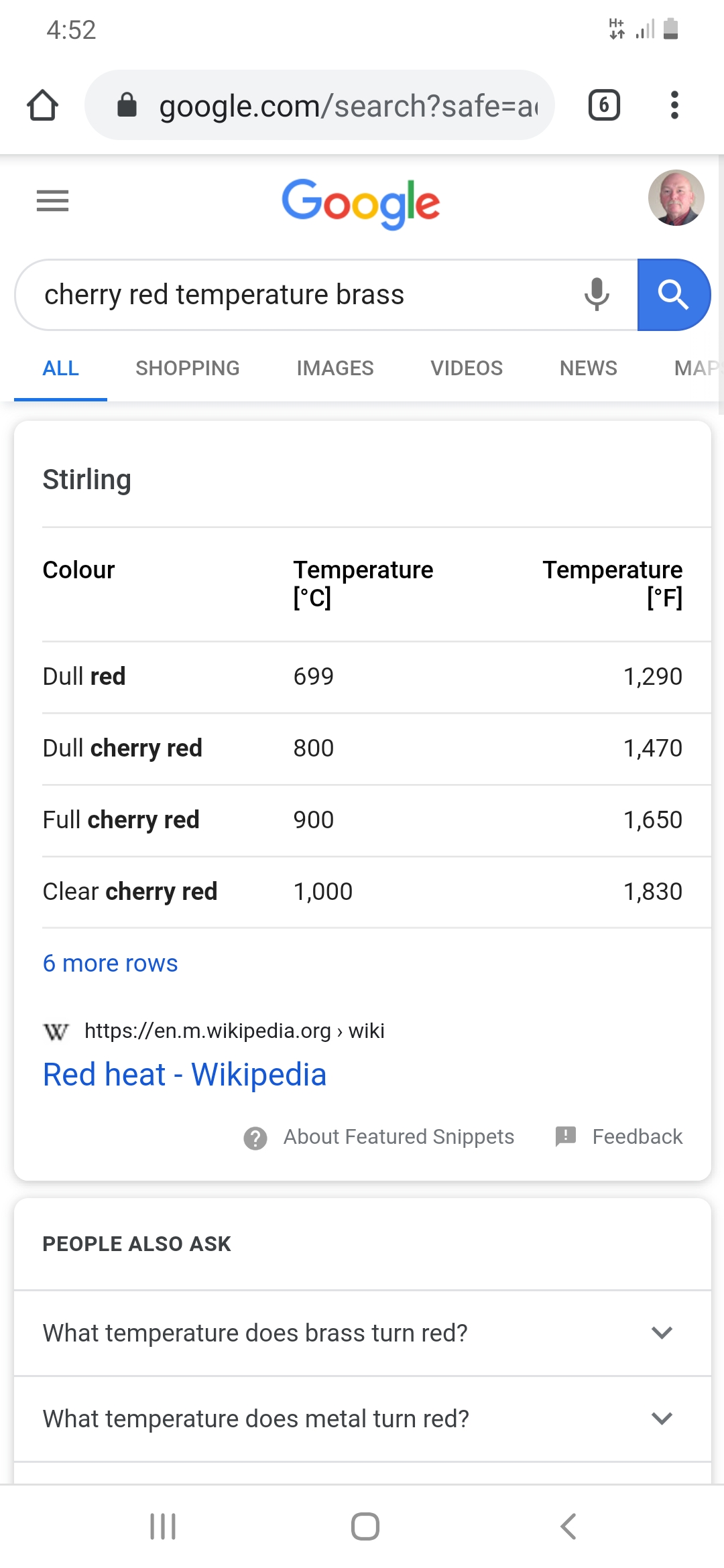

However, interested in the idea of annealing in lead. As lead melts at about 327c I would not have thought it would be hot enough. I understood you needed to achieve about 420c to anneal brass quickly.
Here is some intere sdting reading.
http://www.massreloading.com/annealing.html
BTW. if you see the brass even slightly turn red u are way too hot if your doing it with an lpg torch. Should be just bluish.

Post by Oldbloke » 11 Apr 2020, 4:58 pm
Brass Red.jpg (337.53 KiB) Viewed 14061 times
