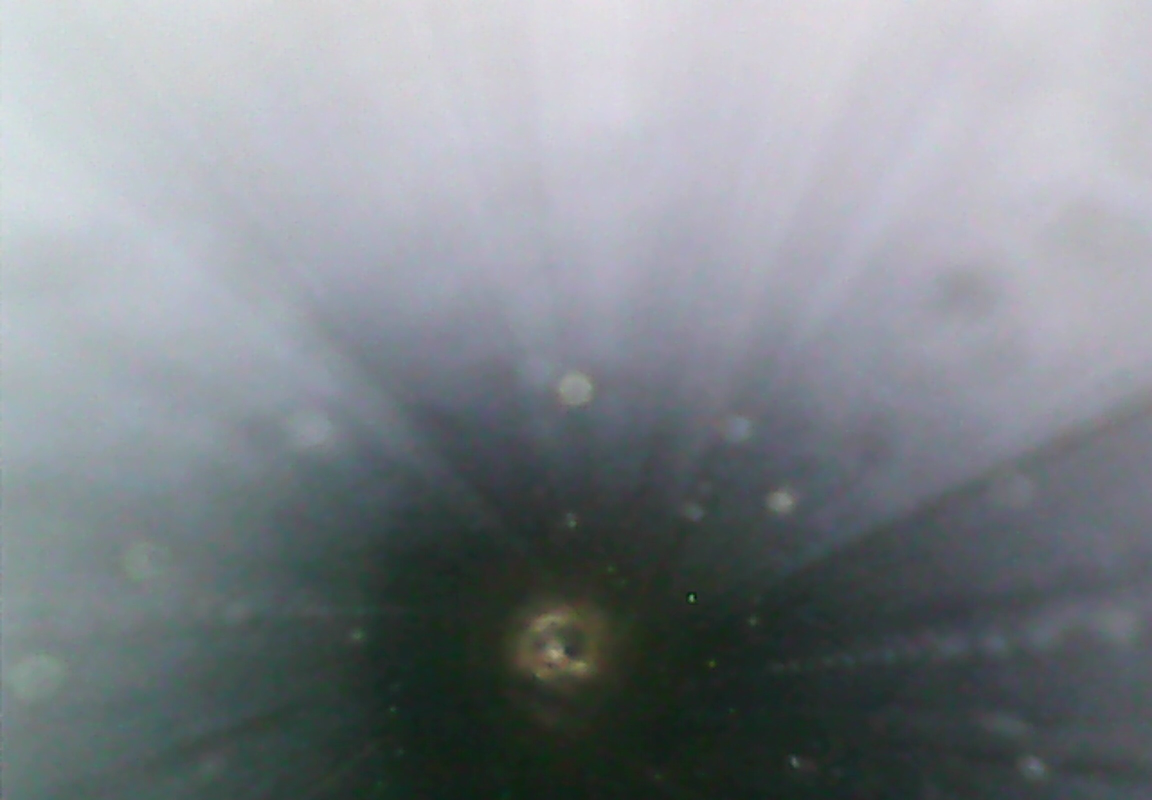

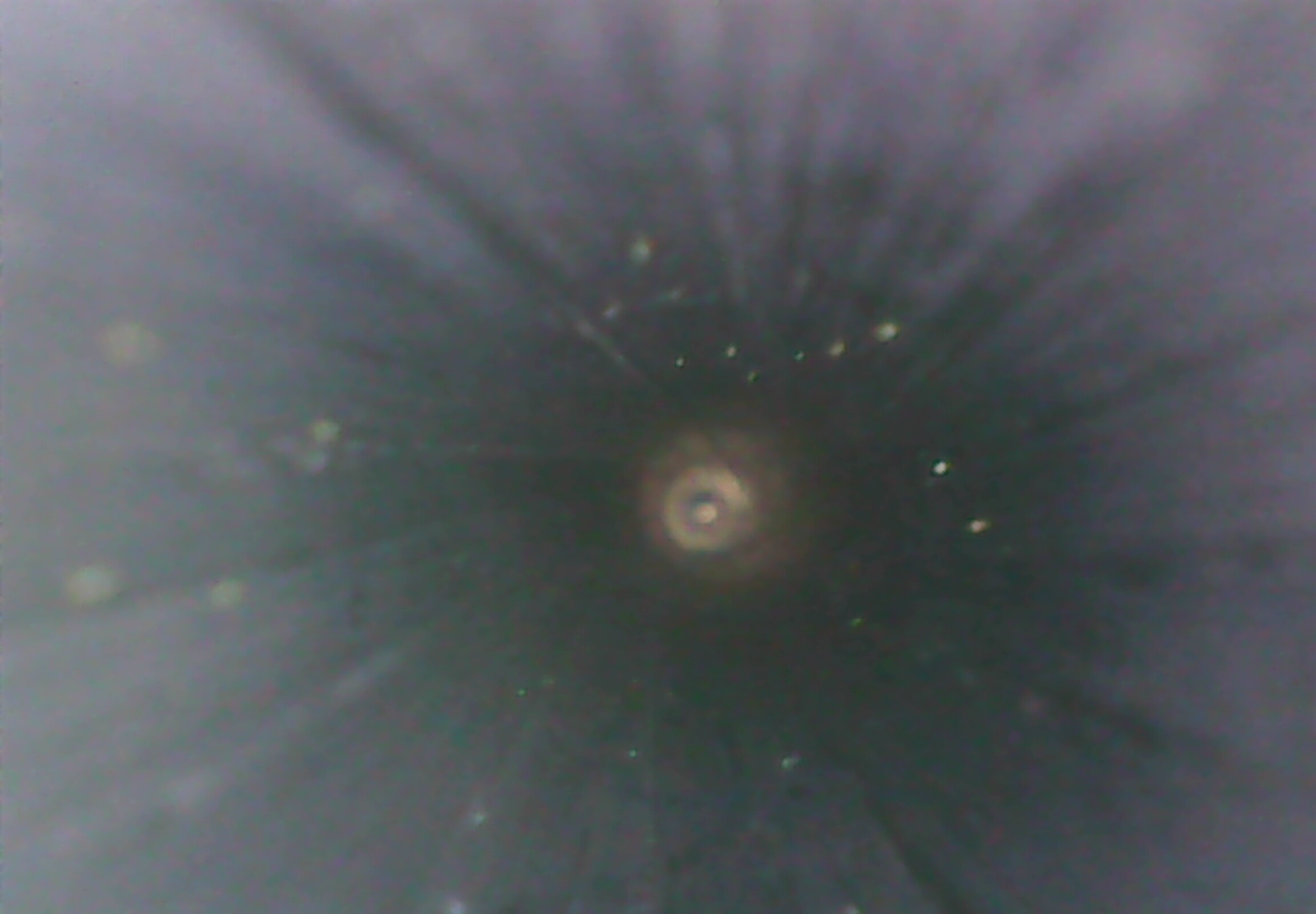

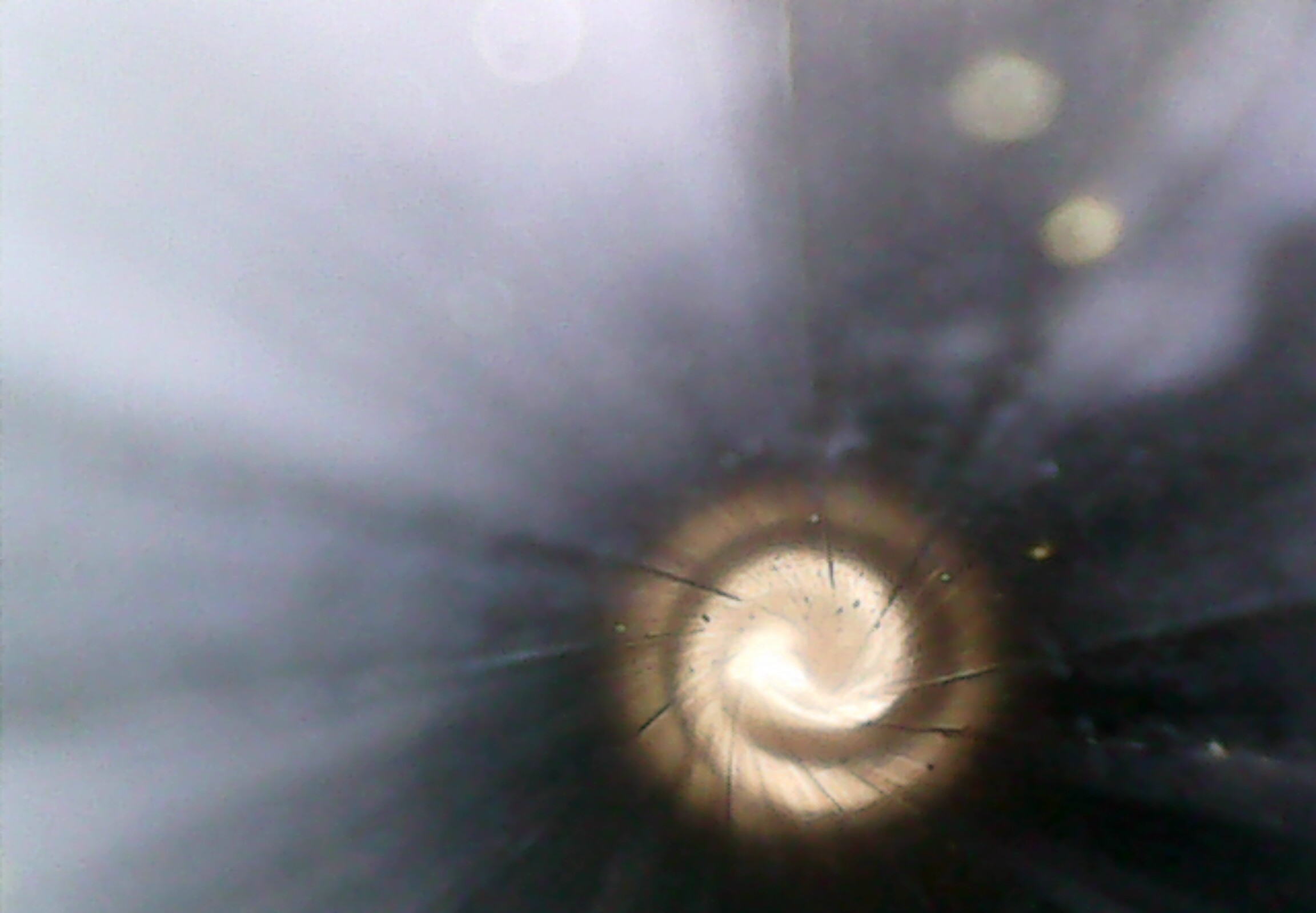

Post by petemacsydney » 20 Nov 2017, 12:24 pm
wow bladeracer, 18" @ 50M !!.
mines new and has the 20” barrel with deep-cut Ballard-type rifling (6 grooves). not sure of the difference tbh.
she seems to scrape a hell of a lot of copper off though!
here's the results after 50 rounds... not sure if this is normal copper build up or not as only just got my bore scope.
(american eagle factory 240gr
_________
petemacsydney
Posts: 623
