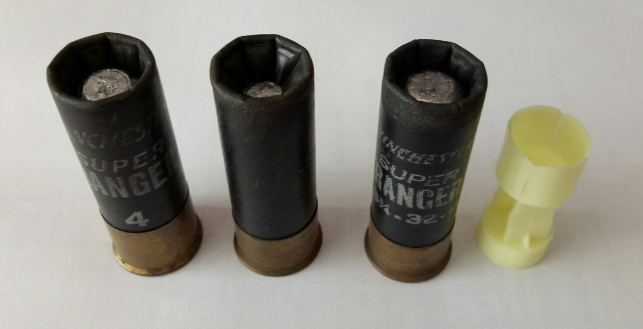

Started to load some Lee 1oz slugs today. Wad Collum is not right obviously. Is difficult to crimp then goes too far. I'm using a 1oz wad. Any ideas?

bentaz wrote:Fill the wad with discs of cardboard until you can get the slugs to sit at the right hight
Tried that. Perhaps a bit more experimenting is needed. Must be more critical than loading shot.

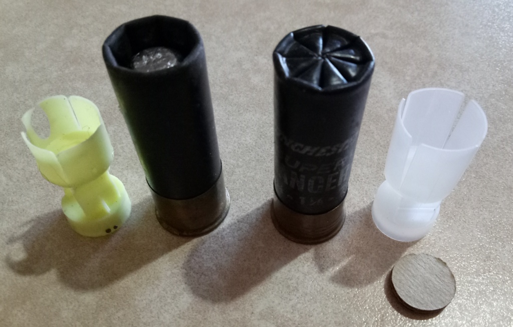

I think the wad collapsed when crimping due to slightly too long a wad collum .
Will cut one open and have a look.
If this is correct I think the fix will be 32 gram (instead of 28 gram ) wads with cardboard ones to get it just right. Might have a look after work.
Re: Lee 1 oz slug load problem
Post by Oldbloke » 27 Mar 2017, 6:04 pm
Looks like the wad has collapsed. Perhaps a combination of cheapo wad and the wad being a tad too long. The powder load is far from high, so not that.
I will try a 32 gram wad at the weekend and see how that works. I may need 1 or 2 cardboard wads under the slug and trim the fingers a bit but should work then.

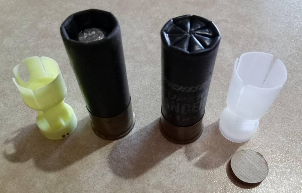

Just a follow up. I seem to have fixed the problem. The original wad column was a bit too long and when I crimped it the wad collapsed. It was essentially forced down in order to crimp.
I have now used a 32 gram wad which left the projectile a tad too low. (Lee recommends prior to crimping the slug should be 7/16" from the top of the shell)
I trimmed the petals about 3 mm and placed a cardboard wad under the slug to get the height just right. (slug is now 7/16" from top of shell) Result nice crimp. :thumbsup: Each load was 21 gr AS50N
Load with 32 g wad.jpg (222.74 KiB) Viewed 12247 times
Moral of the story. Read the instruction manual. ;) I will now load up a few over the weekend to test.
