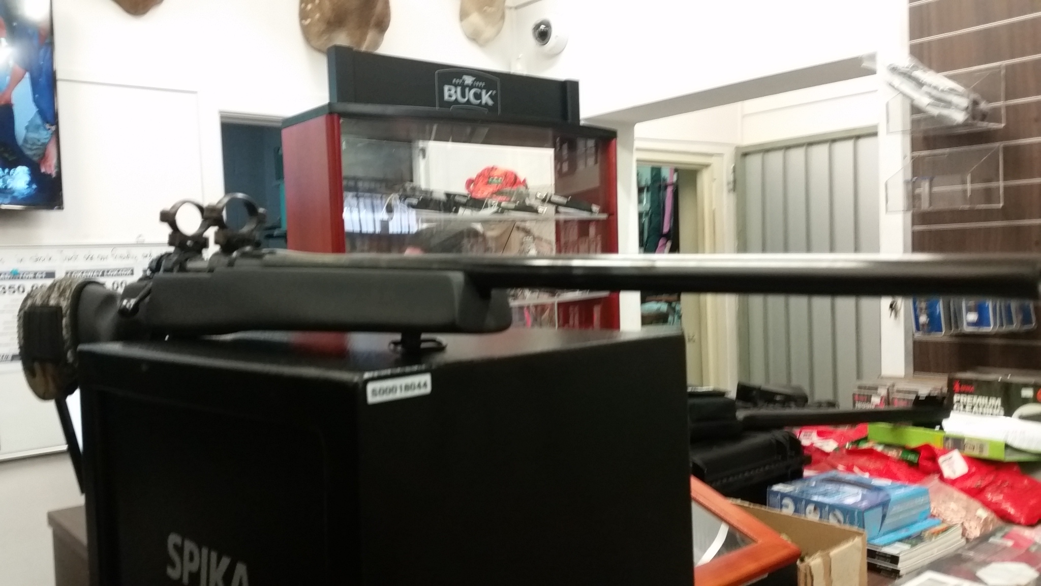

I would really appreciate some advice to correct an inaccurate secondhand rifle I just purchased.
So I was in the gun shop the other day and saw this ugly looking thing in the corner for $350 and thought to myself; self, that POS might just fill a role to get a younger family member more trigger time without the cost of a .308. So I bought a Yugo Zastava .223 which started life as a .222. From what I have learned on the interweb, these things are fairly accurate despite their flaws. It looks brand new to be honest but Yugoslavia has not been a nation since the early '90s so it proclaims its age stamped on the receiver.
The Zastava M85 was topped with a brand new Leupold VX1 3-9 and off to the range today. I had a couple packets of PPU 55gr chucked into the deal and I also had some PMC 55gr too along for a shot.
Well, so far, the accuracy has been horribly disappointing. Groups ranging from 1.5" to 4.6" @ 100m; seemingly worse as the day progressed.
I know I have a number of variables to eliminate here but would like some advice on the load I should be using. I mean here are the unknowns:
