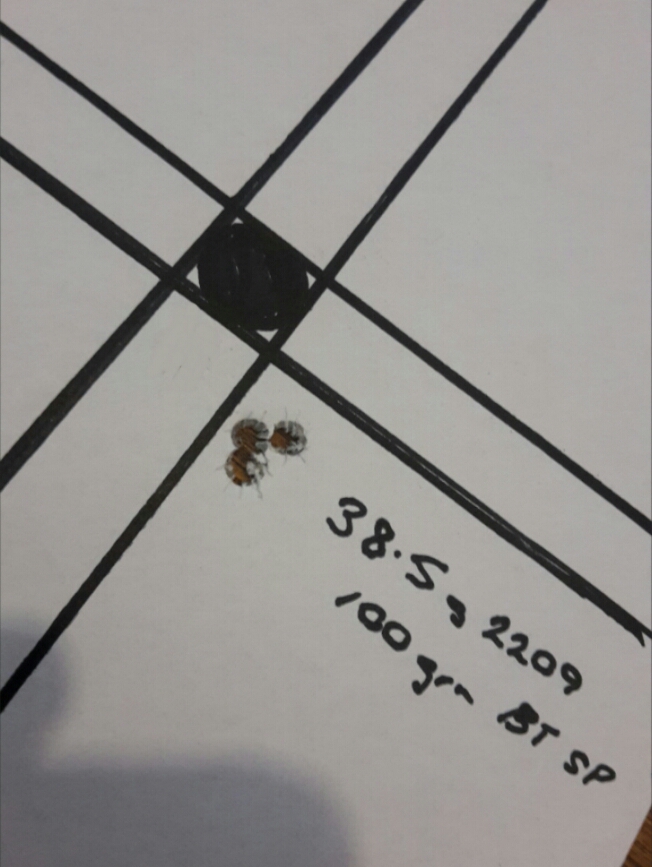

pomemax wrote: How was it on paper did you record similar just because the calculator says what was the gun saying no 2 are the same now you have a start for you ammo do a ladder test and see what the firearm likes.
Yep, all the load testing has been done on both rifles to a point where I'm happy with the grouping.
There might be more precision to be had as I've only tested in .5 grain increments and haven't played with seating depth other than setting my projectiles .25 mm off the lands.
The .223 shoots .5" groups @ 100m and the .243 is even beter
Old .243 target shot prior to me sorting the brass in weight batches.
2017-04-03 09.30.06.jpg (299.26 KiB) Viewed 3158 times
The calculated variations seem to be what I'm seeing in the field. It's just nice to confirm that what I'm seeing is not human error.
