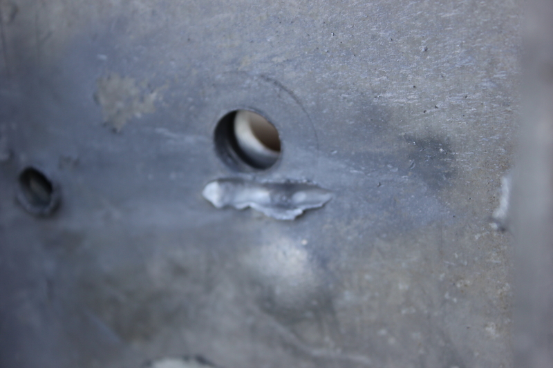

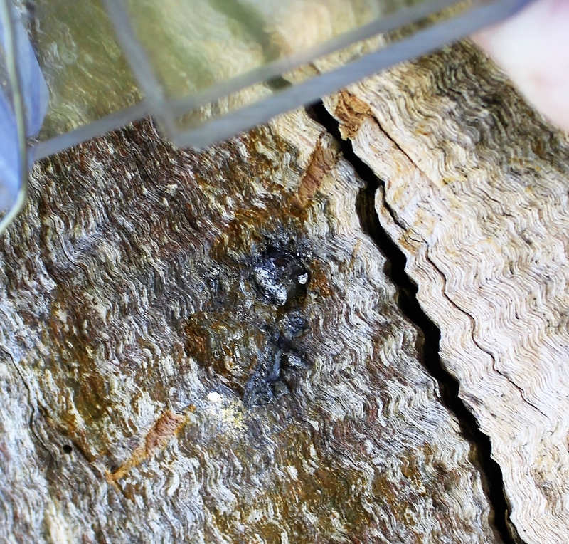

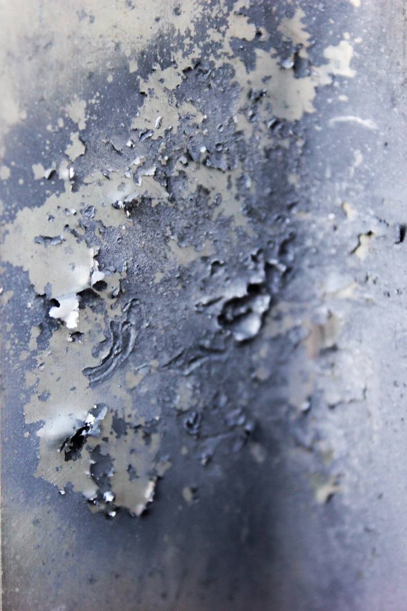

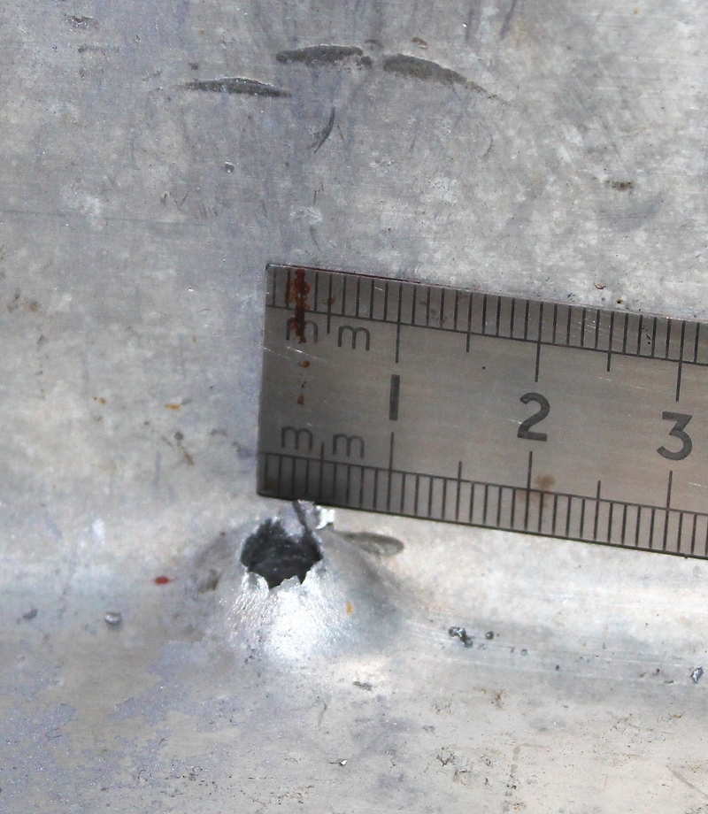

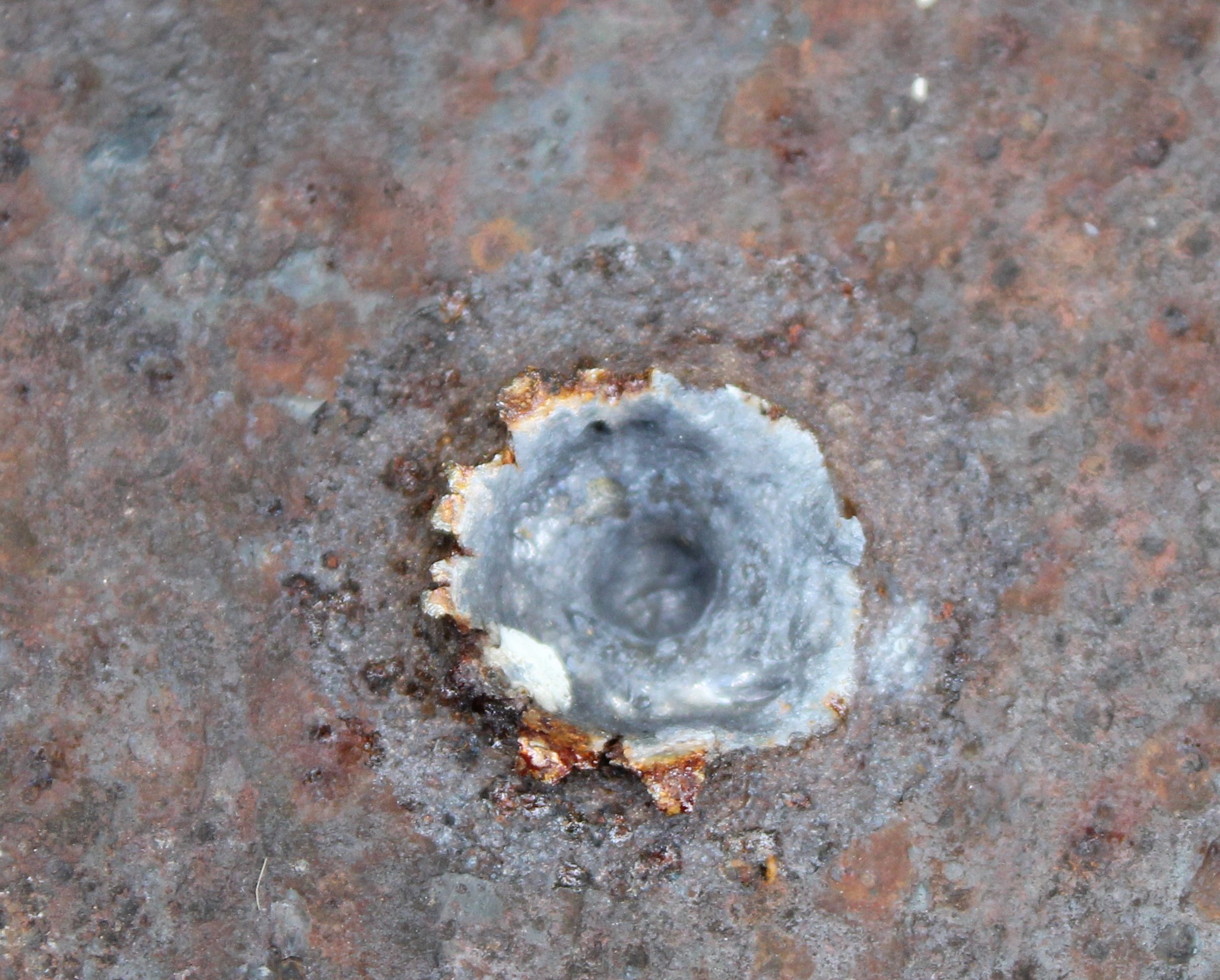

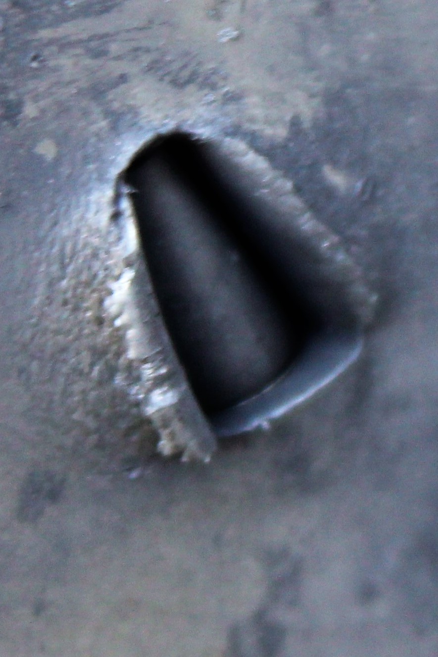

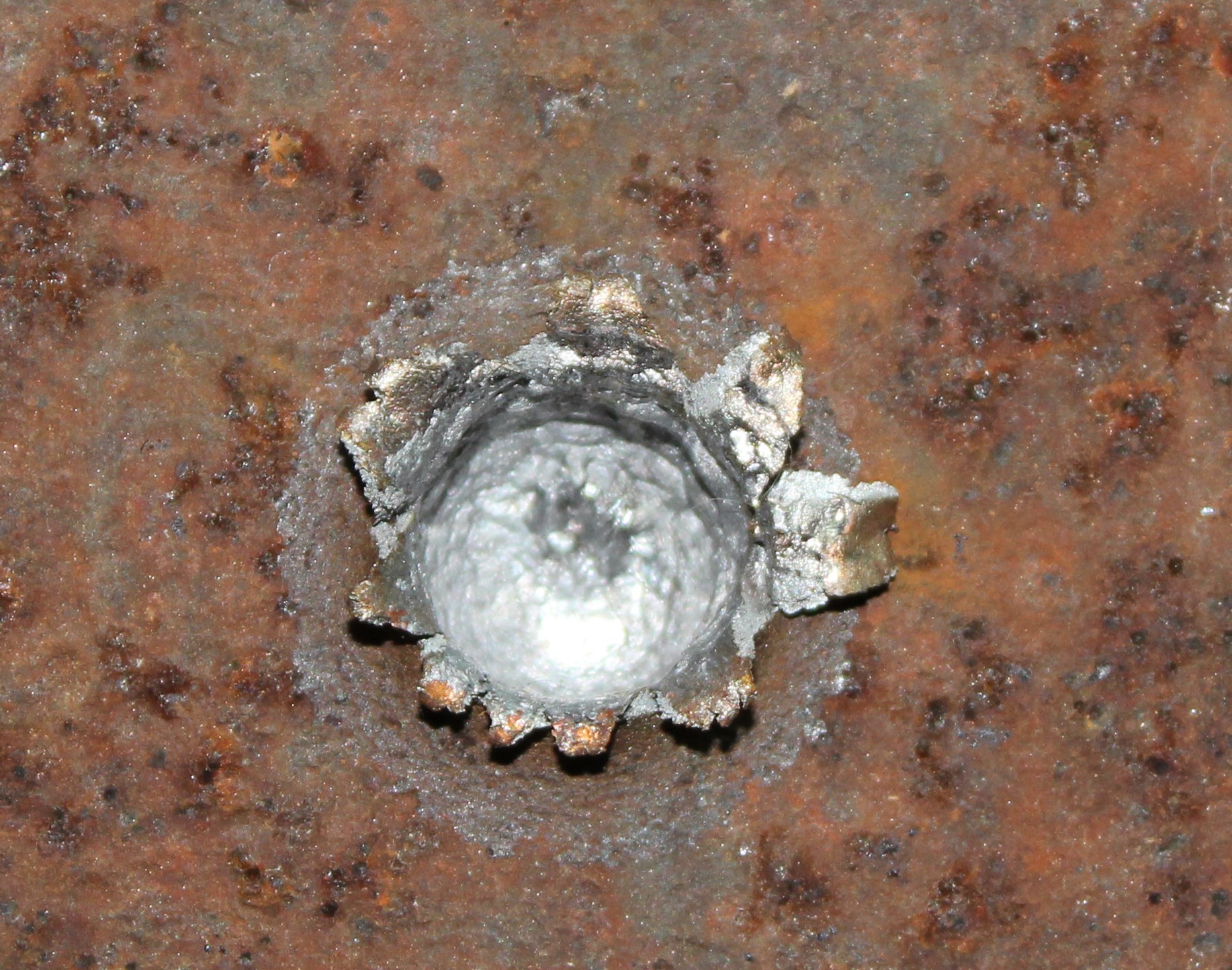

Post by Gaznazdiak » 16 Jul 2017, 6:45 pm
For Duncan 61
Because he asked.
I used a Hornady 68gr BTHP match for comparison.
And some ballistic tips, just because
SS109 penetrator.JPG (236.88 KiB) Viewed 12761 times
Hornady 35gr.jpg (1.25 MiB) Viewed 12761 times
Nosler 50gr.jpg (1.55 MiB) Viewed 12761 times

Post by straightshooter » 17 Jul 2017, 9:16 am
20+ years ago I lucked onto a large quantity of these ADI 223 projectiles. As a consequence I had to fit a new 1 in 9 twist barrel to my mini Mk X mauser and since then they are all I use when a 223 calibre is adequate for the expected game and ranges likely to be 200 meters or less.
These projectiles were developed to be compatible with the NATO SS109 specification, the main requirement being that the projectile retain enough energy to penetrate a helmet at 600 meters. Something the 55 grain projectiles couldn't do.
As a consequence the soft iron tip filler was thought by self styled 'experts' to play a role in enhancing penetration.
That is not the case. One of it's purposes and benefits is to make the projectile unstable when it enters it's target medium thus increasing it's wounding effect while still complying with the Hague Convention. It serves much the same purpose as the aluminium tip filler in MkVII 303 projectiles.
So if you understand that you should realize that there is nothing to be gained by trying to 'soft point' these projectiles, the more likely outcome will be a loss of BC and accuracy.
The purpose of the cannelure is for crimping the case mouth and it is positioned such that the projectile can be seated to a standard COL. Obviously for custom ammunition it doesn't matter. I recall that ADI also made these projectiles without a cannelure for fullbore shooters but they didn't catch on, the criticism being that they were insufficiently accurate.
I developed loads using BM2, 2206 (without the H) and 2208 and settled on BM2 which gave the best results out of my 20 inch barrel.
The projectiles I have look like rejects or seconds of some kind but they still managed to group a little over 1" at 100 yards for a 10 shot group.
I have used them on goats and medium sized pigs with good results and extensively on smaller game.

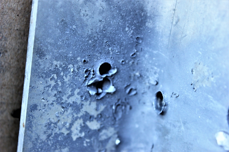

Post by Gaznazdiak » 17 Jul 2017, 2:22 pm
I did notice that at 100m the new Nosler 70gr Reduced Drag Factor BTHP match bullet left a far more authoritative impression on a rail sleeper plate than the 62gr SS109, although you you can see evidence of it's steel cap.
Except for the divot from the cap of the SS109 the Nosler hit was about twice the overall depth.
A digression on the subject of the new RDF projectiles, at 400m in a 15kph quartering wind that moved the 68gr Hornady match nearly 200mm, the RDF were not visibly affected and grouped about 1/3 the size.
Nosle RDF.JPG (715.96 KiB) Viewed 12739 times

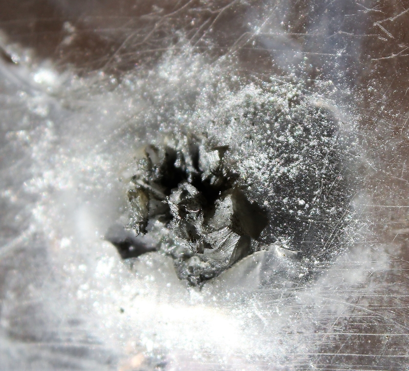

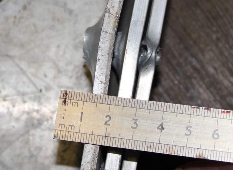

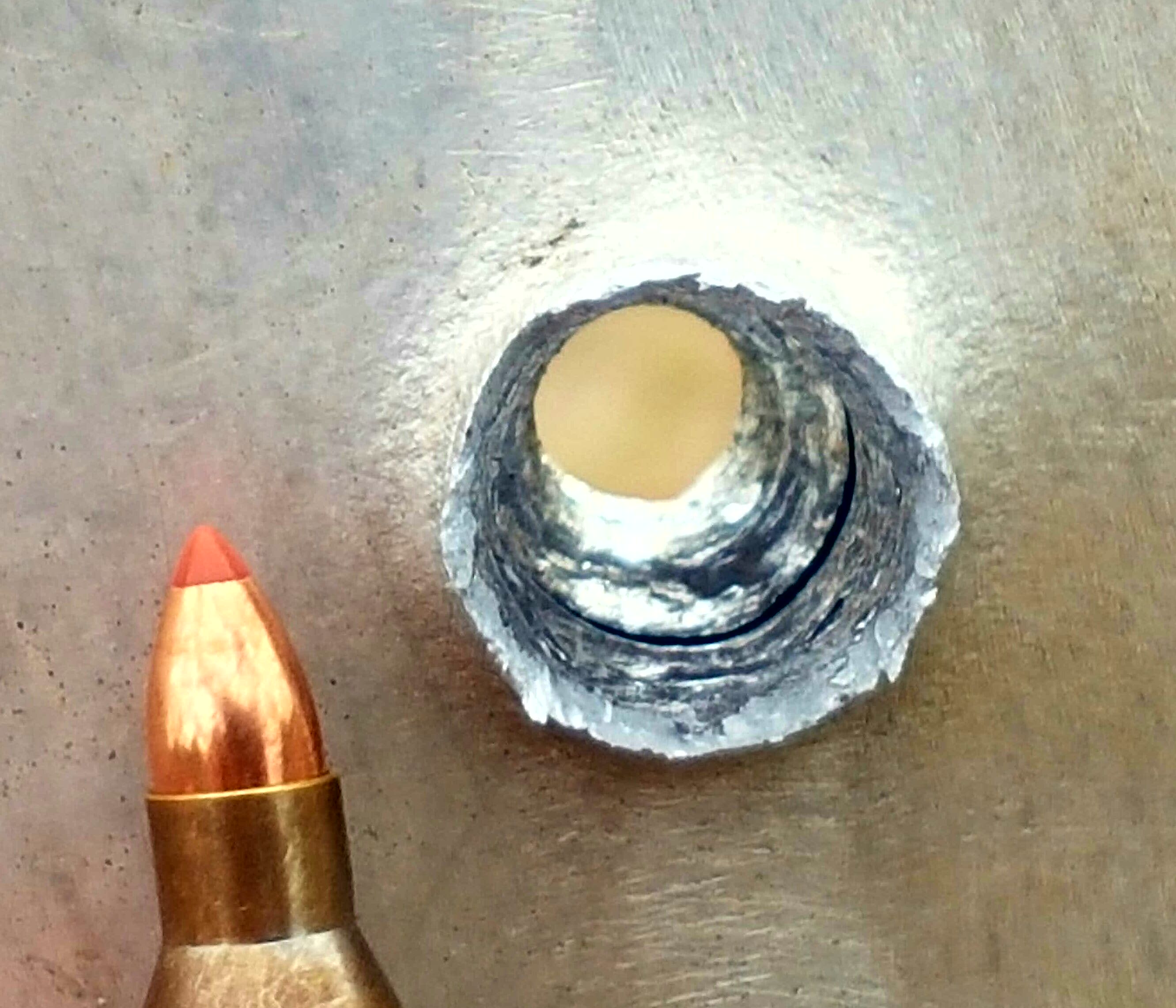

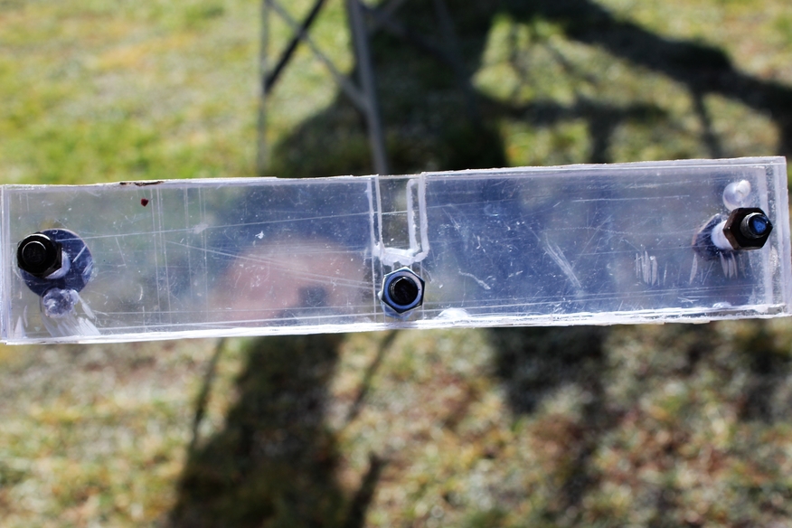

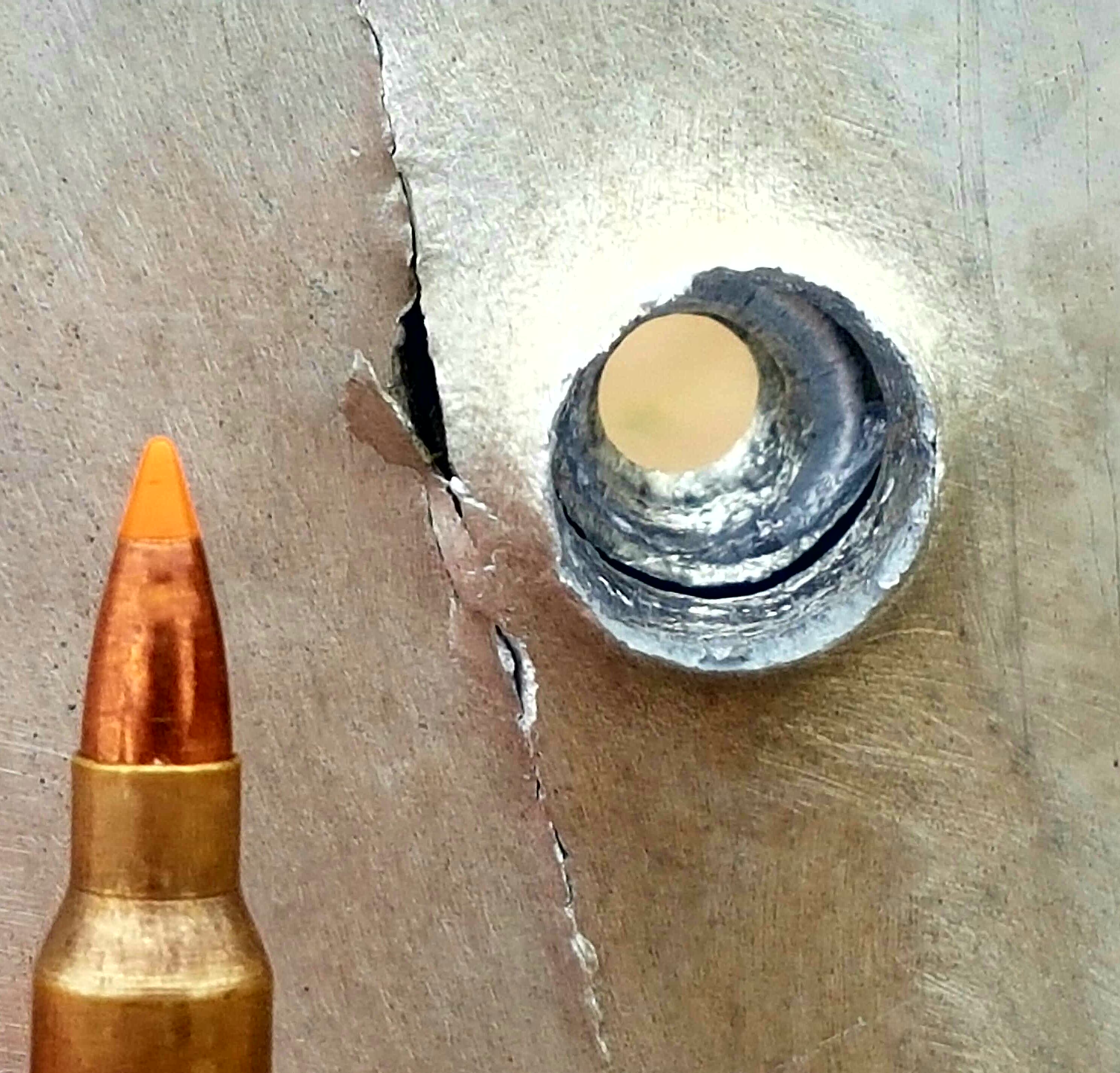

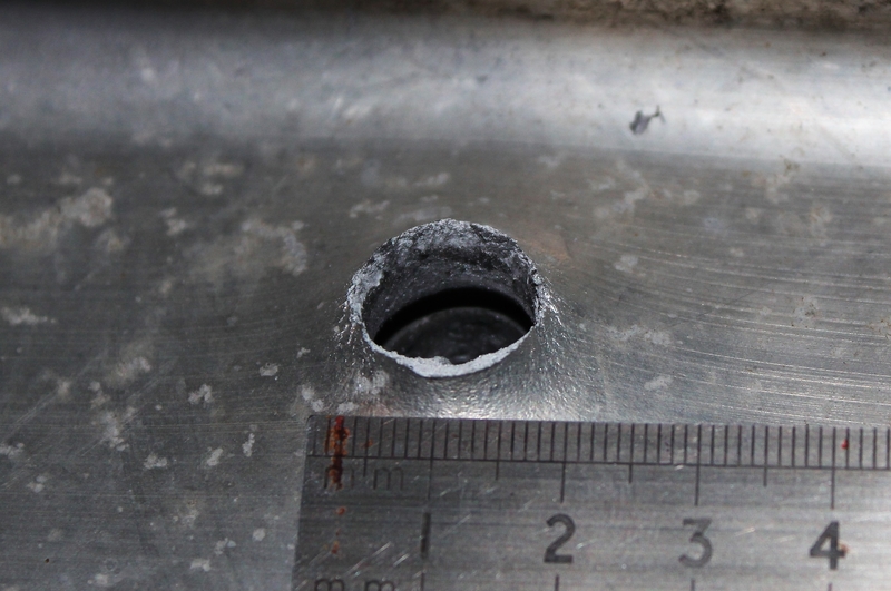

Post by Gaznazdiak » 21 Jul 2017, 4:36 pm

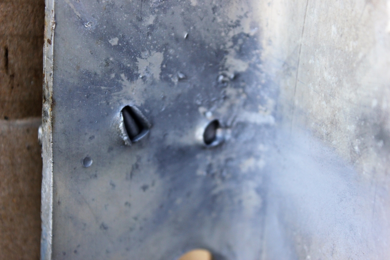

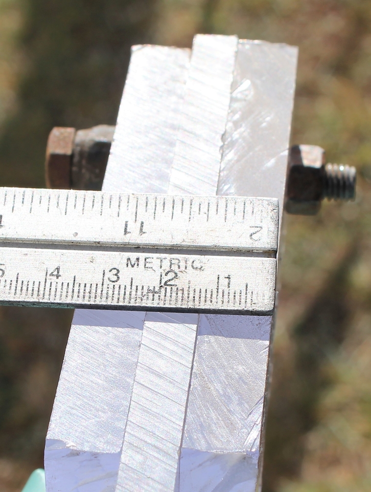

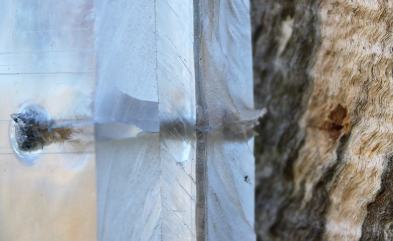

For anyone still interested in the SS109
I thought of a different way to test/prove straightshooter's statement about the purpose of the steel half of the SS109 core being to destabilize and veer off path without messing with gel and video etc by using "bullet resistant" polycarbonate.
The fist pic is a Winchester .22 PowerPoint at 100m on one 9mm sheet.
Even in the process of disintegrating the Nosler 50gr ballistic tip projectile's path was straight. The last pic says all that remains to be said on the subject.
Straightshooter knows his sh*t.
Win.22 PowerPoint100m.jpg (476.6 KiB) Viewed 12679 times
Nosler 50gr 1st layer entry.jpg (280.79 KiB) Viewed 12679 times
Nosler 50gr second layer exit.jpg (501.89 KiB) Viewed 12679 times
Nosler 50gr 3rd layer entry.jpg (596.3 KiB) Viewed 12679 times
Nosler 50gr 3rd layer exit.jpg (488.14 KiB) Viewed 12679 times
Nosler 50gr remains.jpg (630.83 KiB) Viewed 12679 times
Nosler 50gr effect on target.jpg (436.07 KiB) Viewed 12679 times
SS109 entry 1st layer.jpg (265.3 KiB) Viewed 12679 times
SS109 path side.jpg (285.36 KiB) Viewed 12679 times
