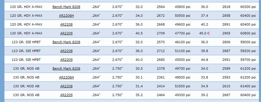

I am looking to reload Nosler Custom Competition 123 gr projectile using AR2206H for 6.5 Creedmoor.
The ADI handbook does not list 123 gr and the next closest bullet listed is 130 gr. The starting load listed for that bullet is 30.1 gr and the max load is 33.8 gr.
Nosler's load data for their 123 gr Custom Competition projectile using IMR 4895 (which is apparently an equivalent powder) is, starting load 35 gr and the max load is 39 gr.
That's a very big difference for an equivalent powder.
Anyone got any ideas on a safe starting load using AR2206H? I'm also open to trying AR2208 if anyone has any real world experience with that powder for a 6.5 CM.

Don't have any real-world experience with the 6.5mm Creedmoor, but I am used to seeing discrepancies in ADI's numbers :-)
They list the 120gn at 34.0-37.4gn and the 130gn at 30.1-33.8gn of AR2206H.
I would load five up at about 35.5gn to 36.0gn and work up to pressure signs.
AR2209 looks like a good choice in the 6.5mm Creedmore - compressed loads in almost all bullet weights. You can't fill a case better than that. But 20% more expensive to run than AR2206H.

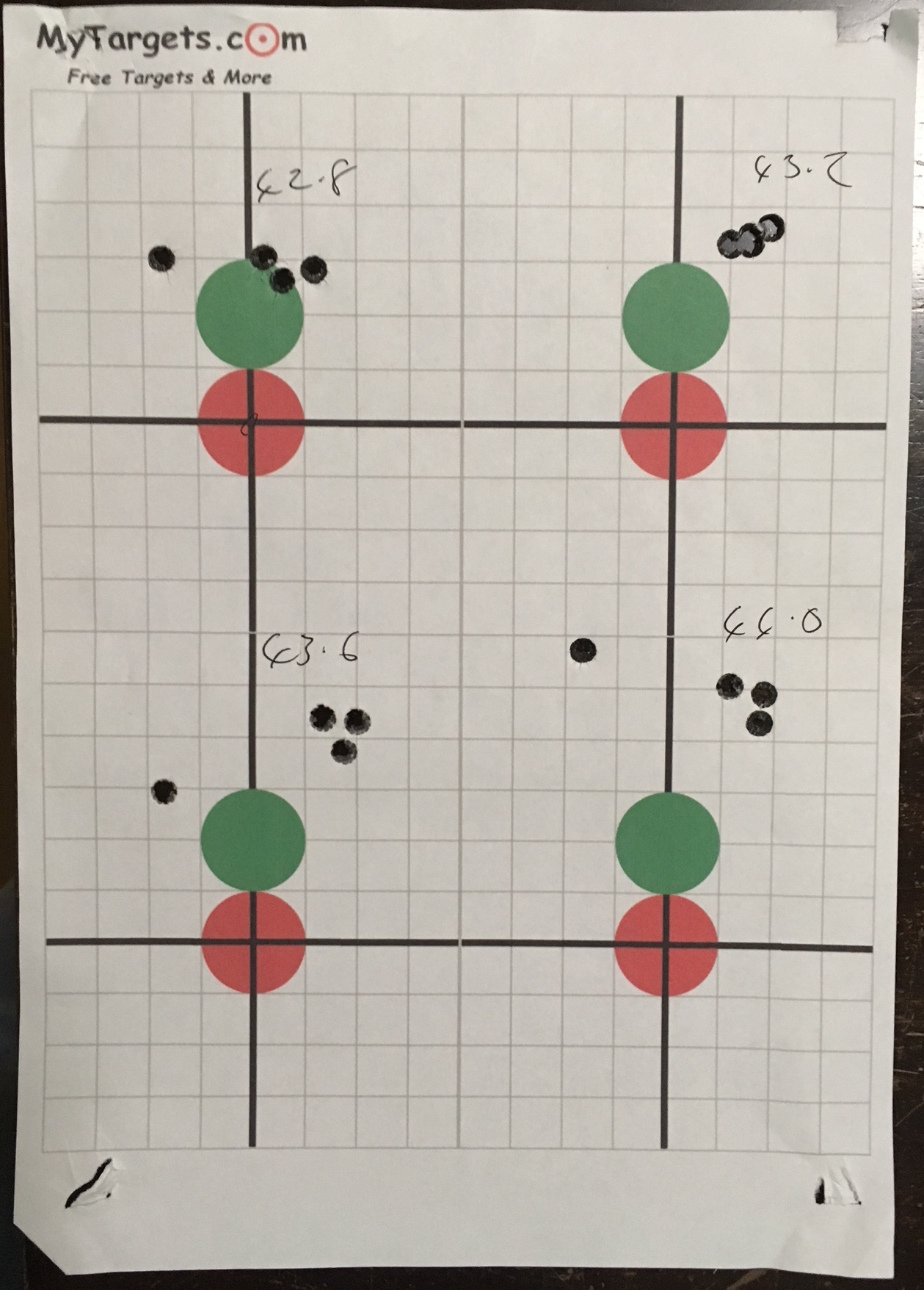

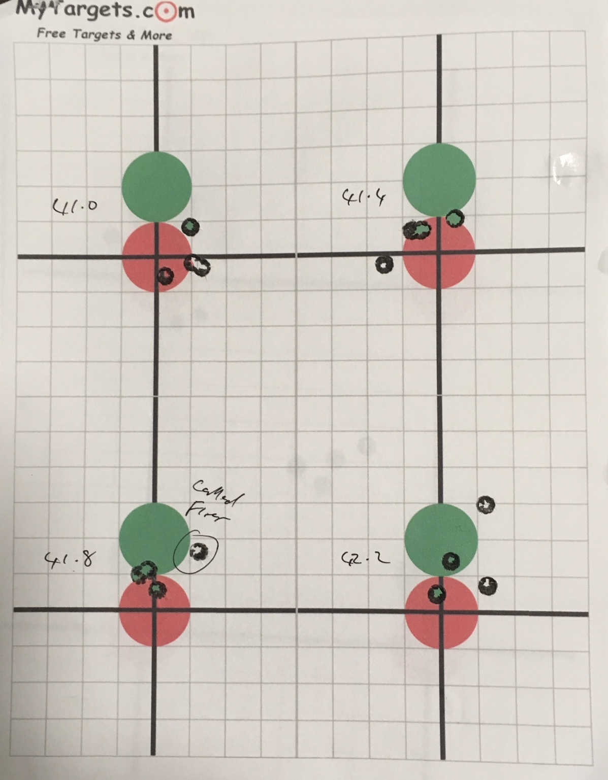

Here you go mate. I tried the 143gr ELD-X in my 24.4" Sako A7 Creedmoor today and had best results with 41.8gr of 2209. That was with Lapua brass and CCI BR4 primers. Second shot was a called flier, so I'll probably go back and revist 41.4, 41.6 and 41.8. 42.2 started to spread. No pressure signs with any of these loads, and they were all sub-MOA apart from the 42.2 load.
Incidentally, Hornady's published load with the 140gr A-max is 41.5gr of 2209, so they were obviously on the money.
Last week I also tried the 123gr Lapua Scenars and had my best group with 43.2gr of 2209. All 4-shot groups.
