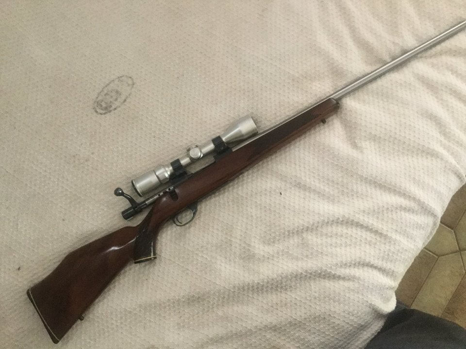

HI all,
just picked up a CMC mounteneer in .223 with a new 23" stainless barrel.
looking to get some reloading going for it but need to start somewhere so I thought I would ask some people that have already done it.
Already reloading for 30-30, 308W, 44mag,44-40 303 and 762x54r so i have 2205, 2207 and 2208 on hand.
I will be shooting paper at mainly 200m with some plinking out to 600m Any help that I could get would be greatly appreciated

Do you know the twist rate of the barrel?

That scope looks a lot like the one that came with my new .222 Ruger.Is it 6x40???

Post by fredhamish » 24 Aug 2017, 9:34 pm
Hi bladeracer, Don't know the twist rate yet but will do some measuring out at the range tomorrow.
The scope is a 3-9x42 bushnell

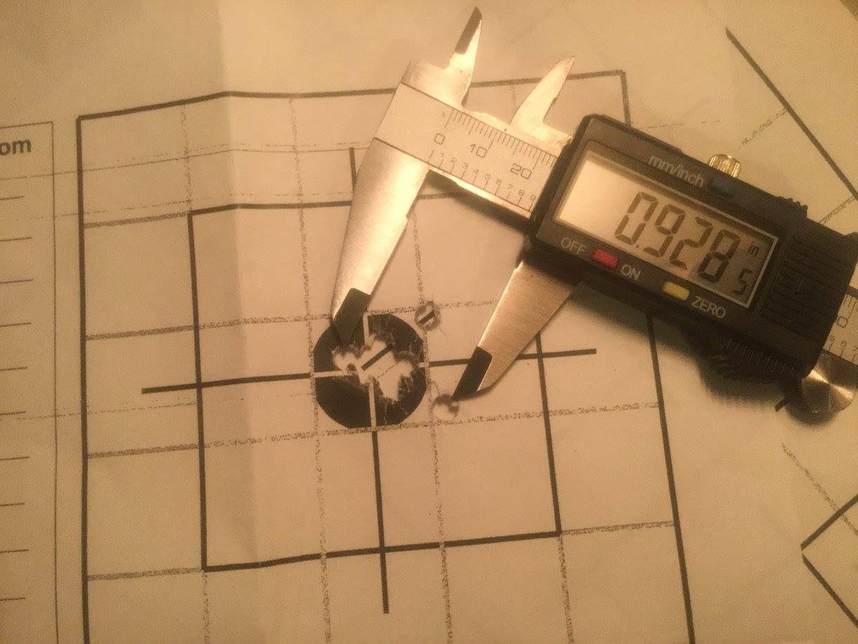

Post by fredhamish » 01 Sep 2017, 4:34 pm
[i]I've Chonographed my 223 firing OSA Blitzkings at 3250 fps and my reloads as mentioned above @ 3220 fps, working out to about a half inch difference at 200m. if that helps ya...[/quote]
Thanks Ritka,
loaded the cases with some 55gn Hornady Varmint and 23gn of 2206h for starters but i think that will be my go to load from now on
!st pic
10 rounds 55gn Hornady Varmint at 100 meters. the first 2 were sighting in but even then
2nd pic
10 rounds 55gn buffalo river at 100 meters
55gn varmint.jpg (103.47 KiB) Viewed 4494 times
buffalo river.jpg (99.73 KiB) Viewed 4494 times

Re: .223 reloading Noob
Post by Rikta » 01 Sep 2017, 4:42 pm
[/quote]
fredhamish wrote:[i]I've Chonographed my 223 firing OSA Blitzkings at 3250 fps and my reloads as mentioned above @ 3220 fps, working out to about a half inch difference at 200m. if that helps ya...
Thanks Ritka,
!st pic
2nd pic
10 rounds 55gn buffalo river at 100 meters[/quote]
good to see it went well for ya man, yeah same result as I get... nicely done.
Post by fredhamish » 01 Sep 2017, 4:45 pm
I was most impressed with the grouping for a 2nd hand 223 with a fairly average scope
