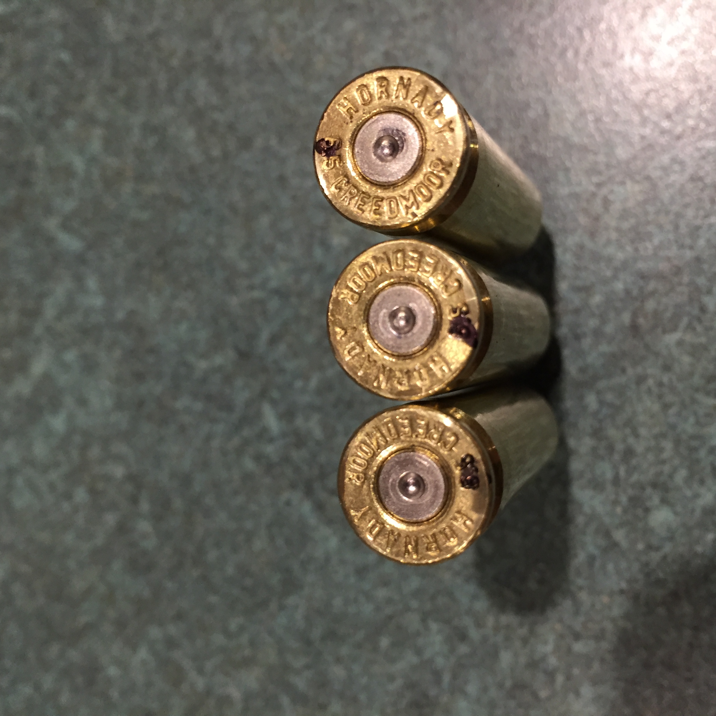

I fired 6 at 41gr here is 3 with a noticeable mark on the outside rim (extractor Mark?) doesn't look like the primers have backed out causing the problem. I put the black texta on the 6.5 to mark the cases which were fired with 41gr.
Also I should add. My initial case prep was just checking a couple of cases chambered ok. Them loaded them up. The cases fired at 41gr were fire formed and necked sized. The bolt seem to close fine. 3 had slight marks on outside rim. Two had noticeable stiff bolt lift. The other 3 seemed fine.

Post by Apollo » 03 Sep 2017, 7:26 pm
Top photo. Is that the extractor mark you speak of on the "A" in Hornady. ?? Might be my eyes but I can't see any on the bottom two. I have seen far worse from my experiments with a .243W testing Winchester Powder at a maximum load on a very hot day, not very accurate compared to lesser loads so from memory it was only 3-4 rounds tested. Cases where then FLS as they measured expansion just in front of the case head. I haven't used that Winchester Powder again since going back to AR2209 for the heavier bullets and AR2208 for lighter.
They looked like your top case where I think I can see a distinctive mark / ridge also, below the case head. That's what I would be measuring with my Micrometer to see if it is in fact an expansion mark. After many firings, like 6-10 reloads, a lot of my cases have the same mark but the diameter has not changed since the first firing where from memory they increased by 0.0005-0.001". I also use an Endoscope to check the insides of old cases after they have had a good internal clean.
From the photo, but hard to tell, the Primers don't look to have backed out. It was just a thought of something that might have made the bolt opening a little tight.
I would also have compared the case lengths from the Bases to the Shoulder Datum Point using a Cartridge Headspace Gauge between them all, including if possible an unfired case.
How far does the Carbon Track come back along the Necks, even perhaps Shoulder of the cases.
Also, I'd give the Chamber a thorough clean with a Chamber Mop and a slight touch of Solvent.

Carbon track is just or neck. Nothing on shoulder. The gun has a grand total of 37 shots through it now. I like the idea chamber mop and solvent. Just thinking there may have some residual oil from new that got on the case. The bolt was literally swimming in oil from new.
The case on right has what I call a extractor Mark? Above the the A in Hornady. The two other case has a shinning spot at the 6.5 which has been marked in Texta. Sorry not the best pictures I know. Thanks
