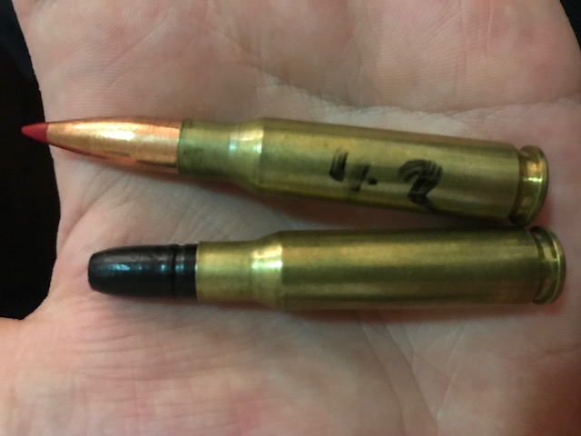

Ok good to know, I also found this: "The pressure required to swage bullets down from 0.310" to 0.308" is only a couple hundred PSI or so. In a .308 Win, where pressures are around 60,000+ PSI, this pressure is inconsequential" - and considering my 10gr TB loads will only cause around 30,000psi, there shouldn't be any pressure risks.
For the record, here's a happy-snap of my prototype bullet next to a 178gr ELD-X:
Re: is a .310" cast-lead projectile in a 308 bolt-gun safe?
Post by BRNO_Bigot » 12 Oct 2017, 2:12 pm
Yea, I wouldn't be loading lead bullets to 60,000 PSI eaither.
I would have absolutely zero qualms about loading them up with a TB.
Let us know how your experiments go.
