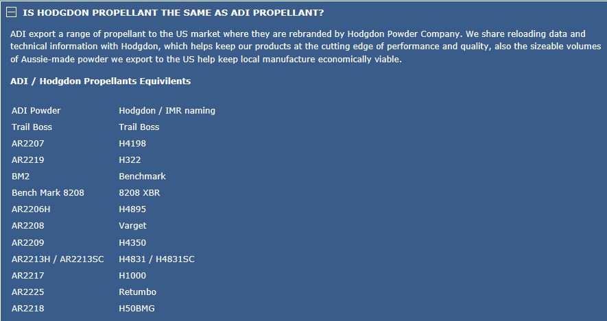

Post by MalleeFarmer » 24 Oct 2017, 6:16 pm
Dunno :unknown: if its on here yet but thought it could be handy for anyone thats got US reloading manuals to reference ADI-Hodgdon powders. :thumbsup:

Post by No1Mk3 » 24 Oct 2017, 6:59 pm
I think it was posted somewhere, but it never hurts to put it up again for those who have missed it. AP50N is the same rate as Hodgdon HP-38 which is re-branded W231, as AR2206 is the same as Hodgdon BLC2, which is re-branded Olin 846. Cheers.

Post by Apollo » 24 Oct 2017, 7:37 pm
Be a little careful. The same rate doesn't mean it's the same powder.
As far as I remember ADI AR2206 was never available in the USA and has not been manufactured for some years. BLC2 is not an ADI Powder, it's made by St Marks Powder Company and it is a "double based" powder.
ADI Rifle Powders are "Single Based".
One missing from the list is ADI Bench Mark 8208 which was available in the USA way before it was released by ADI for Australia.
The "Rebranded" list I'm pretty sure is available on both ADI & Hodgdon sites.

Post by brett1868 » 24 Oct 2017, 9:52 pm
From the FAQ section of the ADI Site a few mins ago...

Post by No1Mk3 » 25 Oct 2017, 5:20 am
G'day Apollo,
You are quite right, one shouldn't take burn rates as being exactly the same, however my intent was that Hodgdons HP38 is listed by ADI as an appx. equivalent powder to AP50N, and HP38 is re-branded W231. The same with 2206, ADI list BLC2 as an equivalent powder, and BLC2 is re-branded Olin WC846, which as you say, is made by General Dynamics St Marks (formerly Olin Winchester St Marks), as are all Olin Winchester ball powders. Load development with recycled 846 shows the same velocity/pressure figures between it and 2206, so its equivalence was very good, sadly neither are available now. It would appear there are only 6 powder manufacturers making powder for the civilian market now, and half of them are French! (Or at least partly French owned) Cheers.

Post by Apollo » 27 Oct 2017, 7:36 pm
I think the whole aim of the Topic is not what is "equivalent" but what is "Exactly the Same Powder" and that is what is missing as a statement from the ADI Equivalent Chart.
What confuses a lot of those that reload and use USA based data didn't realise that those Hodgdon Powders were not an equivalent but the exact same powder that ADI manufacture under a different name. In all reality it would have made matters a whole lot more simple if Hodgdon just used the ADI Name... but no, they are Yanks and have to be different plus intimate it's their powder.
This topic has been going on for many years over any number of Forums. Way back when a lot didn't believe they were the same powders I sent Hodgdon an email asking if they could confirm the re-named powders, which they did and posted the reply a few times. Funny thing was a few still believed that they weren't the same powder. Some mothers do have strange kids... :-)

Post by MalleeFarmer » 27 Oct 2017, 11:09 pm
Ok Kids. Calm Down :thumbsup: topic is for those who may have American Reloading Manuals to give an easy chart to show Which hodgdon Powders “ARE AN AUSTRALIAN MADE ADI POWDER REBRANDED” so that load data can be compared and used as per the manual. this is not a post about burn rates but differing names for the same powders.

Post by Gamerancher » 28 Oct 2017, 8:03 am
Wow, talk about kicking the hornets nest. You're right MF, "same as" not "equivalent to". Maybe some folks need to read a dictionary. ;)
I contacted ADI some years ago before travelling to the U.S to compete at their Silhouette Nationals. As we were unable to carry enough ammo for the matches I needed to reload whilst there. I had always been told or had read about the "re-branded" ADI powders over there but needed to be absolutely sure. Your list is completely accurate and is the same as what they ( ADI ) told me.
