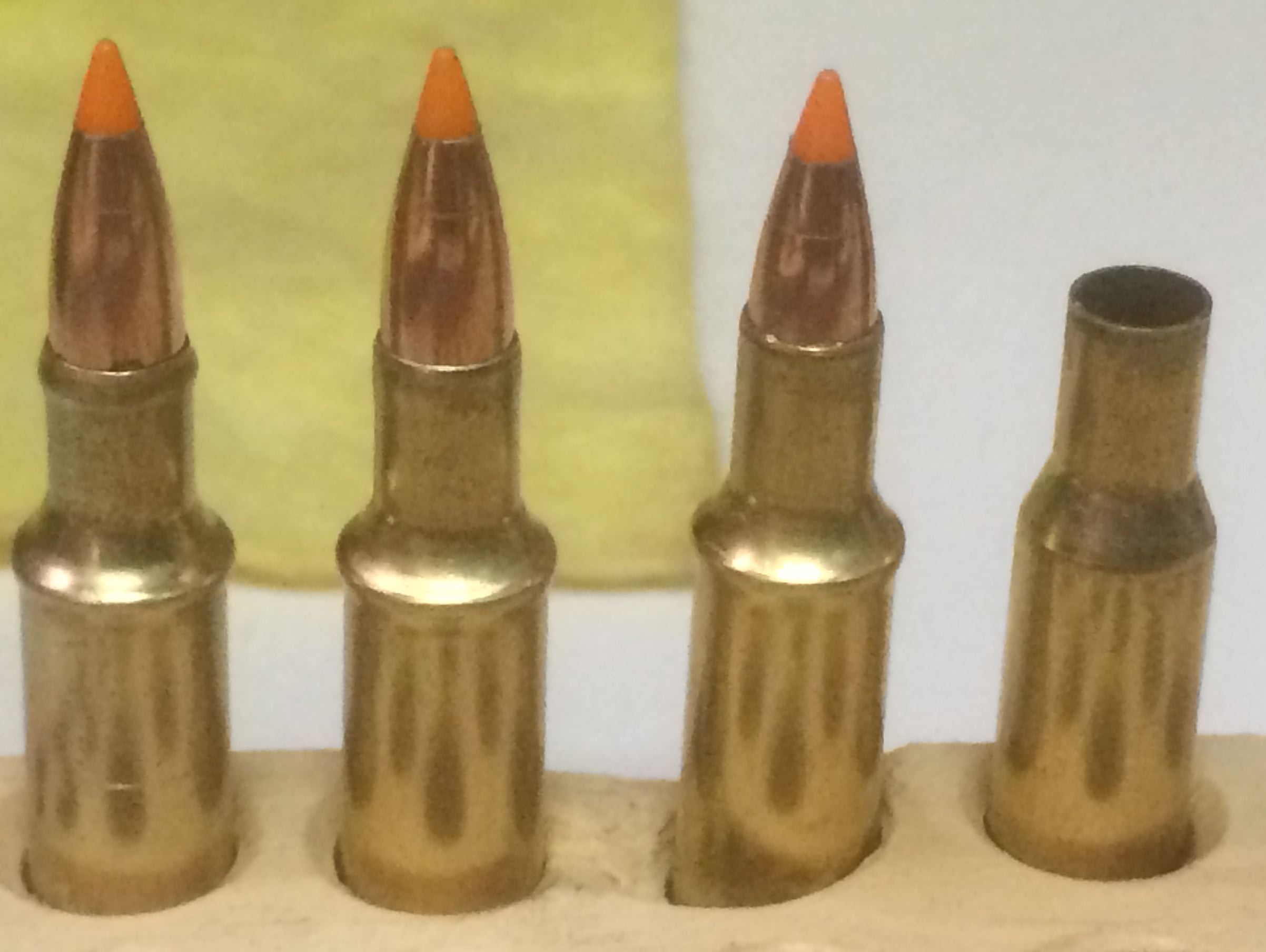

Hi Guys, I need help.
I am attempting my first reloading effort.
I am seating the projectile and I can't seem to get it to work.
I believe I have set the die to the correct hight.
Maybe the die is stuffed or I am just stupid as I can't figure it out.
Stuff up2.jpg (197.35 KiB) Viewed 6164 times

Hey mate,
You've got the seating die to set too low for sure.
Process should be something along the lines of:
1) No die inserted in press.
2) Put empty brass in press.
3) Raise press fully.
4) Screw seating die in until it touches empty brass.
5) Screw seating die out 3/4 of a turn.
6) Secure seating die at that height.
Then you should be good to go.

SendIt wrote:You've got the seating die to set too low for sure.
IMO this is it too.
I did the exact same thing once, with the exact same result you've posted pictures of.
Like Sendit said, you turn the die out 3/4 (or however far your brand recommends) to life the die off the bras.
If you wanted to crimp your loads, you would do the same process as above except after you lower the die onto the brass, you would lower the press and turn it in a quarter turn. Just low enough to crimp 1mm of the brass.
You look like you've got it 3-4mm too low.

Forgot to say, see how the tops of the neck curl into the bullet?
Definitely crimping issue from low seating die. You're squashing the whole brass down via the neck.

Check also, you die will have two basic parts.
The body which is what's crimping the brass, and the adjustable rod which is seating the bullets.
Best to wind the bullet seating rod out a bit when setting the die for the first time too just in case it's contacting the brass.

Post by Muddy1967 » 20 Dec 2013, 5:57 pm
Wahoo!!!! :mrgreen:
Success,
Thanks SendIt all fixed, you were correct it was user error :oops:
Thanks for the great fast advise.
