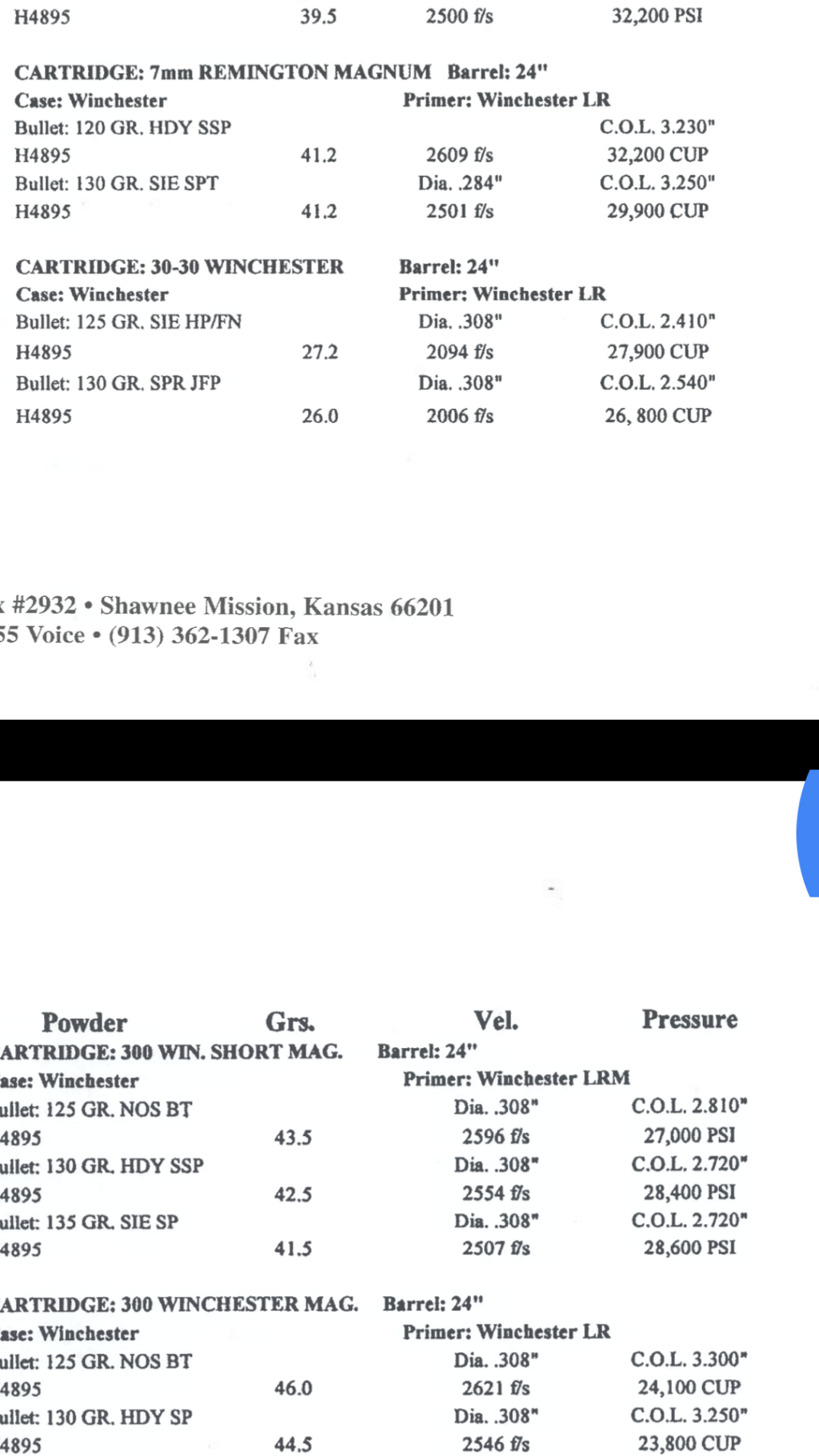

Post by Cherza » 01 Dec 2017, 2:23 am
Found this regarding safety is this ok or not?
Was thinking about something like this
Cherza
Posts: 37
Re: 7mm rem mag light loads
Post by Gamerancher » 01 Dec 2017, 8:10 am
That is basically a load that you would use in a 7-08. H4895 is the same as AR2206H. I use a similar load in a .35 Winchester which has a slightly smaller case capacity than your 7mm Rem Mag. It is a very mild load behind a 130gr bullet in 7mm-08.
Post by Cherza » 01 Dec 2017, 8:56 am
So 41.2 grains will that only half fill the case with powder?
Cherza
Posts: 37
Post by Gamerancher » 01 Dec 2017, 9:48 am
Dunno, weigh out a load and put it in a case. See where it fills the case to. I don't have a 7mm RM case to see for myself.
