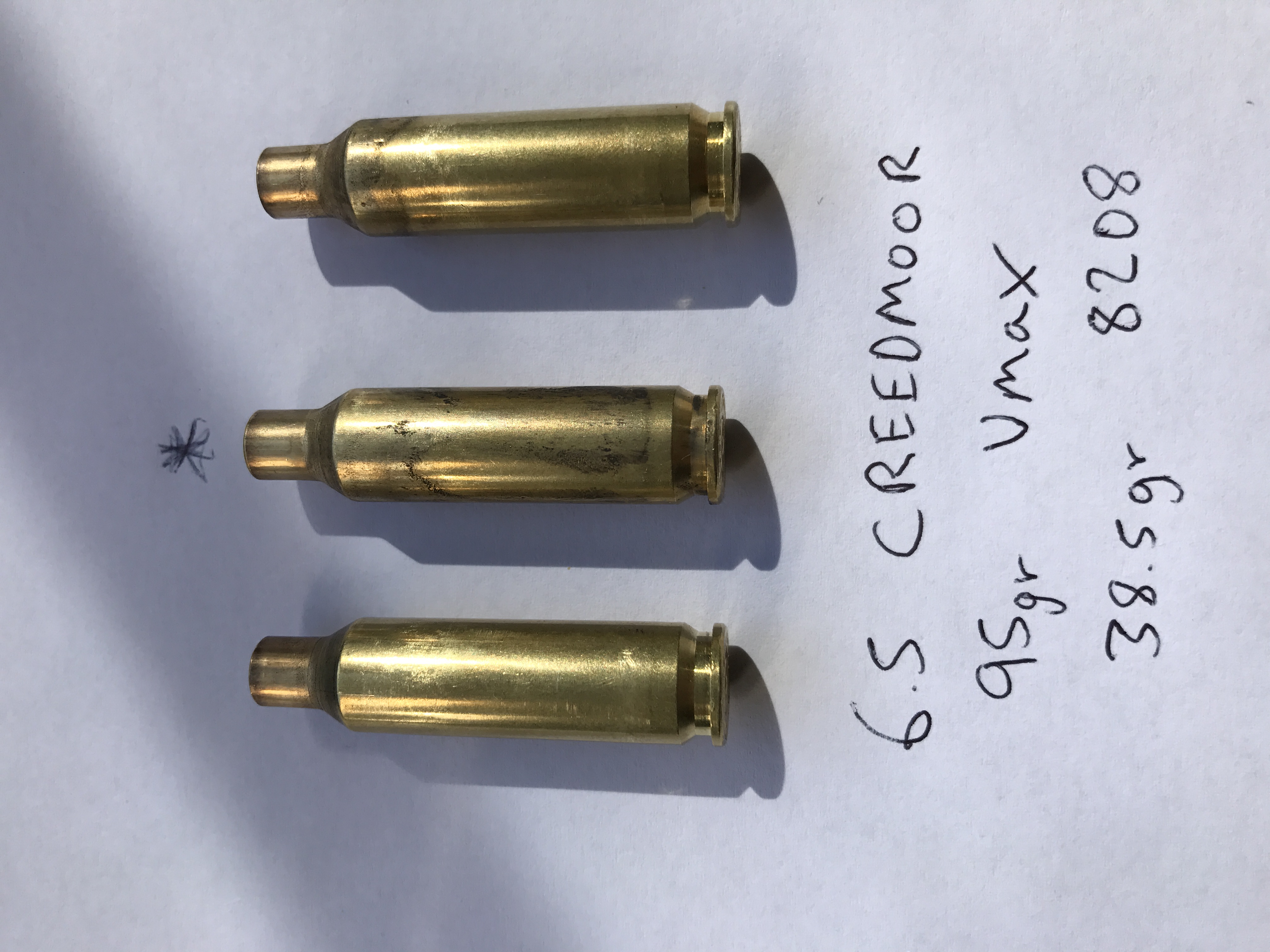

Trying to work up a 95gr vmax load in my 6.5 Creedmoor. Started with 38gr of Ar2206H. Brass is Hornady which has been full length sized and tumbled clean in stainless steel pin media tumbler so we're nice and shiny.
I fire 3 round at 38gr ar2206H and noticed abit of soot going back past the shoulder. Which I don't normally see... read that problem might be that powder might be a bit slow.
Tried Benchmark 8208 at 38.5gr and first case looked normal. Second case had a bit of carbon soot going back the length of case and even a bit of carbon around rim? 3rd case had a bit of carbon back past the shoulder like the AR2206H loads.
Thinking I'll try increasing the loads abit and maybe the problem will go away one brass is fire formed?
Maybe the Lee Full length die has undersized the cases???
Dunno?
Happy for any input. Thanks
Cooper

Loads are in the middle of the range for that combination of powder / projectile which is a good start. What's the neck wall thickness? as it looks to have been neck turned. Any chance of a picture showing how the primers look? I suspect the neck is a bit undersized in the chamber and not expanding fast enough to seal. Can you measure the neck of a fired case and again after sizing please.

Necks not turned. But after full length sizing I did put the them all through my neck bushing die with .289 bush. So that explains marks on neck.
I'll try just Lee Collet sizing the next batch. But whatever reason the necks are not expanding to the chamber with 95gr Vmax.?? Size after firing is like .290 still looks and feels like I could seat another projectile without neck sizing?
I checked my Lapua case which have expanded to .295 fired 143eldx and some other Hornady case which I fired 140gr projectiles and they have expanded to .294/.295
The Hornady brass is on its 4th firing. I'm thinking that now brass is fire firmed slightly. The neck might expand properly on the next firing? Maybe the Hornady brass is a bit stiff (might need necks annealed?)
Thanks for suggesting to measure the necks Brett. I was just thinking it was just a powder to projectile choice problem.
Cooper

Soot down around the neck/ shoulder is usually a good indication of a too light load for that particular combination, personally think you might do better with 2208 :thumbsup:

Post by Apollo » 24 Jan 2018, 11:00 pm
Well, to me I can't see any Carbon Soot at all. What I can see is dirt on the case or left over lube that's been overheated.
The photo's are from the wrong angle. Carbon soot starts at the neck and after been freshly fired will wipe off.

Apollo wrote:Well, to me I can't see any Carbon Soot at all. What I can see is dirt on the case or left over lube that's been overheated.
I think I'll clean my chamber. But I think you might be right about case lube. I've just stared using Imperial wax. But I have been using hardly any. Just a little bit on neck when using bushing die. Looks like somehow I've got some (more that I thought) left on the case. The stuff on the case did look a greasy. My bad. Thanks

usually carbon down the neck or lower is because of a light load with thick necks,
the neck is not expanding quick enough and the gases/flames are getting under the neck before the case fits the chamber
as you increase the load the carbon will rise up the neck
its not a good thing to have it down past the shoulder especially if you get deformed bumps in the case, can be dangerous
just put in more powder and see it go away :thumbsup:
