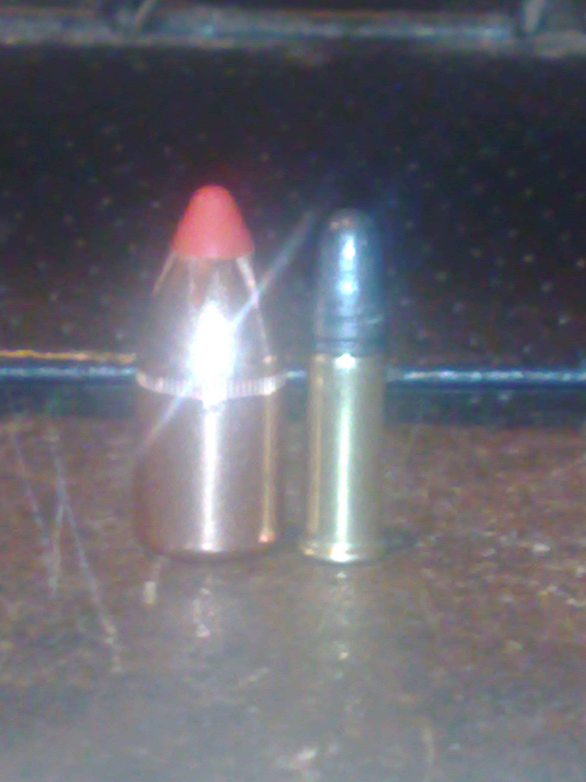

The 265gn FTX seated to the crimp groove is too long to feed through the tube though, and seating it to the groove already takes up a lot of case capacity. I don't have any FTX's loaded currently but they'd be roughly 1.800" overall. The bullet is 40-thou longer than a .22LR cartridge.
