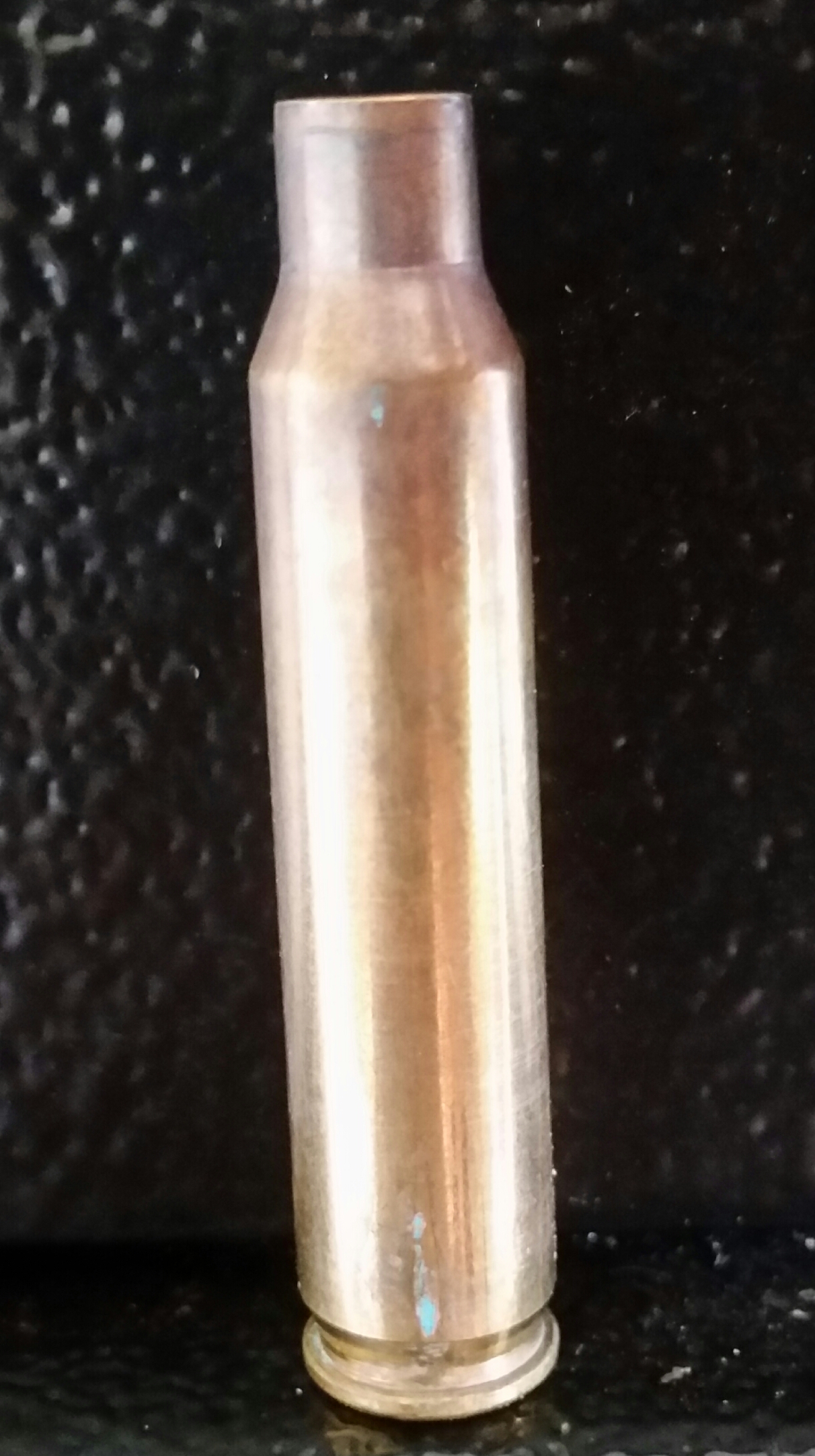

Post by Kelsey Cooter » 03 Feb 2018, 5:37 pm
hopefully this pic is clear enough to show

Thats very different to what I was describing. Mine was just a slightly different colour not shiny all over. That looks like some sort of salt stuck on or is it pitted?

Post by Oldbloke » 03 Feb 2018, 5:48 pm
I assume it's the green bit.
Mmmmm... Perhaps copper oxide? Certainly a sign of corrosion.
Just in future more rinsing in fresh water and the bicarb.
Wipe it off, should be fine.
Edit: m
Maybe a bit of electrolysis happening.

Post by Apollo » 03 Feb 2018, 5:57 pm
That looks like some residue left from whatever water was used or maybe too much Bicarb which only needs to be a small pinch in say 500ml water. Maybe the water quality if not using rainwater.
Try wiping it with a clean rag with say just a drop of gun oil on it otherwise just a clean moist rag and dry it with a rag.
I rinse all my cases with rainwater as a last step irrespective of what process I use then put them out in the sun for the day or if winter they go on top of the wood heater for awhile. Failing that in the fan forced oven at about 110 degrees for an hour or so. Don't think any of mine touch each other when drying. The metal plate I use does get some marks from the case head, never really bother looking at all the head bases as they go into the tumbler as soon as they are dry.

Post by Kelsey Cooter » 03 Feb 2018, 7:33 pm
Apollo wrote:That looks like some residue left from whatever water was used or maybe too much Bicarb which only needs to be a small pinch in say 500ml water. Maybe the water quality if not using rainwater.
Ok sounds like I used way to much bicarb, I used more like half a teaspoon in 500ml of water

Post by Apollo » 03 Feb 2018, 8:11 pm
For a flush the mixture is 1 grain of Bicarb per Ounce of Water. 500 Ml = 17.6ozs so 18 grains of Bicarb. Not much when you see it on a set of scales.
Hope this helps....
http://www.accurateshooter.com/technica ... -cleaning/
I use the "Clean n Shiny" mixture. They come out great. I do not use Hot Water just cold tank water.

Post by Strikey » 03 Feb 2018, 8:55 pm
Kelsey Cooter wrote:hopefully this pic is clear enough to show
That green/blue mark is what I believe is called verdigris, water and salts reacting with the copper in the brass, have a look at the copper pipes on your hot water system and you will see it there, just wipe it off, it will probably leave a mark on the case but it will be okay to load and shoot :thumbsup:
